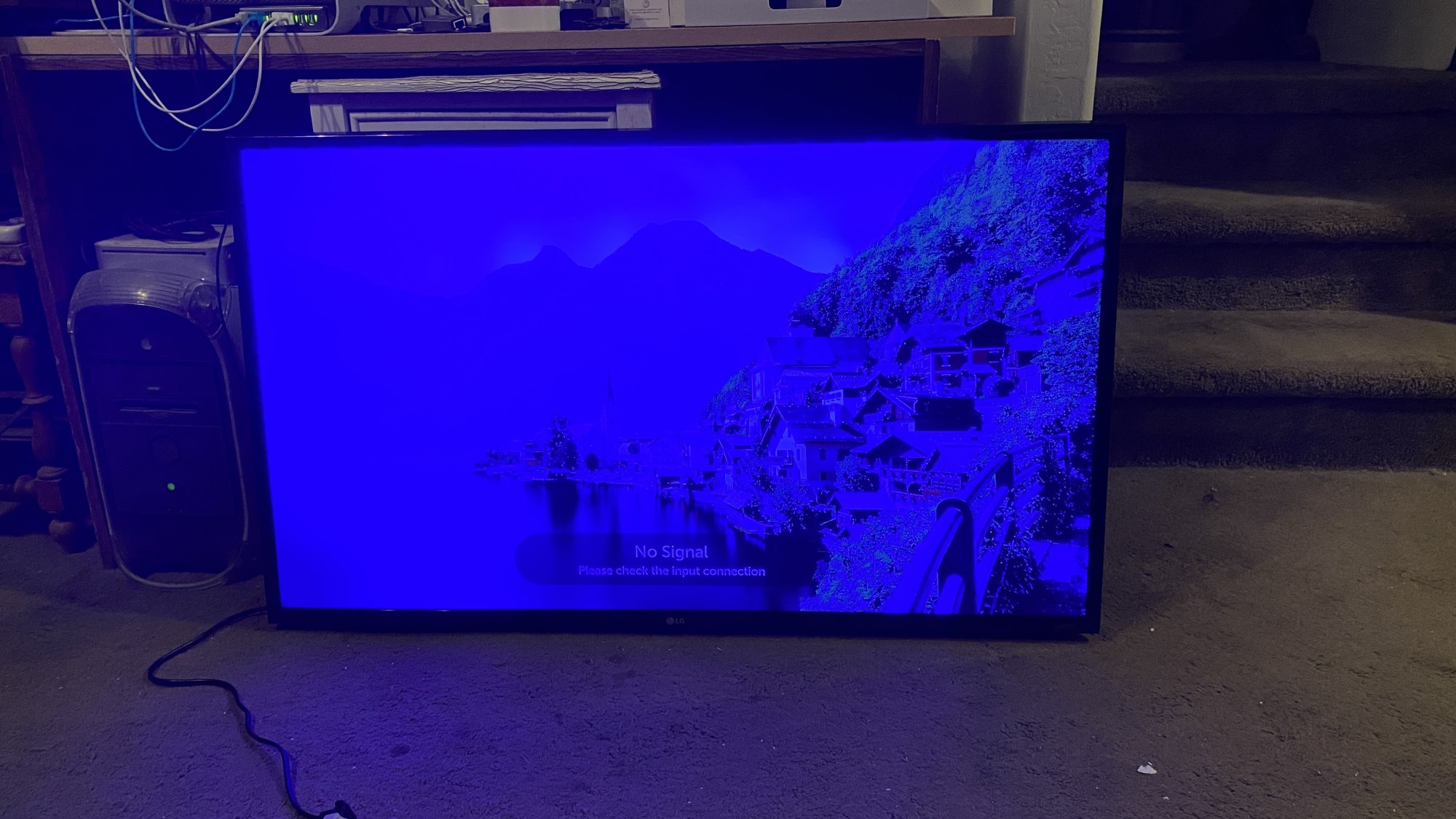

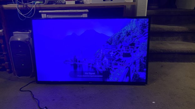

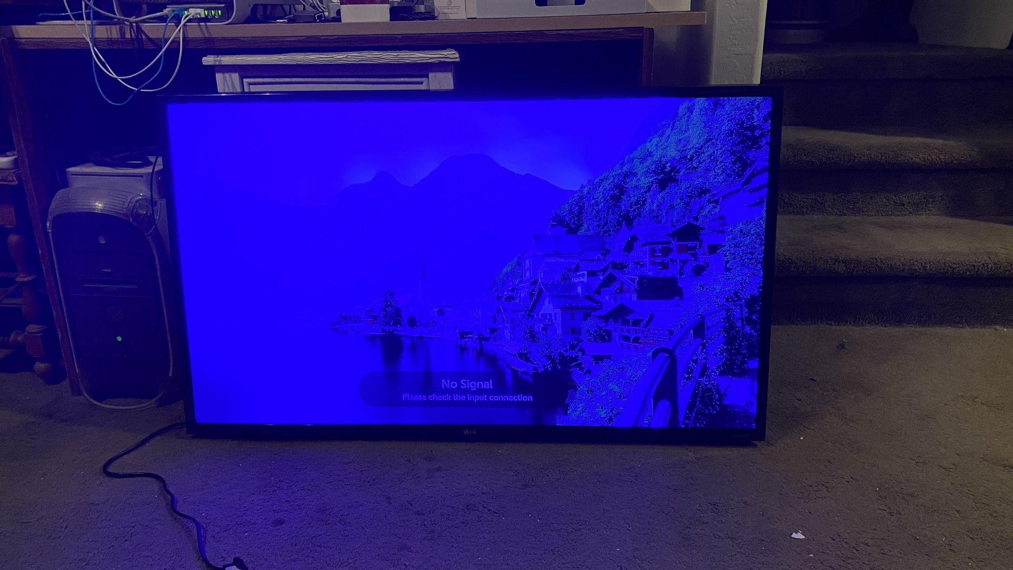

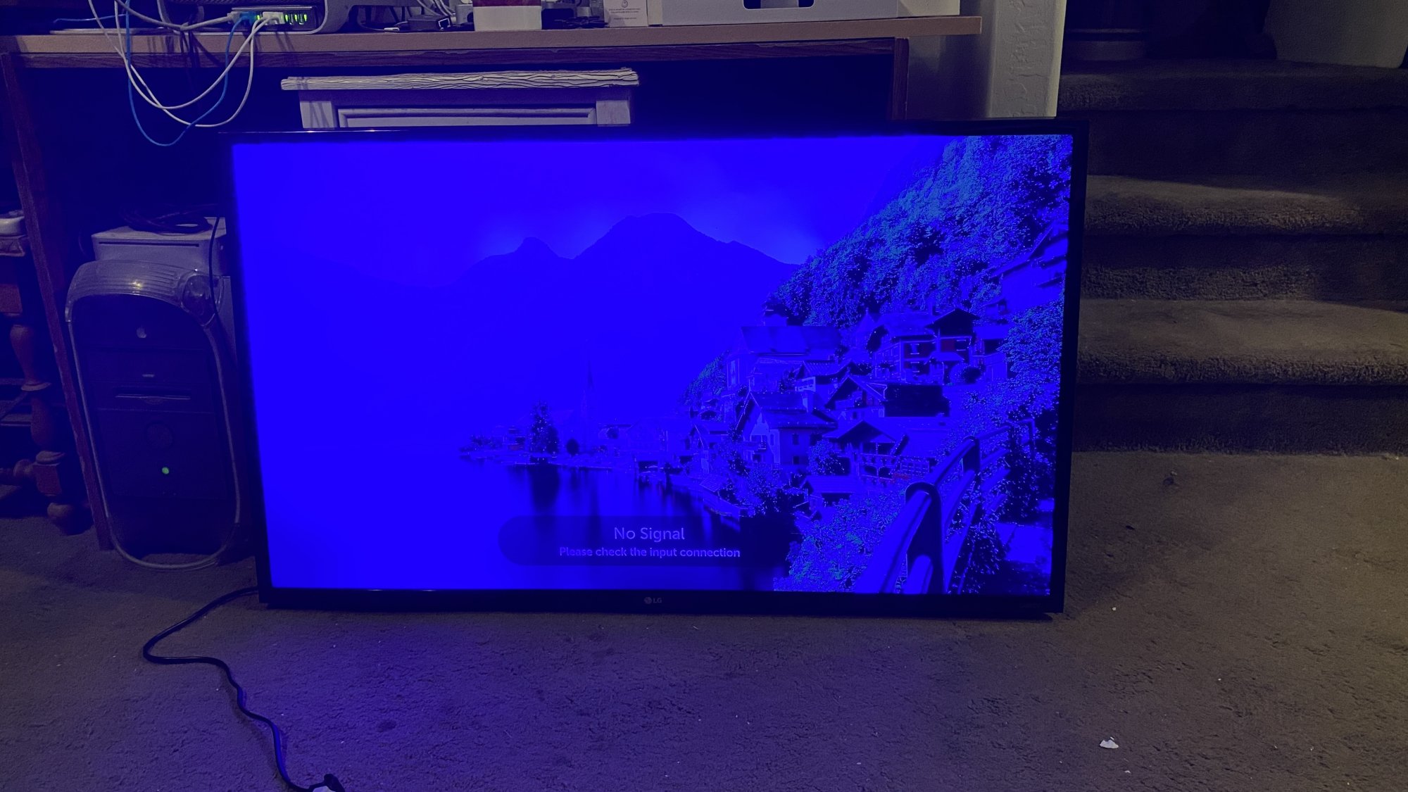

Goodwill, 43" LG HDTV, which is UHD (3840x2160). That makes this TV the same resolution as the 55" HDTV hanging on my wall. On top of that, it's a smart TV so it has an ethernet port. Not sure how I'm going to leverage that as I'm already using an Amazon Firestick in my 55".
Anyway, cost me $20. The image has it with a blue cast, but I'm fairly sure that can be cleaned up. It looks worse in the picture than in real life. I also ordered a remote off of Amazon for $10 as there seems to be no physical controls other than a power button. Will be here tomorrow.
The new HDTV has no stand (it was wall mounted) so will have to work around that as well (but not a big deal I think). My problem is arrangement.
Still, better to have this problem.
PS. I think I'm done with 23" Cinema Displays, but don't quote me on that. 😀
PPS. New HDTV is model 43UH6100.
Congrats on the bargain! The blue cast might be due to the picture settings requiring adjustment with a remote. Fingers crossed. 🙂

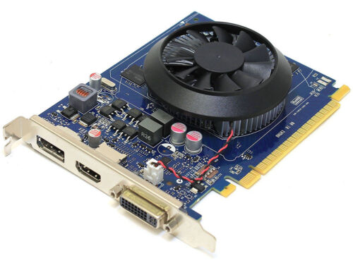

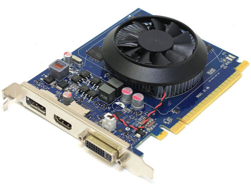

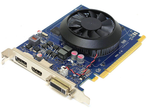

Well, it's two of these: Nvidia GeForce GT 640
Right now I have one 30" Cinema Display attached to each card. So, one card has a 30" Cinema Display and the 55" HDTV and a 23" Cinema Display. The other card has a 30" Cinema Display, a 23" Cinema Display and a 20" Cinema Display. The 23" on that second card is hooked up via HDMI.
So, I'd just be swapping in the 43" TV for the 23" Cinema Display which would be using the same HDMI port. And both cards would have a 30" Cinema Display and HDTV to run, not just the one card as it is right now. Plus the other 23" and 20" Cinema Displays.

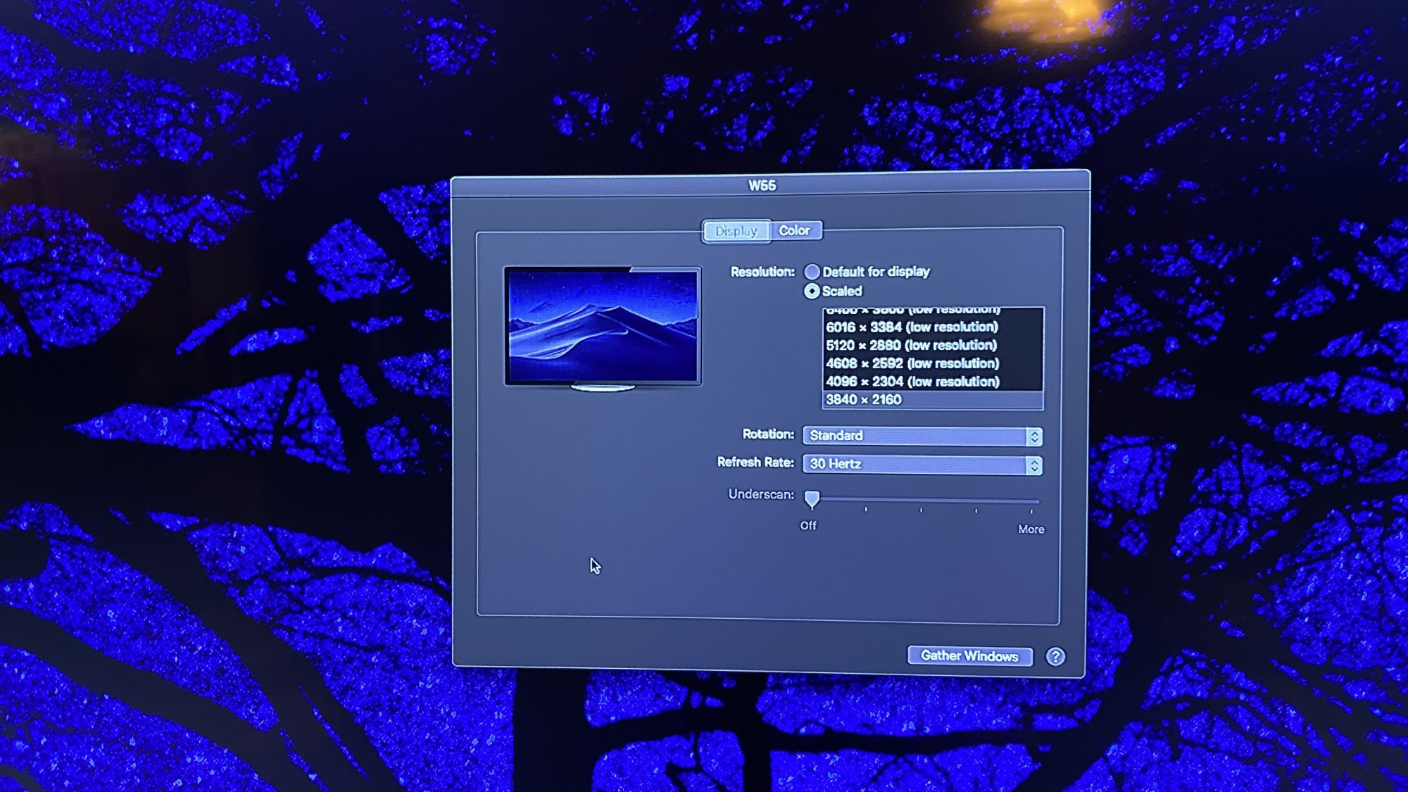

The currently supported 55" HDTV gives me no problems. It is at a 30mhz refresh rate, but it works. I mean, I put a browser window up there with YT videos (full size) all the time.

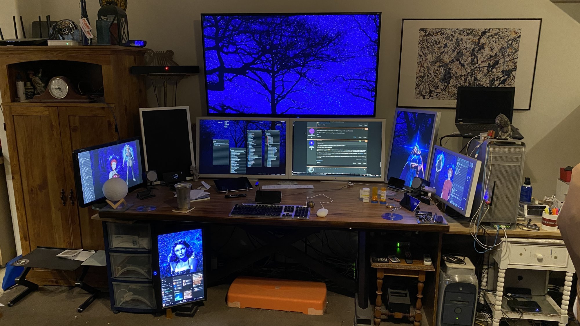

Note, you can see the dark 23" on the side there. It's supposed to be on.
PS. The 24" displays on the far left and the floor are using a DisplayLink device so they don't count in all this.
That means 30 Hz refresh rate.
Yeah, but this is not the same as using it for a main or even secondary display. Try dragging windows around or doing precise actions with the mouse in e.g. InDesign or Photoshop and see if 30 Hz refresh bothers you.
Ideally, you would hook up six displays like this to get 60 Hz on all of them:

So, remote showed up and I've reset the TV. I guess the blue cast is the reason the TV ended up at the Goodwill. That's okay. It'll serve fine as a much larger secondary display. And I have Blacklight which can apply a tint to the screen that hopefully will even out the blue. I use Blacklight to get rid of the yellow tint on one of my Cinema Displays so it works.
The TV has WiFi (connected now) and Ethernet so that's interesting. May be able to use it without a Firestick although why I need to run two TVs at once for TV programming I don't know right now.
