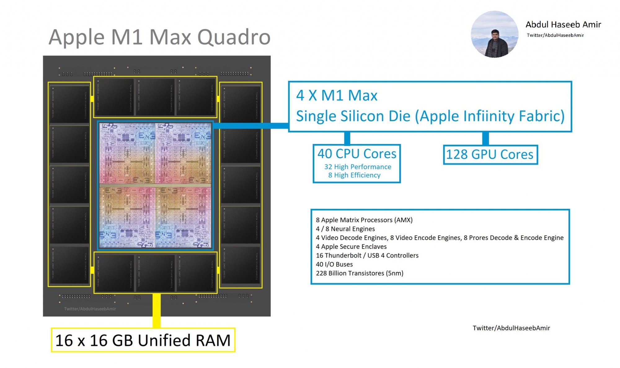

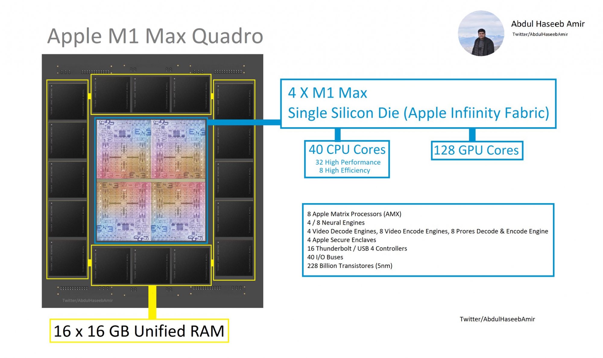

Mark Gurman leaked the entire M1 roadmap back in May 2021, though at the time he only knew the codenames, core counts and memory capacities:
  • JadeC-Chop, which became M1 Pro;
  • JadeC-Die, which became M1 Max;
  • Jade2C-Die, which became M1 Ultra;
  • Jade4C-Die, which will be two M1 Ultras in a "chiplet" or some other package.
I guess we can safely assume that Jade4C-Die is the Mac Pro.
The question now is if it supports expandability.
I guess we can safely assume that Jade4C-Die is IN Mac Pro.

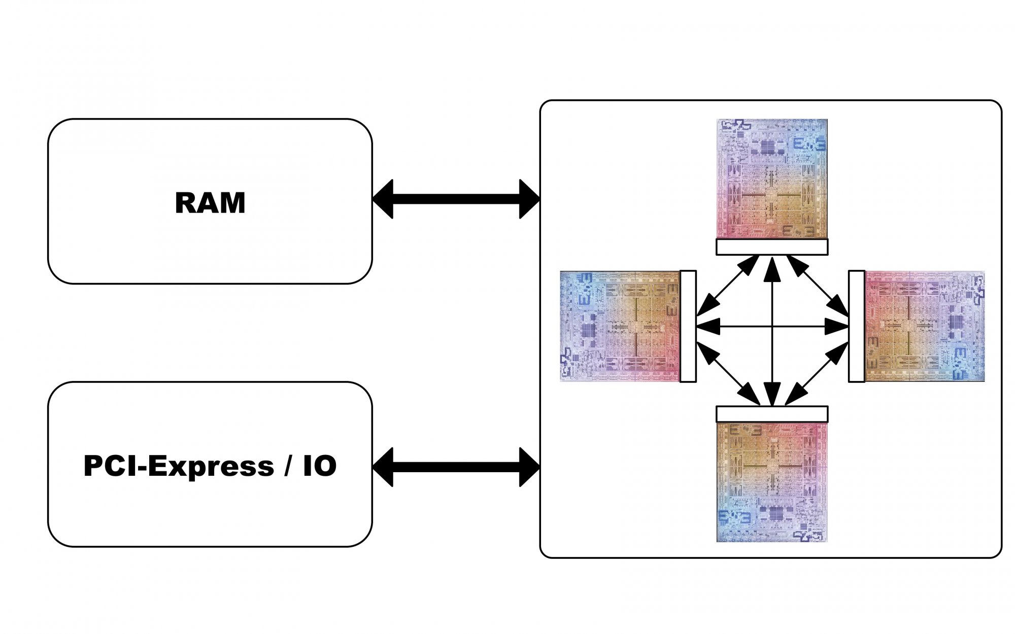

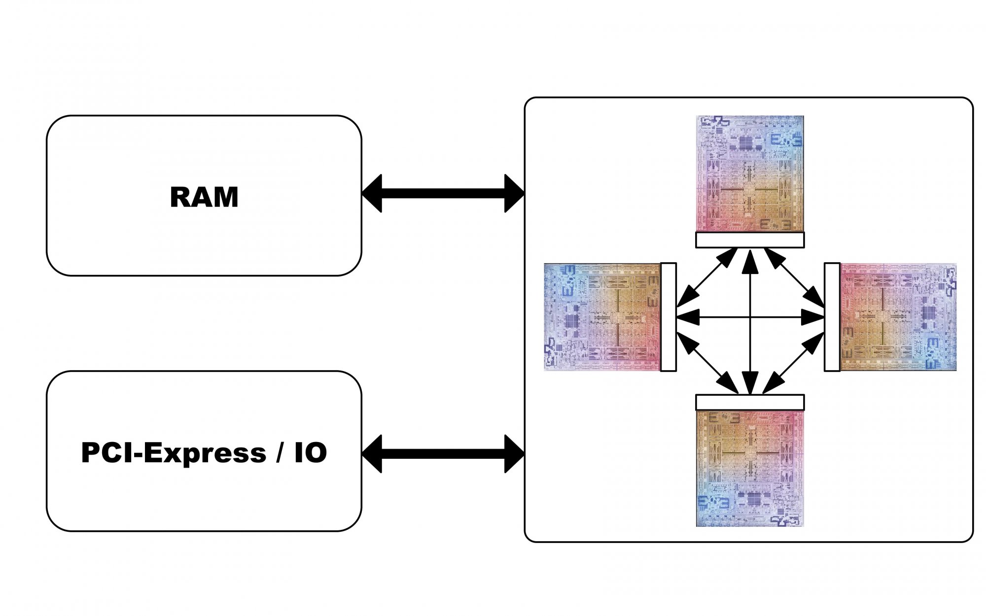

Apple could combine four M1 Max into a chiplet via a four-way hub using the built-in connectors. That would not contradict Ternius' statement and it would align with Gurman's "Jade4C-Die" codename just as "Jade2C-Die" turned out to be M1 Ultra.
There is one interconnect per m1 max chip. Thus the max that can be connected via the interconnect is 2. How would they have a 4 way connection?

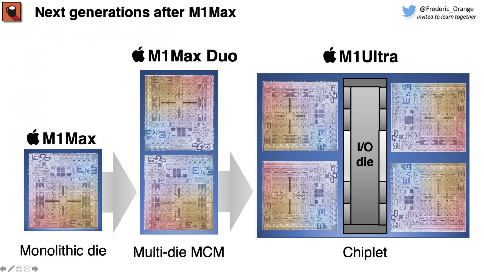

One option would be to have hub could have the same interconnect on each of its four sides. So the four Max connect to the four interconnects on the hub. The hub would then have logic necessary to allow allow the four Max to share everything between them.
Another option would be to have two M1 Ultra placed side-by-side with the interconnect extended between them via core logic.
The interposer pragmatically completes the connection. What is being proposed in some how the interposer splits up the bandwidth between the four ( instead of one target would need to go three ways in/out for each die. Take 10,000 connections and conceptually divide by 4. ) It is quite doubt that is just 5,000 pads "in" pipe and 5000 pad "out" pipe. Probably multiple channels bound up for the aggregate bandwidth number. Conceptually could send some of those channels off into a different die, What they would not have though would be a 2TB/s connection between the individual die pairs anymore. So probably could not do a "present GPU cores as one single GPU" solution.
As soon as the fractional inter die connection bandwidth allocation drops below the memory bandwidth you don't have a 'fat tree' network anymore.

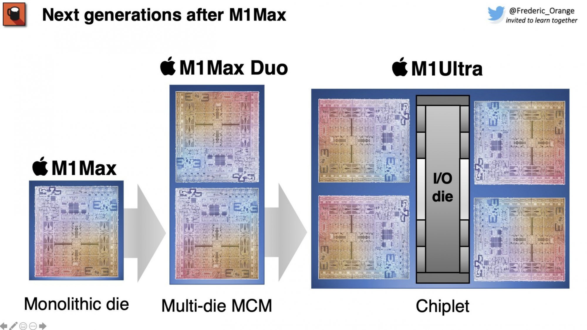

Yes theoretically they could’ve done it this way with just a single connection. But as @deconstruct60 and I pointed out it would likely necessitate a loss of their ability to present a unified GPU to the system … if they care about that for the Mac Pro product stack (and of course the lacking interrupt controller).
That I/O die hub is going to present as a NUMA interconnect. Going to be substantively harder to present as "One GPU". What AMD does with their I/O die is make all the cores accesses to memory slower equally. Apple can't really afford that with their GPU , display output processor(s) , and NPU bandwidth demands.
Apple uses an interposer so the "interfacing" die is layered beneath the M1 Max dies. It would have to be a pretty big interposer to lie underneath all four. Second problem is would have to fixed amount of bandwidth that would have to be divided up between the additional two dies to make it all completely seamless in all GPU latency contexts.
It is one thing to make it on uniformly addressable. It is another to smooth out all the latency hiccups that might spring up. Unless UltraFusion is only using 1/2 or 1/3 of its bandwidth to make two Max dies appear uniform, there is a scaling problem.
