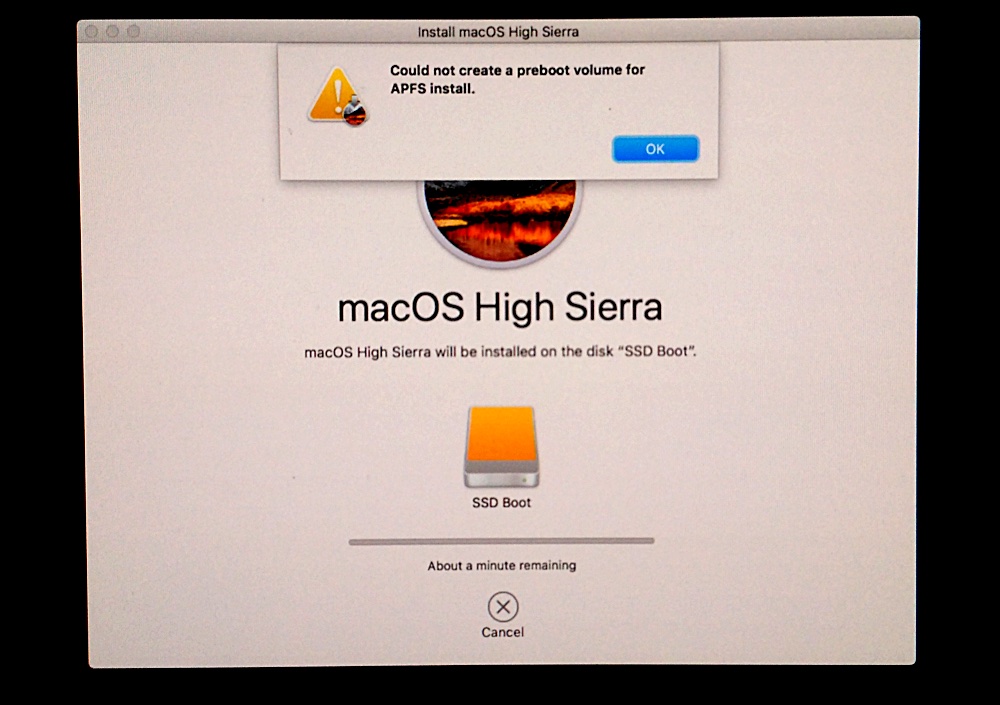

I know my situation is not quite the same but I've found a couple pics that may shed some light on the situation. The first image shows an error message that popped up towards the end of the process, while installing High Sierra and shows that the preboot volume couldn't be created.

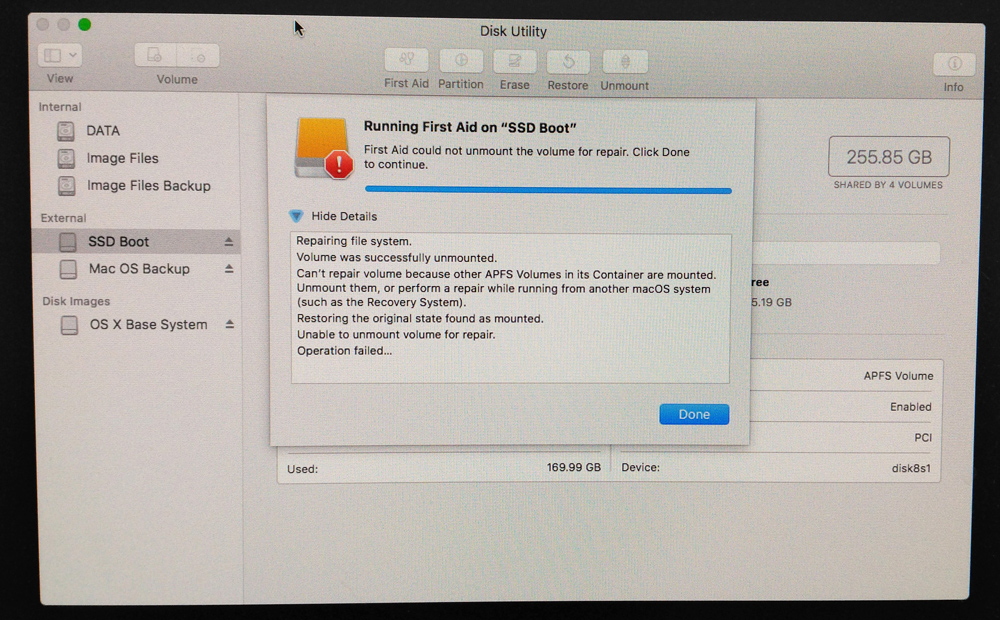

Following this install I had all sorts of problems that were not easily resolved and it just didn't feel right. I eventually booted into recovery mode after various attempts, but found it was impossible to repair the main startup volume where High Sierra had been installed. I can't tell you why, but it wouldn't unmount the drive.
At this point things became really messy and I couldn't even shut down the computer normally, so I eventually forced shutdown on the computer via the power button. The next time I started up I had the same prohibited symbol on the screen.
I left it like that and after several minutes it slowly advanced towards the recovery drive by itself, but this time I was able to repair the SSD in disk utility. Following this I wiped everything and did a clean install. The computer has basically been problem free since then, apart from an initial problem re-importing old email that was resolved after a while.
