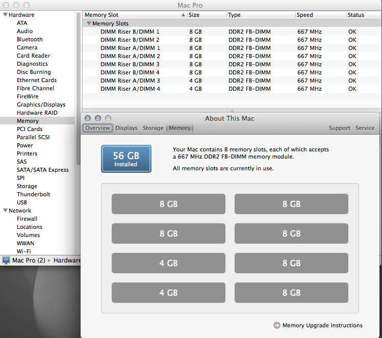

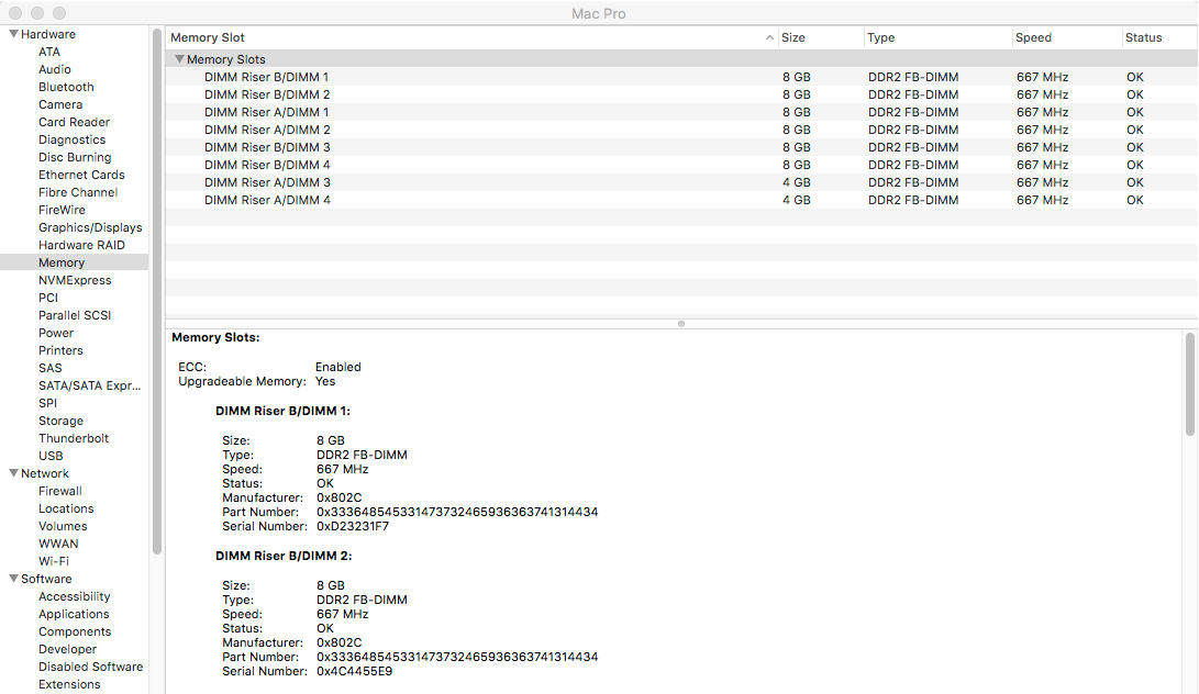

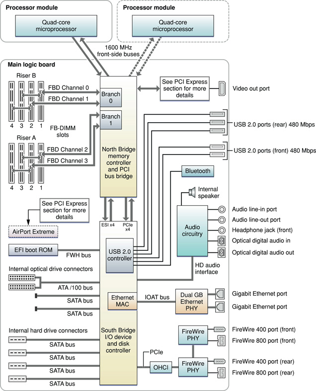

By the way - if you wish to utilize the maximum memory performance using 56GB (6x 8GB and 2x 4GB) in the 3,1, install the 2x 4GB modules in memory slots A3/A4 on Riser A as Riser B should be maxed out with the 8GB sticks due to the fact that it is assigned branch 0 in the north bridge memory controller and Riser A is assigned branch 1 - see attached diagram and screenshot of system information/memory.
Results: 11000+ MB/s fill rates and 6000+ MB/s copy rates which I wasn't able to achieve with any other combination amounting to 56GB.
View attachment 605268 View attachment 605269
