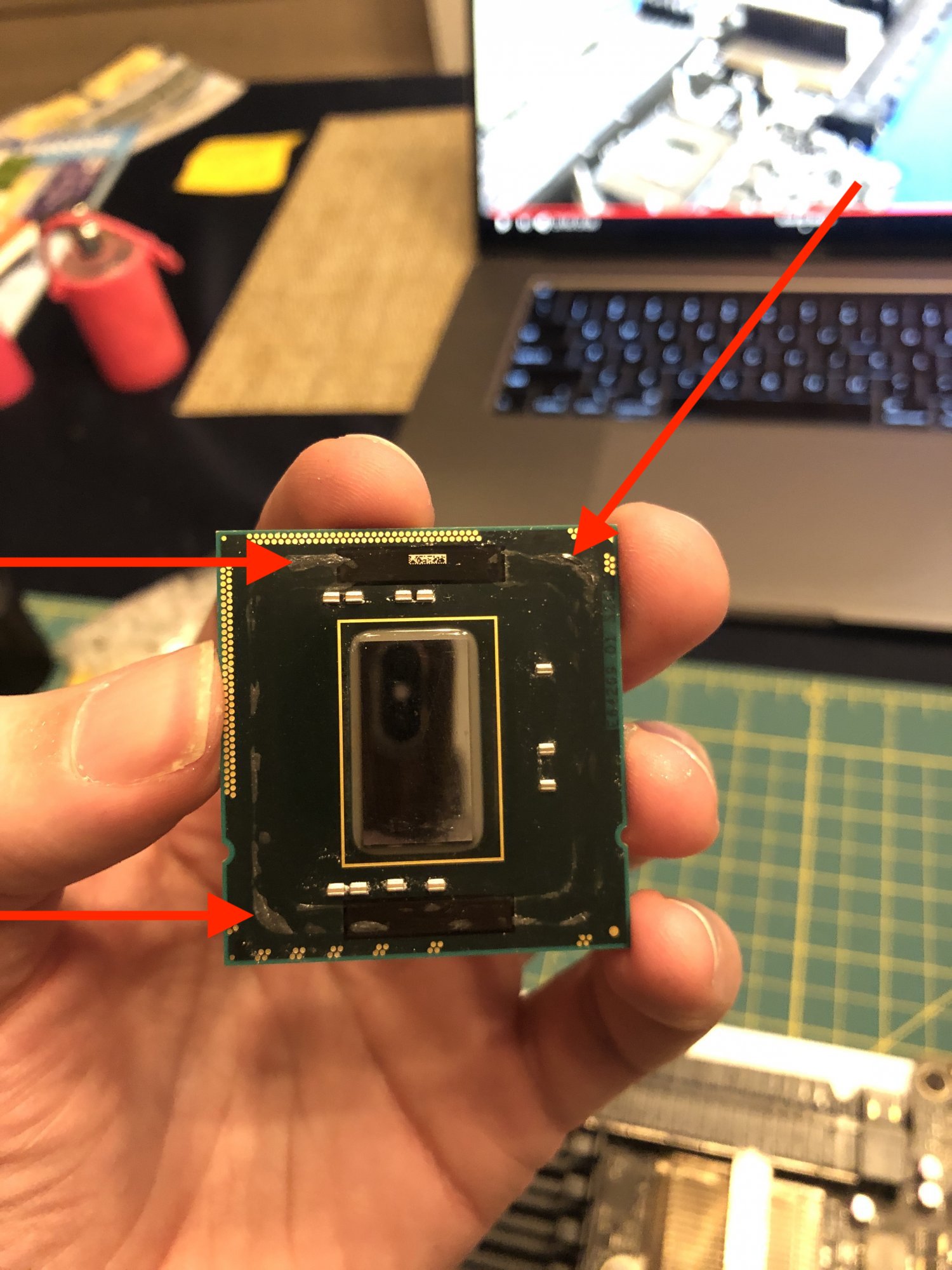

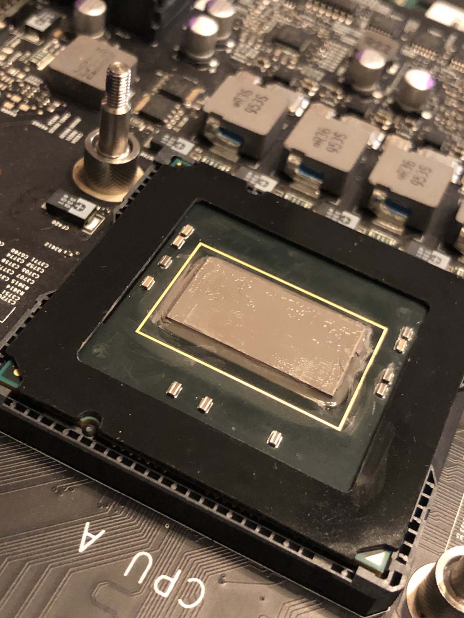

I also see a little too much of the black seal, it should be absolutely flat to ensure the spacers are not too thick.
i second that there is too much thermal paste. Just a thin layer is enough.
Reactions: KeesMacPro
What’s the best way to remove that black residue? I’ve read that it’s beneficial to spread the thermal paste before seating the heat sink to ensure complete coverage. Is that step not necessary?
take time and a razor blade and scratch the black residue off completely. Clean the remains with isopropyl.

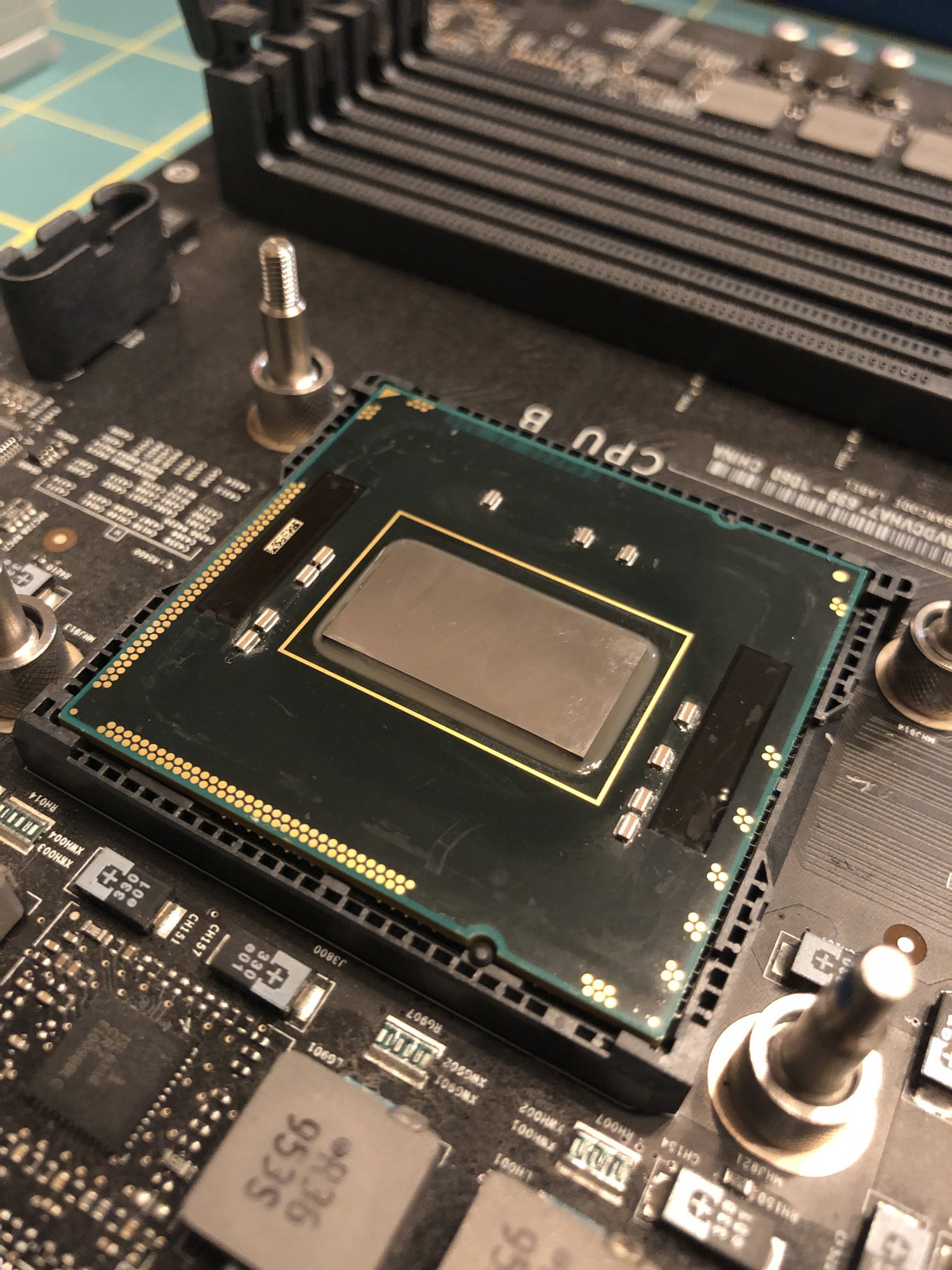

Its not clearly visible but I think on one of your pictures I see a gap between the processor surface and the plastic spacer.
This gap makes the construction too high and the heat sink cannot contact the processor die completely and evenly.
Remove the old paste completely from die and heatsink, clean it with isopropyl, let it dry and attach a thin layer of paste. I take the PCI bracket as a nice tool for it, you can hold it by the screw and it is handy.
You have to remove every residue of the black sealant or your heatsink won't be flat when using the black plastic spacers.

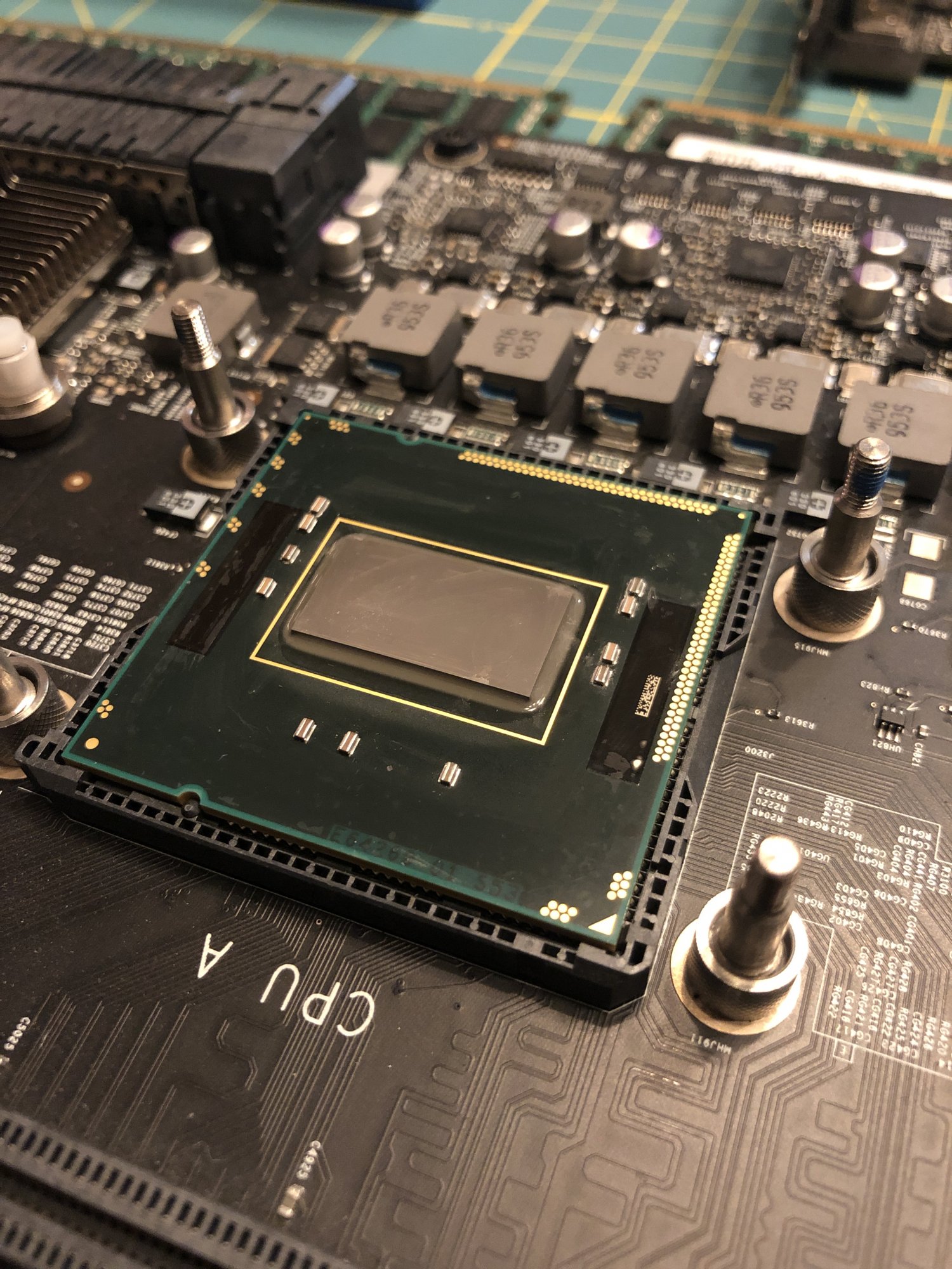

I then reinstalled the CPUs, carefully scraping off as much of the gunked-up black residue as possible and applying as thin of a coat of thermal paste as I could. Still crashing the same as before. See photos below.

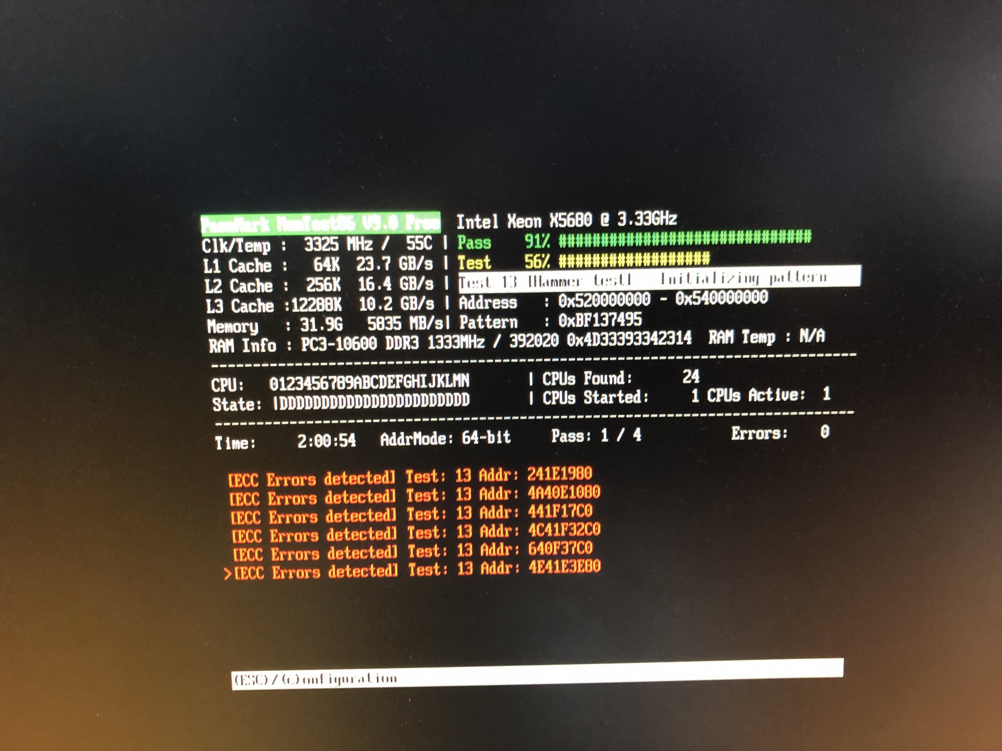

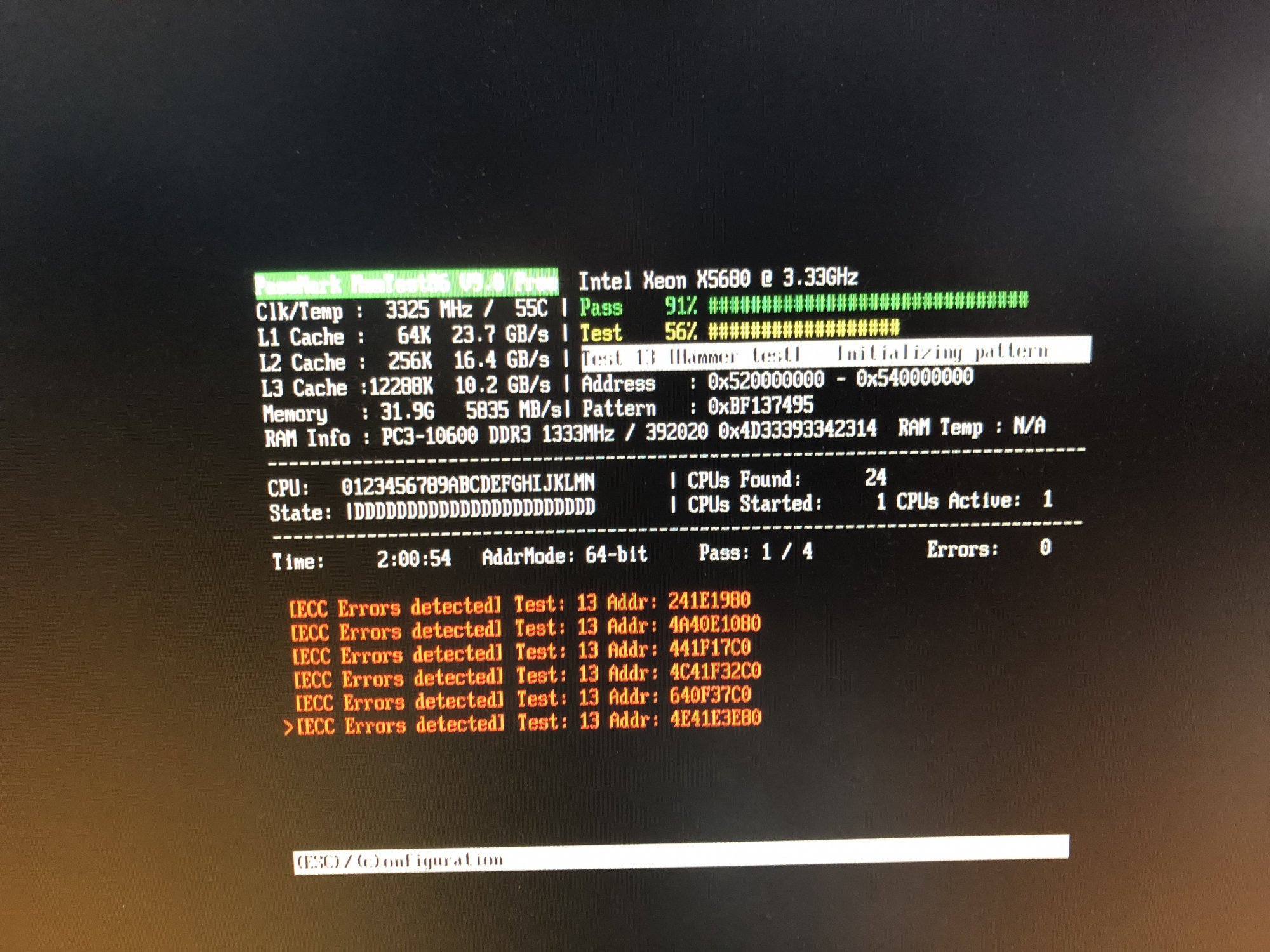

Memtest86 has been running for about 2 hours and on test 13, pass 1/4 it did spit out some errors. What does this tell me exactly? I found this article about getting errors on test 13 (specifically the "Why do I get errors only when testing RAM modules together, and not when individually tested?" section) but I'm not really sure what it means.
Should I let the test keep running?
Defective memory, it's triggering ECC. I'd replace it right now, it's cheap enough to not think twice, I'd lose a lot more money with a long job that fails.

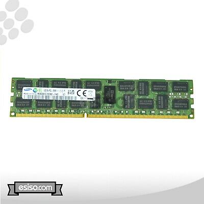

Completely crazy price. Buy server pulls from eBay. You can get 48GB (3x16GB) of the best Samsung RAM for half this price.
Compatible 3rd party RAM:
Samsung M393B2G70DB0-YK0 16GB PC3-12800R 1600MHz 1.35V modules with ECC that operate at 1333MHz in MacPro5,1 with 2x5690 CPUs. Cisco server pulls (Cisco Part Number 15-14595-01). Some other identification stats/specs, if helpful: 16GB DDR3-1600 RDIMM PC3L-12800R Dual Rank x4 Module, CL11, 2Rx4, 240pin
