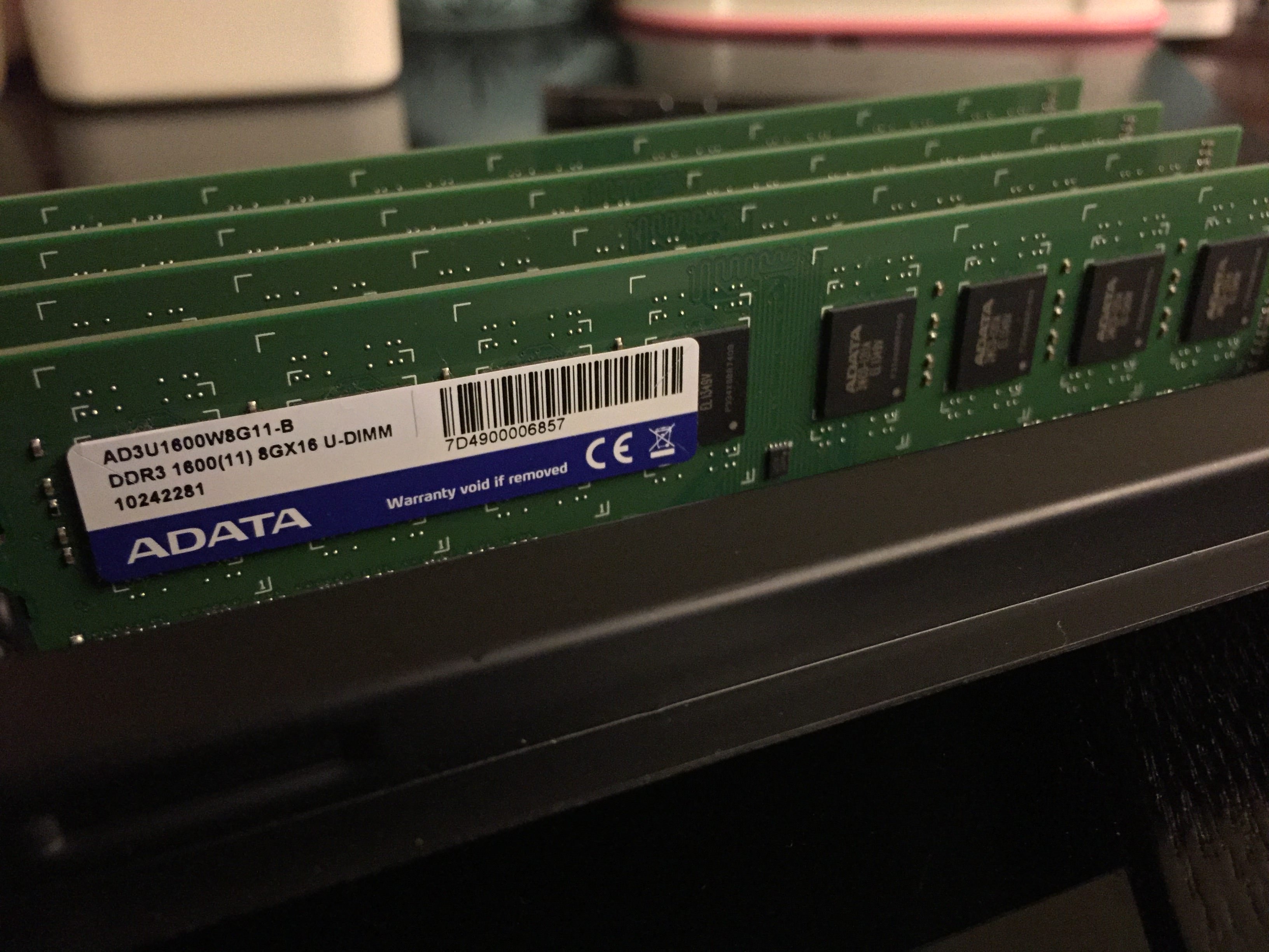

This non ECC UDIMM can also be used in cMP. I actually used these DIMMs for few years.
ADATA AD3U1600W8G11-B
It is a 1600MHz DIMM. However, for this DIMM, if running 3x8GB, the RAM can run at 1333MHz without issue. But if install them in all 4 slots, the clock speed will be automatically reduced to 1066MHz. This DIMM also has life time warranty provided by ADATA.

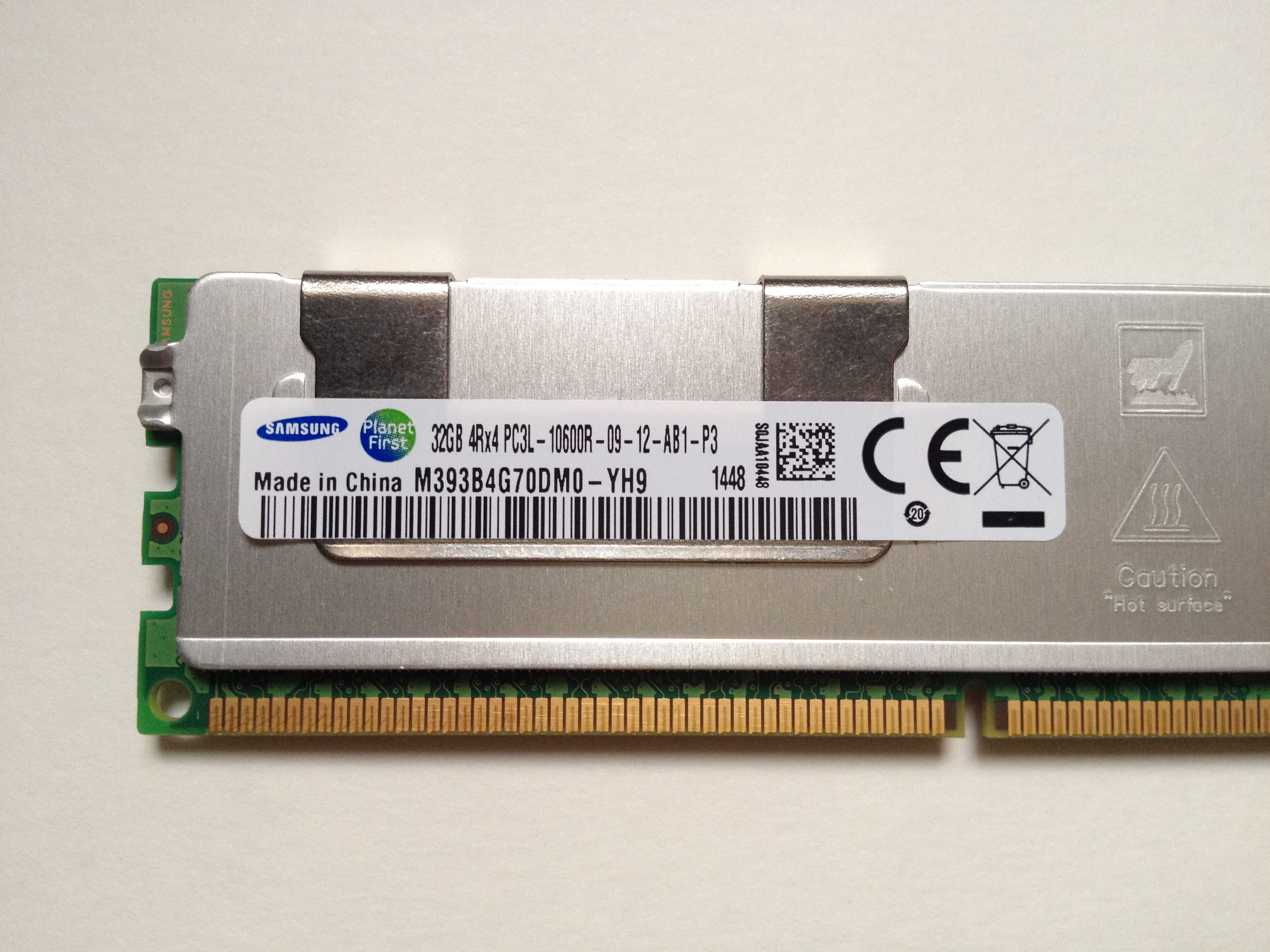

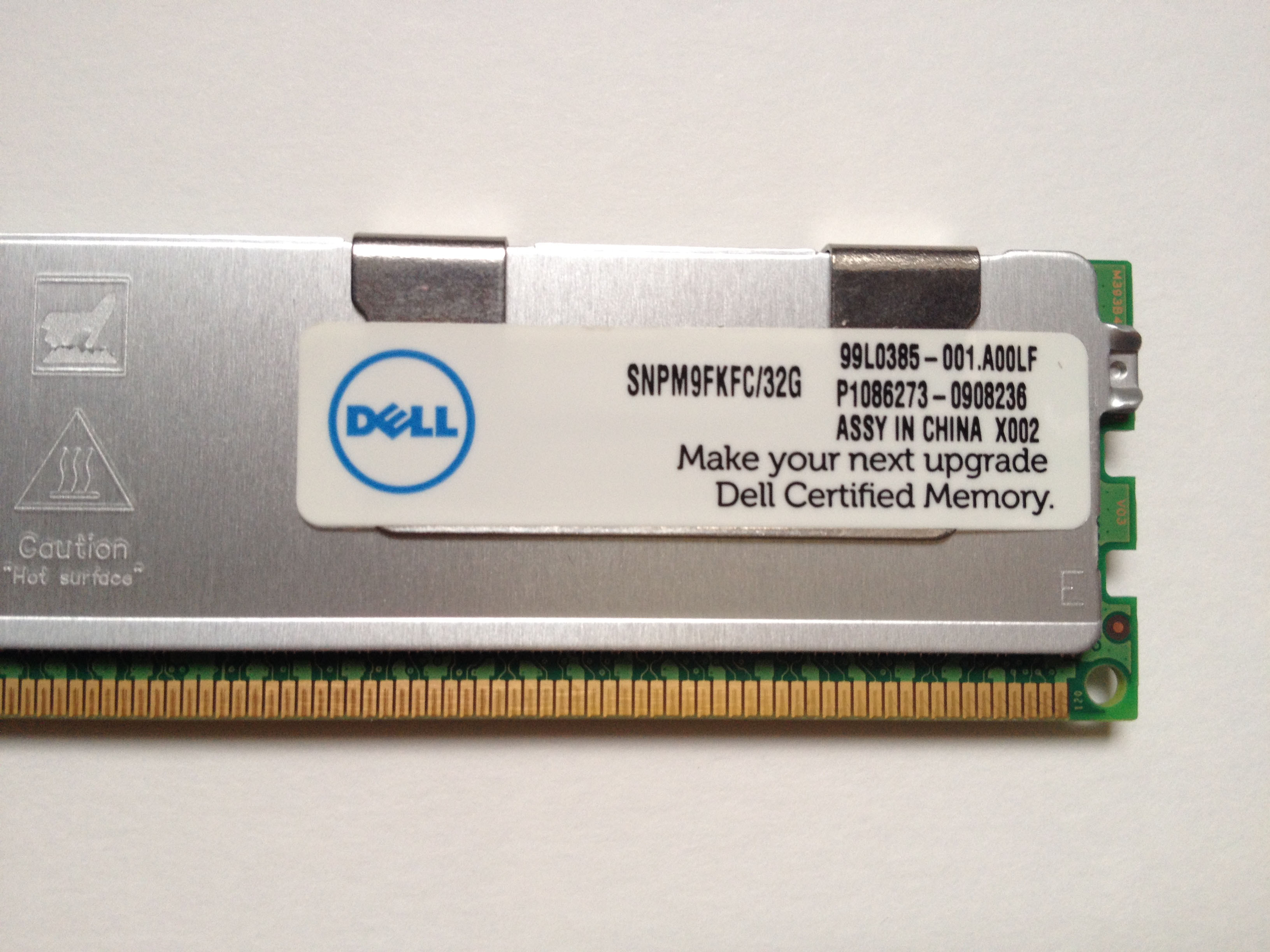

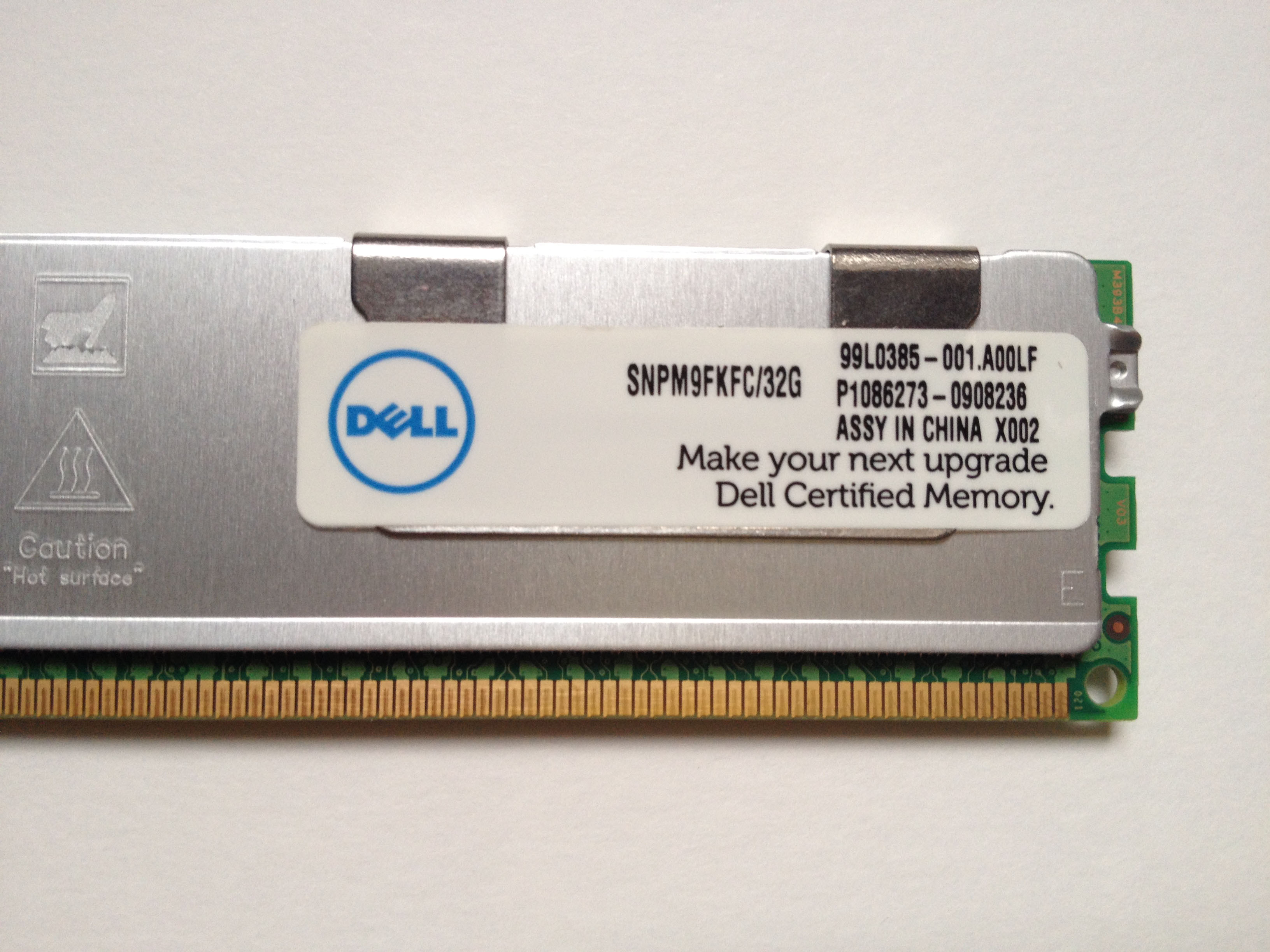

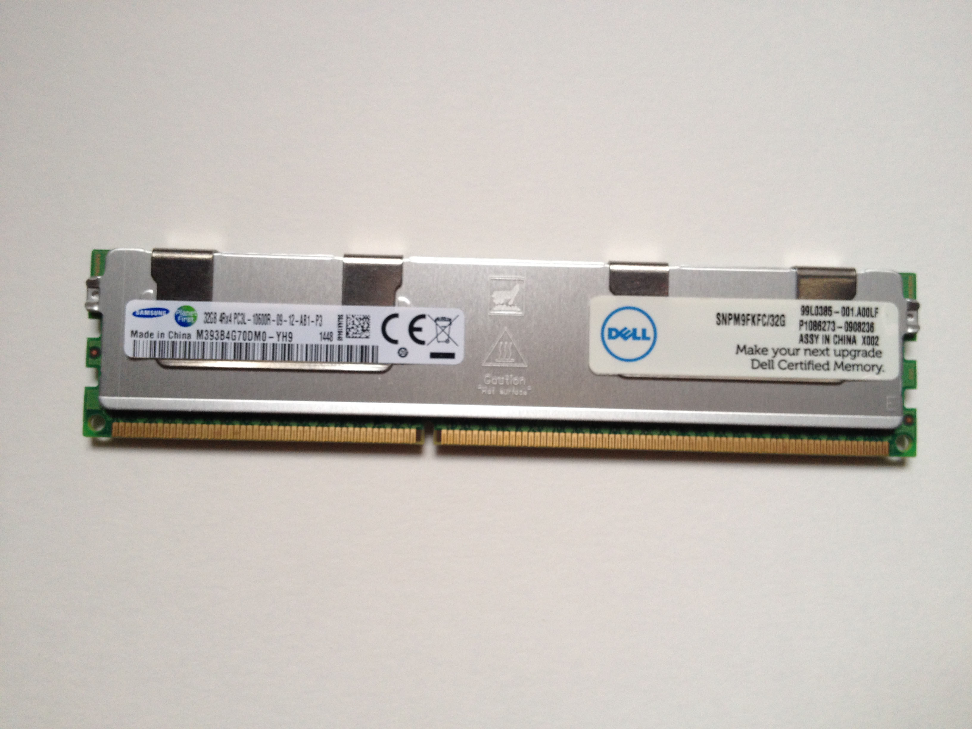

actually i have mac pro 5.1 (4.1 flashed) Boot ROM Version MP51.0085.B00
i tried to add 2 x 32GB DDR3 4Rx4 to have 160GB ram,
but the mac pro don't like the 32GB sticks in any configuration.
slot 1 32GB
slot 5 32GB
mac pro don't start...no chime
slot 1 32GB
slot 2 16GB
slot 5 32GB
slot 6 16GB
mac pro start up with no problems, but it shows empty slots in slot 1 and 5 and total memory is only 32GB.
but somewhere mac pro see the 2 x 32GB sticks in slot 1 and 5 because
the total memory is downgraded from 1333mhz to 1066mhz speed.
usually i have 128GB ram running at 1333mhz.
if you have any idea why theses 32GB sticks
are not visible, thank you for your help and comments.
i resetted PRAM after intalling 32GB sticks,
thank you.
please see "about this mac"
slot 1 32GB
slot 5 32GB
slot 1 32GB
slot 2 16GB
slot 5 32GB
slot 6 16GB
voila my tests, if you have any idea why theses 32GB sticks
thank you.
View attachment 762731 View attachment 762732 View attachment 762733 View attachment 762734
The ram shown in the pic is a R4x4 32gb part. AFAIK... The 4,1/5,1 is compatible with R2x4 ddr3 RAM.
I’m currently running R2x4 16x16x16x8 with a 990x on a 4,1 flashed to 5,1

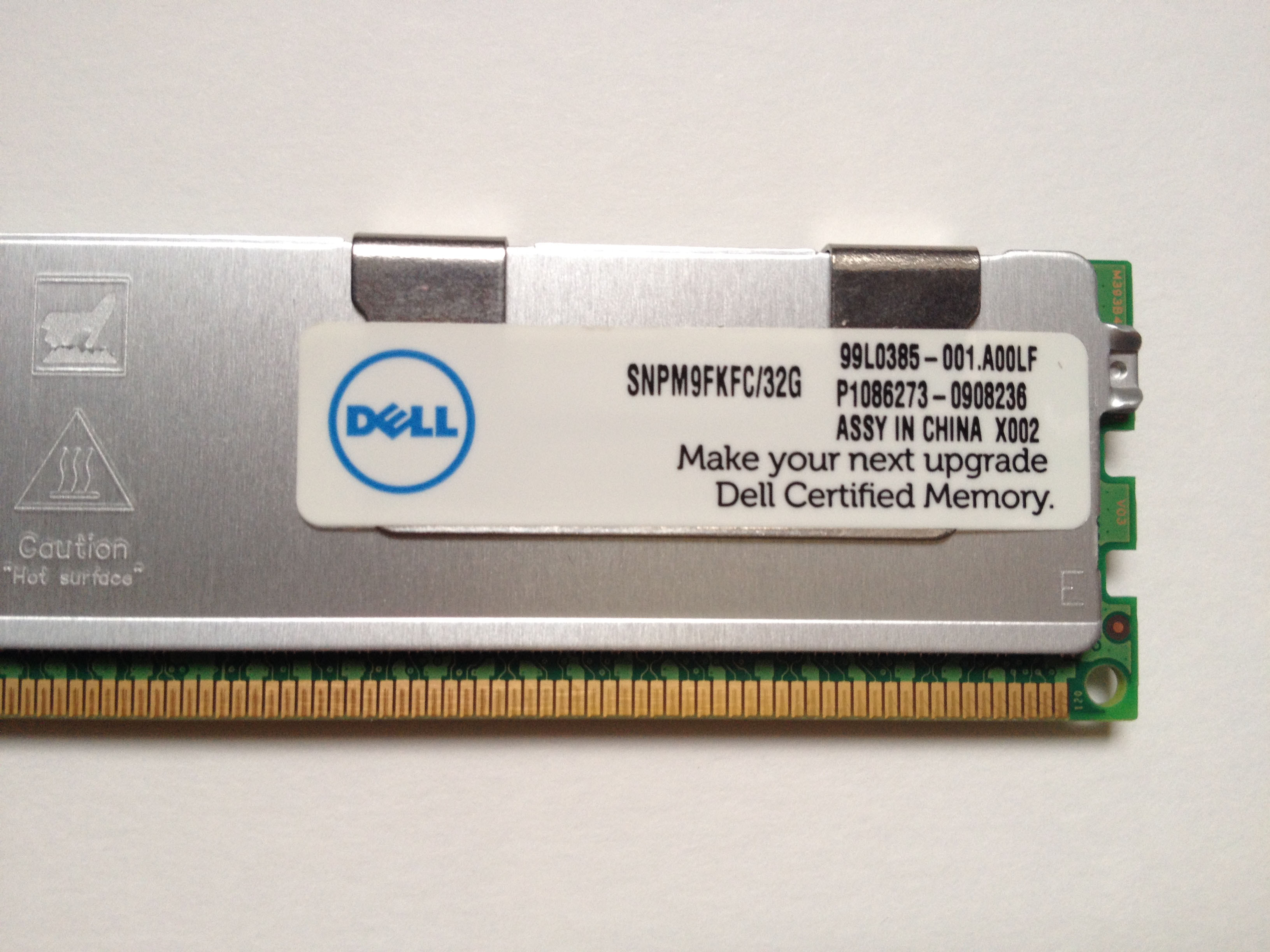

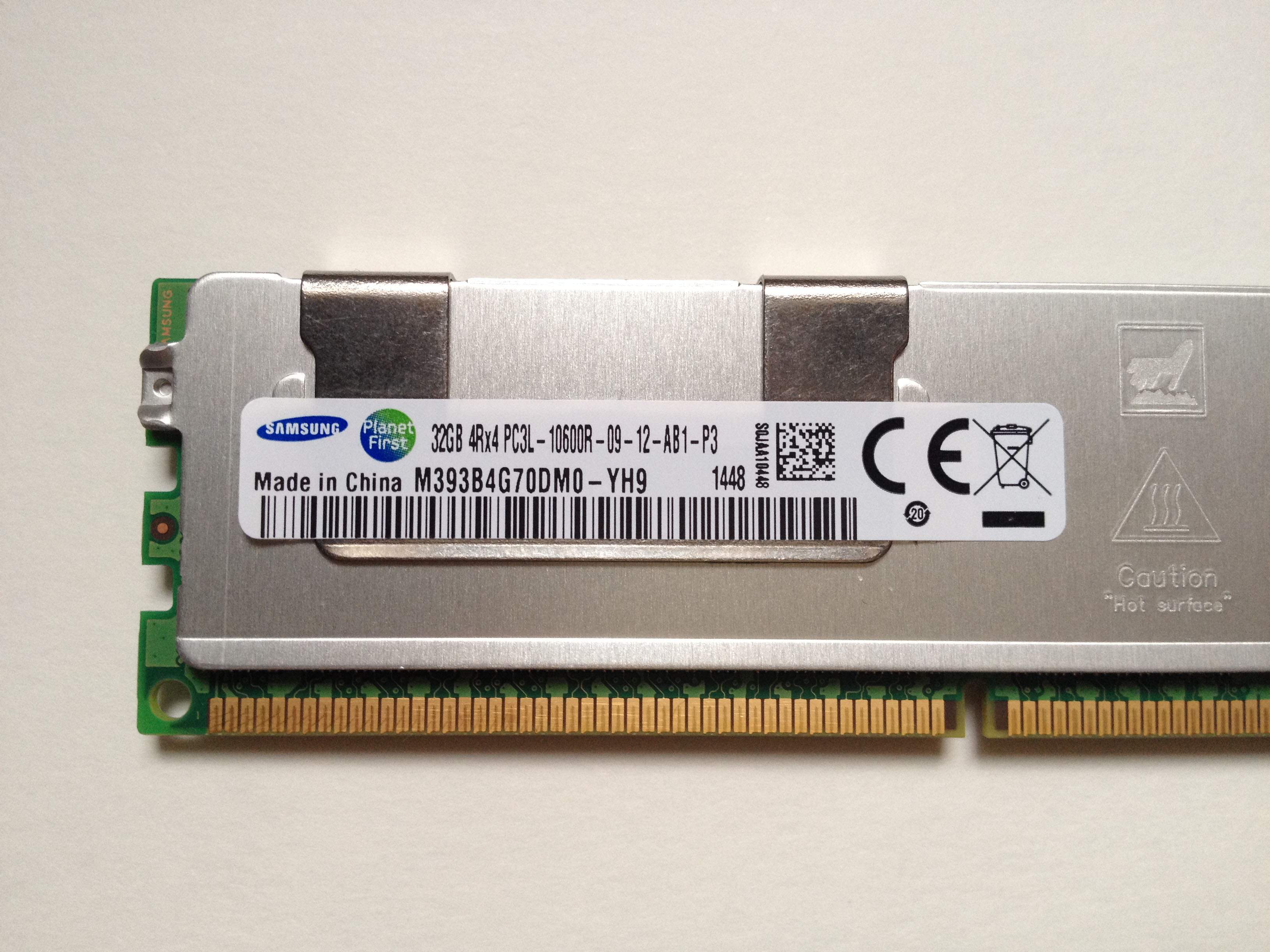

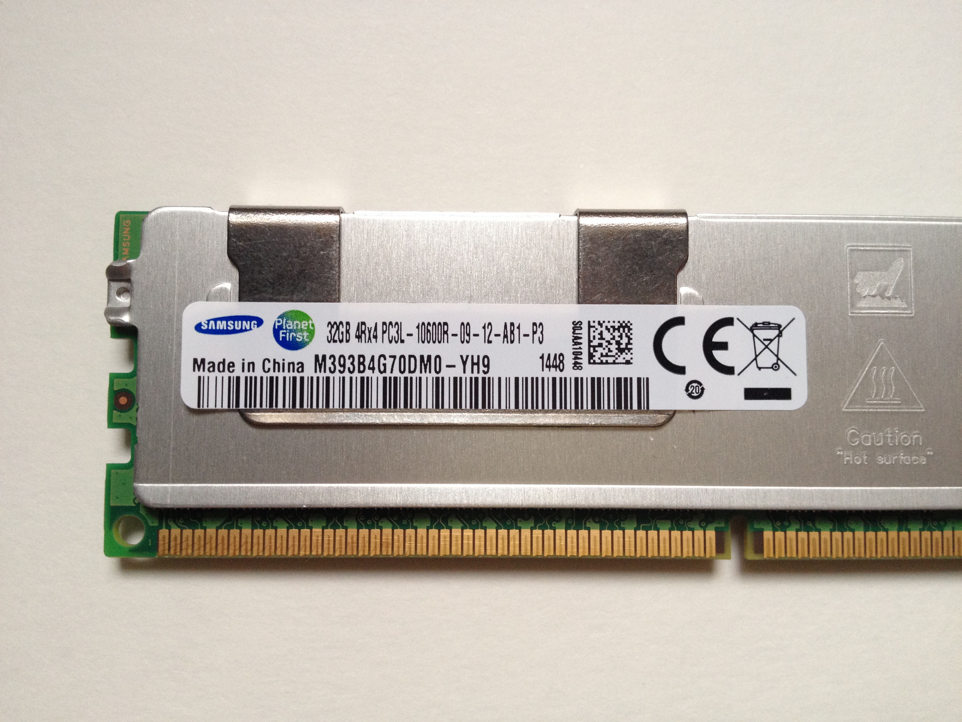

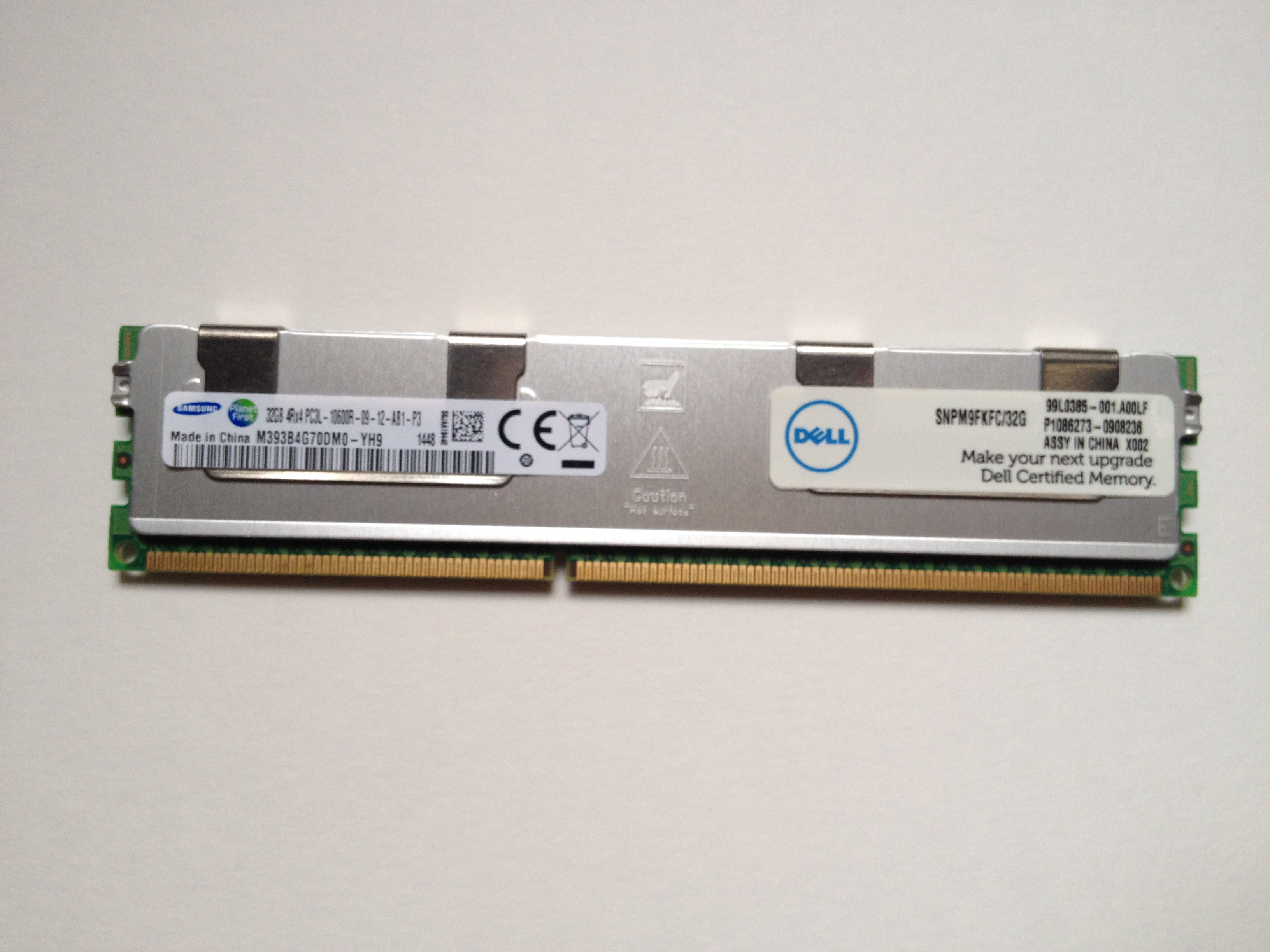

32 gigas Ram with one CPU ( Mac pro 4.1) not flashed = no trouble
Memory :
Samsung 8GB 2Rx4 PC3L-10600R-09-10-E1-D2 -> M393B1K70CH0-YH9

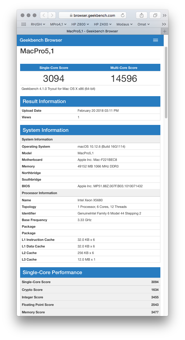

I believe you can do that, but why would you? (that's at least what I think I have read from threads here at MR)
That way you will lose triple channel bandwidth, versus with 3x16GB you get the ram cheaper AND get triple channel speed OR with 4x16GB you again lose triple channel, but the modules will be cheaper to buy versus 32GB+2x16GB.
If you own a 32GB stick already, then I understand the need for this.

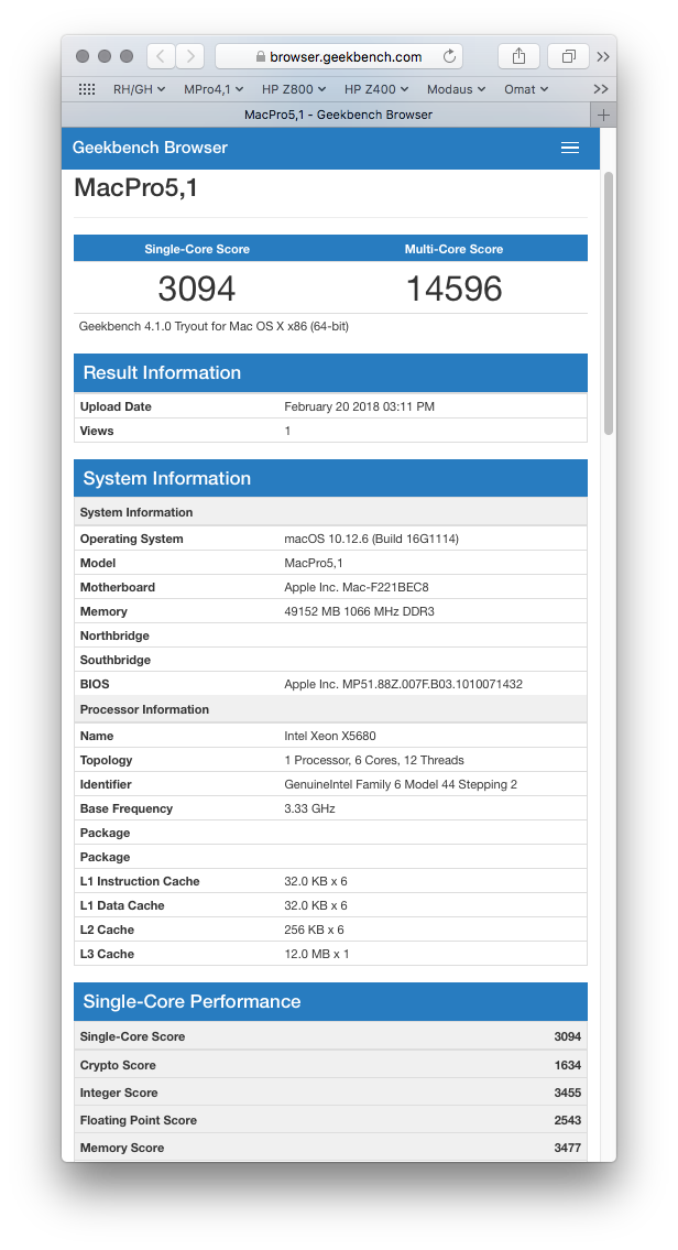

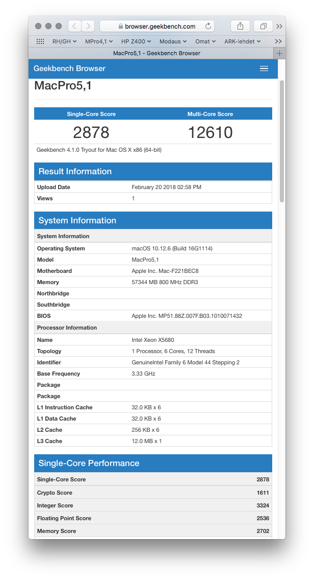

I use 48GB in my single processor Mac Pros (4,1->5,1).
I once tried 56GB on a single proc (3x16GB+8GB), and I lost quite an amount of speed. So I took it back to 48GB.
(see attached pics, the same config exactly but the memory).

I'm just not sure if there is a 32gb module that will work in this configuration.
