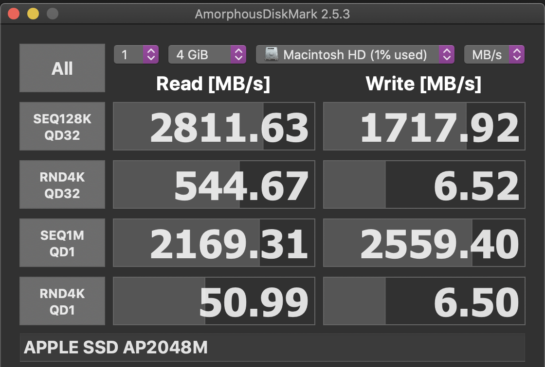

Reading this thread (and a few others before it) almost made me cry. I got an iMac Pro for 4-5 months now and lately figured I'll just put its advertised speeds to the test. Imagine my surprise...
I also downloaded the new-ish Sensei app (website is literally sensei.app) and enabled TRIM from there, waited 5 minutes for kernel modules cache to rebuild and rebooted. Re-ran benchmarks, no appreciable difference except that both 4K write speeds went to 14 MB/s.
I have NOT rebooted in single-user mode and have NOT ran `fsck -fy` though. I hear it might help due to actually flagging a lot of areas as properly freed, or something.

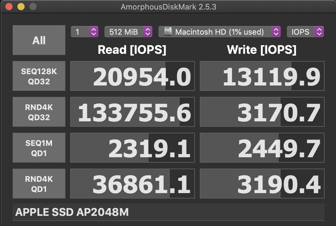

As a programmer database performance on my workstation is very important. I haven't seen any problems btw; but the 2x difference between actual sequential write speeds (1.7GB/s) vs the marketed one (3.3GB/s) is worrying. Anyone has an idea where is the discrepancy coming from? I got the 10-core variant with 64GB RAM and (obviously, as seen on the screenshots) the 2TB SSD.
I keep seeing normal user-grade SSDs outperforming my supposed beastly SSD in the 4K write tests. While I haven't noticed any actual slowdown in heavy workloads, I am still kind of worried.

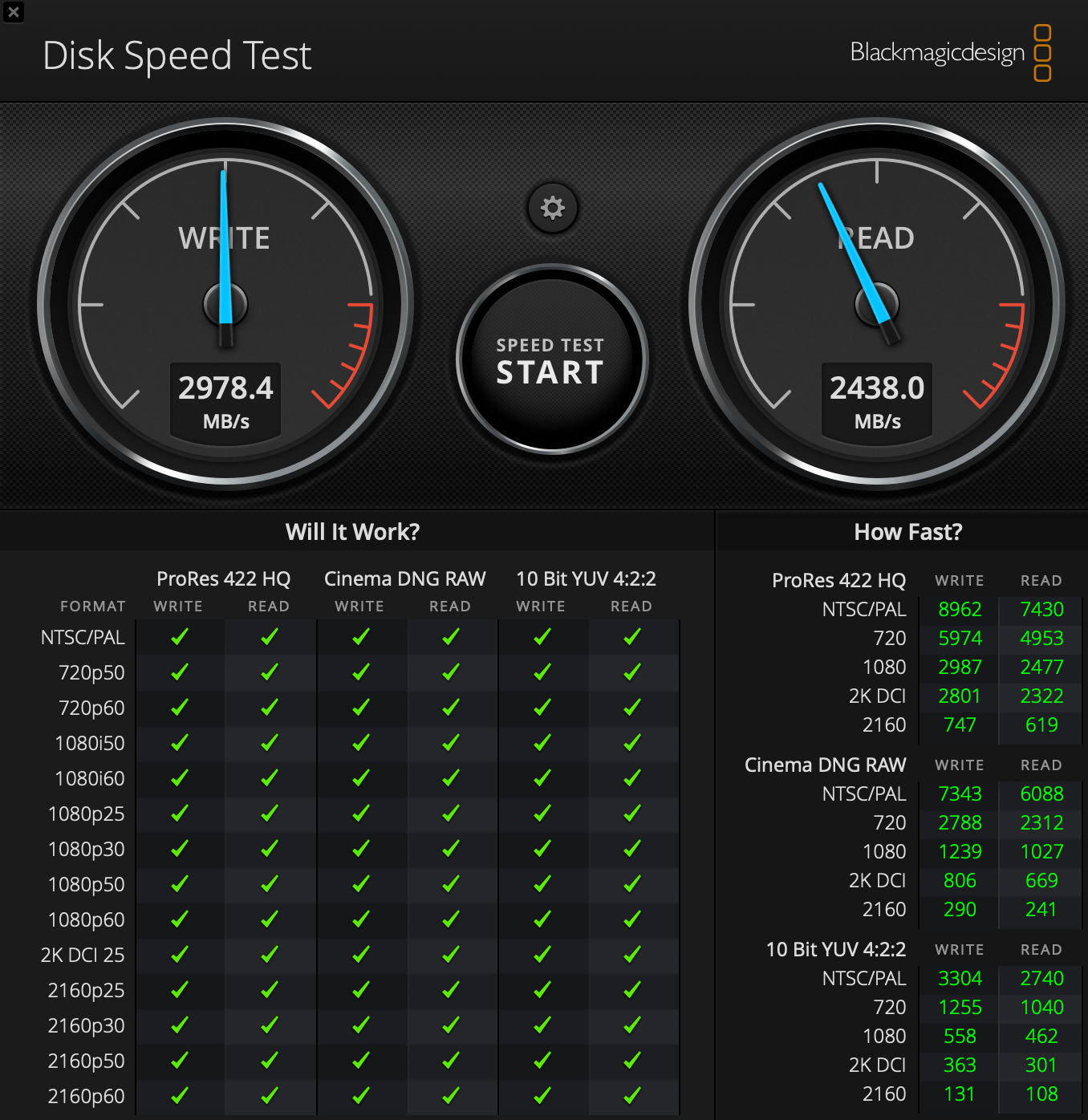

Figured I'll run Blackmagic as well:
Both reads and writes seem about 350MB/s below advertised speeds (2.45GB/s vs 2.8GB/s read -- and 2.95GB/s vs 3.3GB/s write) but this looks a bit better.
I suppose that the benchmarking tools in general haven't been kept up to speed with such hardware plus the APFS filesystem peculiarities. Or maybe Blackmagic tests unrealistic workflows (seems to only test sequential read/write) to make the owner of the machine feel better. 😀
