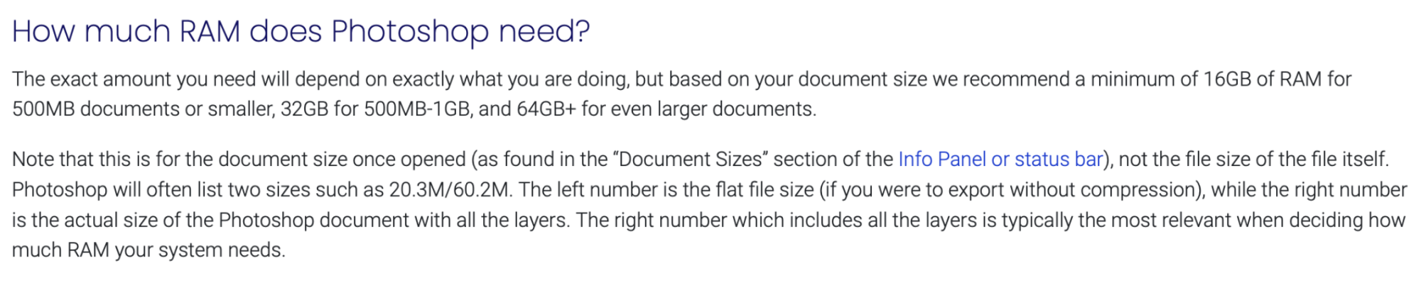

Unfortunately, if you're trying to decide whether 16 GB is enough, you can't use the Memory Pressure or Swap Used figures from your current device, since they're for 32 GB RAM.
You've specifically mentioned being concerned about the RAM usage from SketchUp, but you might also want to pay attention to Photoshop. According to https://www.pugetsystems.com/soluti...ons/adobe-photoshop/hardware-recommendations/ , you want to consider your document sizes:

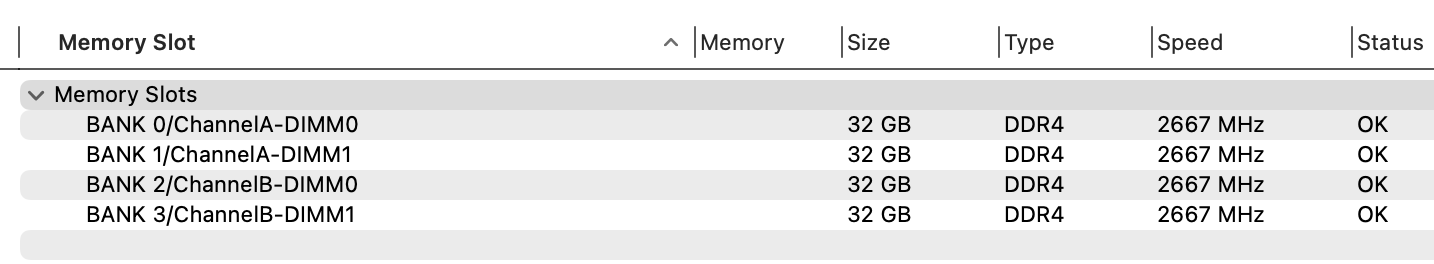

Actually OP can, to some extent, by removing half the RAM from OP's current iMac
Ah, that's a clever idea.
@Warped9 : I assume you've got 4 x 8 GB sticks. If you do what wilberforce suggested, which will show you what 16 GB feels like for your use cases, you'll want to leave one stick in Channel A and one in Channel B to maintain dual-channel RAM speeds. If it's like my 2019 iMac, that means you want to leave sticks in the 1st and 3rd (or 2nd and 4th) slots. You can check this in Apple ->About this Mac -> System Report -> Memory. You'll see something like this (except the stick size will be 8 GB instead of 32 GB, the Type and Speed will be different, and when you're done you'll have two that are empty):

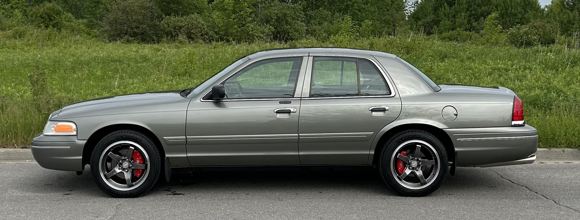

My considering the option of going with a Mac Studio and a new display reminds me of another (unrelated ) choice I faced about a year ago.
For some time I had been considering upgrading the wheels on my car. I had 17in. wheels and really wanted 18in. wheels. But I had two considerations weighing on me. Firstly, the tires I had on my car were very low mileage—almost new. Secondly, moving to 18in. wheels also meant I would have to buy new tires to fit those larger wheels.
New wheels meant about $1000 CAN. New tires, good quality Michelins, meant nearly $1000 CAN as well. That meant essentially doubling my cost to upgrade. And the car wouldn’t perform better in any significant way with bigger wheels as the tire width would remain about the same.
I really wanted 18in. wheels for the cooler look, but I was bugged by having to buy new tires to replace my present tires which were like new. Aarrrgh!
In the end I decided to get wider 17in. wheels (wider than my previous ones) in a new design which also allowed me to keep my present tires that I was very happy with and still had a lot of mileage in them. So while the new wheels aren’t bigger than the old ones they do sit wider thus giving the car a different stance.
So while part of me would still kinda like bigger wheels I quite like my new setup which gives the car an athletic stance.

You'd have got a worse ride with the lower profile new wheels and tyres as well. And the suspension would be tuned for your current profile tyres. She still looks great too.
Since more than a year ago I bit the bullet and upgraded to 18in. wheels with 50 series profile tires. Car looks better and it hasn’t hurt the ride.
Other upgrades include Stainless Works headers to go with the SW dual exhaust, upgrade throttle body/plenum and air intake, 3.55 gears and custom tune. It rides, handles and sounds great.
