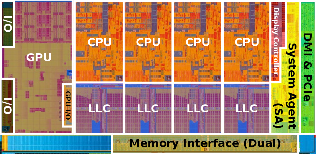

You are talking about long, long, ago in a Galaxy Far far away. Pre-2010. Back when Intel still allowed 3rd party Northbridge ( memory controller, PCI , and maybe iGPU) and Southbridge. (USB, general I/O , sound , etc. ) chips to be using on their "CPU only" packages.
Around 2010 Intel started to integrate memory controllers into the CPU die (and package). Pragmatically iGPUs came on die along with those too. [ doesn't make much sense at all to decouple a GPU subsystem "far away" from the required memory controllers. ). Ever since Intel switch over to Core iX (i3, i5, i7) there have been GPUs on the same die as the CPU cores (and memory controllers). For over the last decade the only Intel packages that didn't have a GPU in the personal computer space have been those based on the workstation/server dies. ( E5 , W 2000/300 series, Xeon SP , etc.)
In the per-2010 Nvidia sold a Northbridge with a shared memory controller and iGPU built in. (e.g. Geforce 9400M ). Intel and AMD kill all that off over a decade ago.
Once Intel got to the point where most of the mainstream CPU packages they were selling went into laptops, they have had iGPUs in all their mainstream offerings (for both desktop and laptop). Just to confuse things after a while Intel would label some HEDT dekstop package based on Workstation/server dies as being Core i7 xxxX or Core i9 xxxx. Those wouldn't have an iGPU but the 630UHD that some in this thread 'complained; about are integrated GPUs (iGPUs) not discrete GPUs (dGPU) . They are integrated onto the same die as the CPU cores and memory controller.
For example the. Core i 'Sandy Bridge' systems from 2010
That box in the middle of the diagram is a logical description of the die on the "CPU" package. It has more than just CPU cores. The PCH ( platform controller hub) is handles the more general i/O USB/SATA/sound/etc. "IMC" integrated memory controller.
Same article an annotated die shot
Modern Intel mobile dies have Thunderbolt controllers built into the die also. The folks looking for ultimate CPU core counts and hyper modular GPUs grumble at the 'wasted' space for the iGPU. Toss the display controller and GPU and the GPU I/O and could perhaps fit 6 CPU cores on the same die. Intel has resisted that for more than several years.
In the laptop space it doesn't make much sense.
For last 5-8 years , on Intel mainstream 'CPU' dies there has been as much die space allocated to "uncore" (non x86 Core functionality) as to the 'CPU' cores . The 'CPU package' is really not only a CPU package anymore.

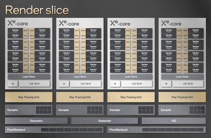

The Xe-HPG Arc GPUs aren't "scaled up legacy iGPU" cores.
"... Instead, starting with Alchemist (and Ponte Vecchio), Intel is introducing a new fundamental building block: the Xe Core. ... "
The older previous generations and the Xe-LP ( Tiger Lake) never had matrix units.
The 'Xe Core' of the HPG is more so a scaled back 'Xe Core' from the Ponte Vecchio product ( 8 vectors at 512 width and 8 matrix at 4096 width per 'core') dropping back to ( 16 vectors at 256 width and 16 matrix at 1024 ) more vectors that are narrower , but smaller big matrix aggregate width.
The Arc aren't necessarily just pigeonholed into only "data mining". Video content creation they are probably better (compared in the same price class ) than the AMD and Nvidia solutions. Lots of folks are producing/streaming video these days. Intel appears to have thrown "transistor budget" and die space at fixed function A/V and display output breadth than AMD and Nvidia have. Drag the testing into a niche of transcoding. H.264 to H.265 then Intel will probably win. ( transcode into AV1 they'll surely win as long as software taps the hardware to do the work. )
