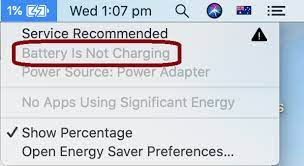

Thank you, I have the 13". The battery light indicator flashes multiple times. I also forgot to mention that the battery charged from 10%-35% very slowly, like extremely slow.
It also showed this every time it was plugged in:
Is the battery the culprit of this, or the dc-in board, as you mentioned in your reply?

Hard to say, especially since you cannot look into SystemPrefs to ascertain the battery condition. Does the previous owner say anything when it was last replaced?
Discounting the charger itself, also having reset the NVRAM, try an new battery as a starting point. In my case, green light on MagSafe prevented charge dropping below 25% but wouldn't turn orange to charge above that either. "Battery is not charging" was also my alert but I did have an obvious short and had a replacement charging brick and DC-In board.
"Service Recommended" in his screenshot is a bit of a giveaway about the battery health, but if it will charge up to 35% I wouldn't expect that to stop it booting at all, especially if plugged in.

that was a photo I've got off Google, just to give a hint to what was happening with my battery
