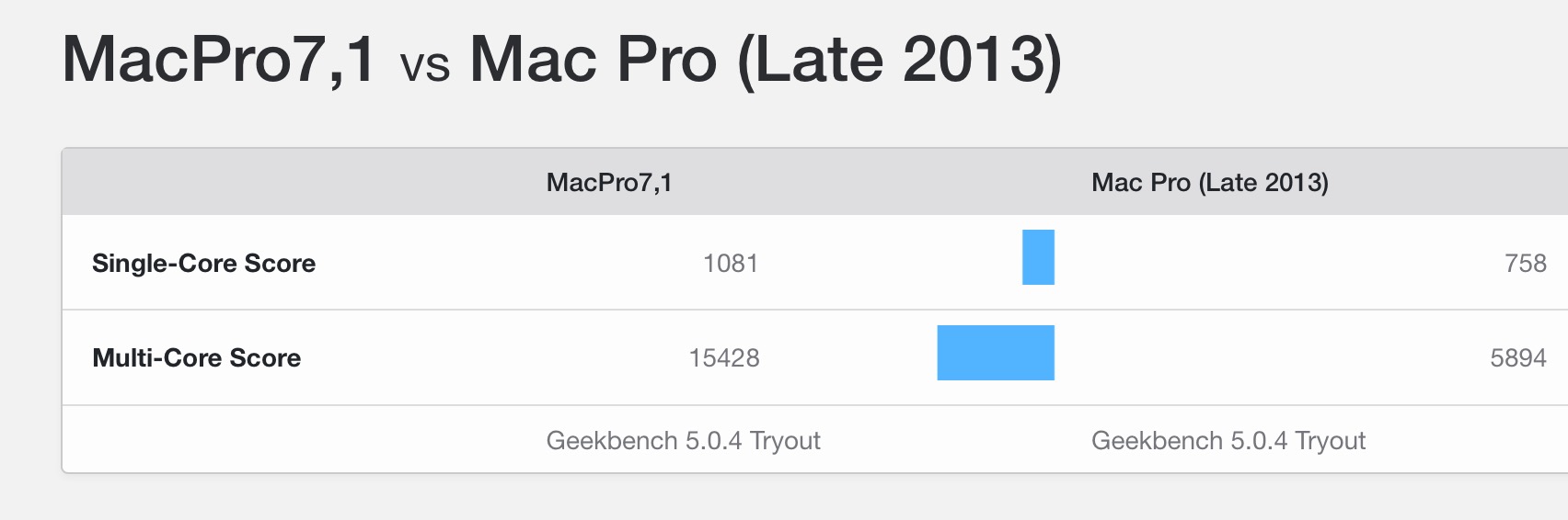

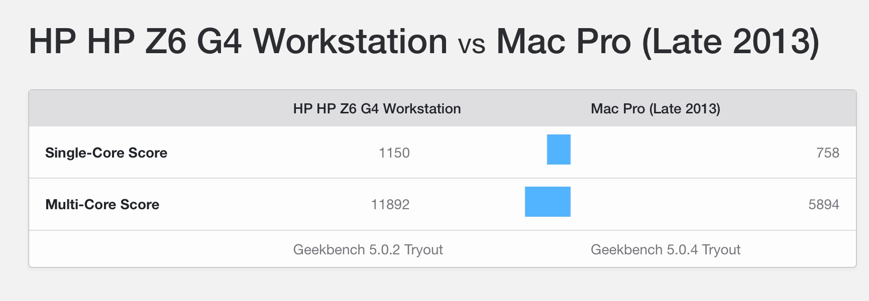

I went to compare my trashcan with the 12 core and 16 core Intel CPUs on Geekbench. Here are the results:
12 Core:
16 Core:
Well Well Well.... so obviously the 12 core is stronger in Single Core. I can't judge how mich of a difference 70 points make, maybe someone can weigh in.
At the same time, the multicore score is already twice as fast on the 12 core over the 8 core trashcan, while the 16 core obviously adds another shovel on top of that.
Just looking at the graphs though, the performance gain for after effects looks better on the 12 core. Ahhhhhh
