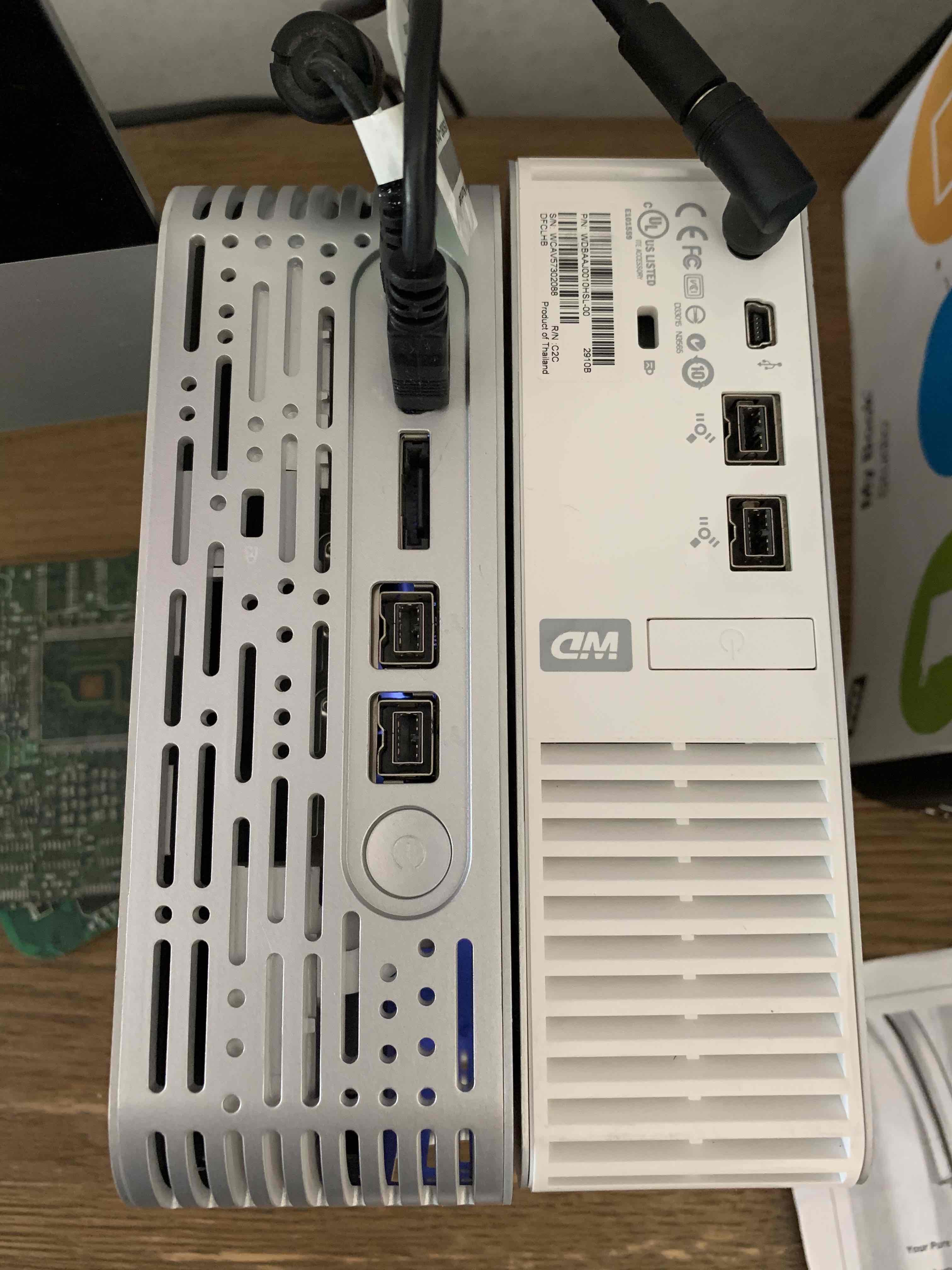

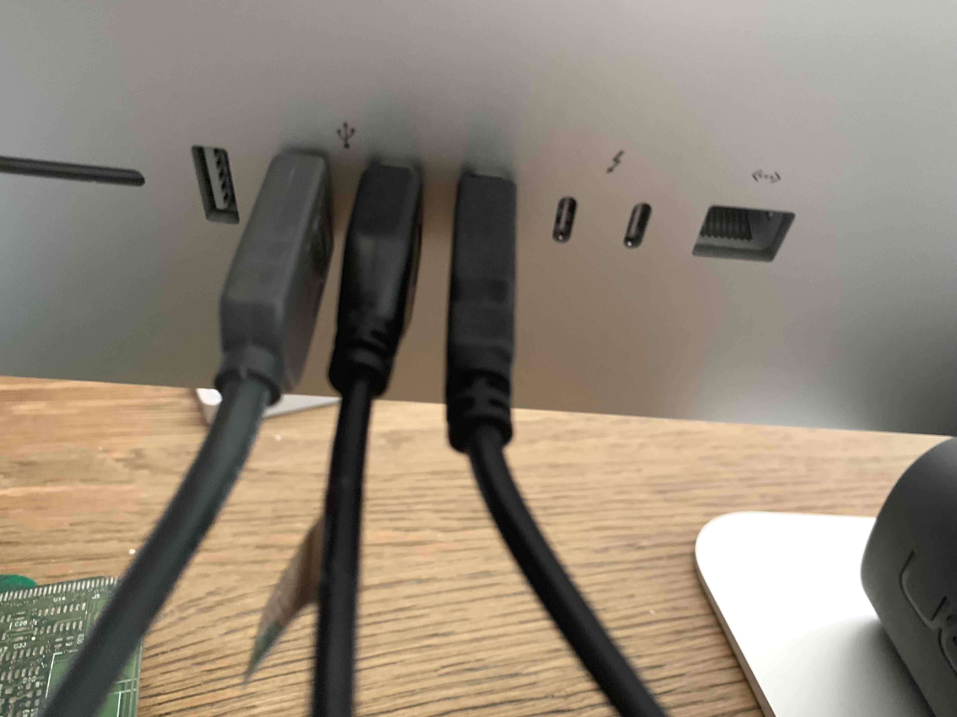

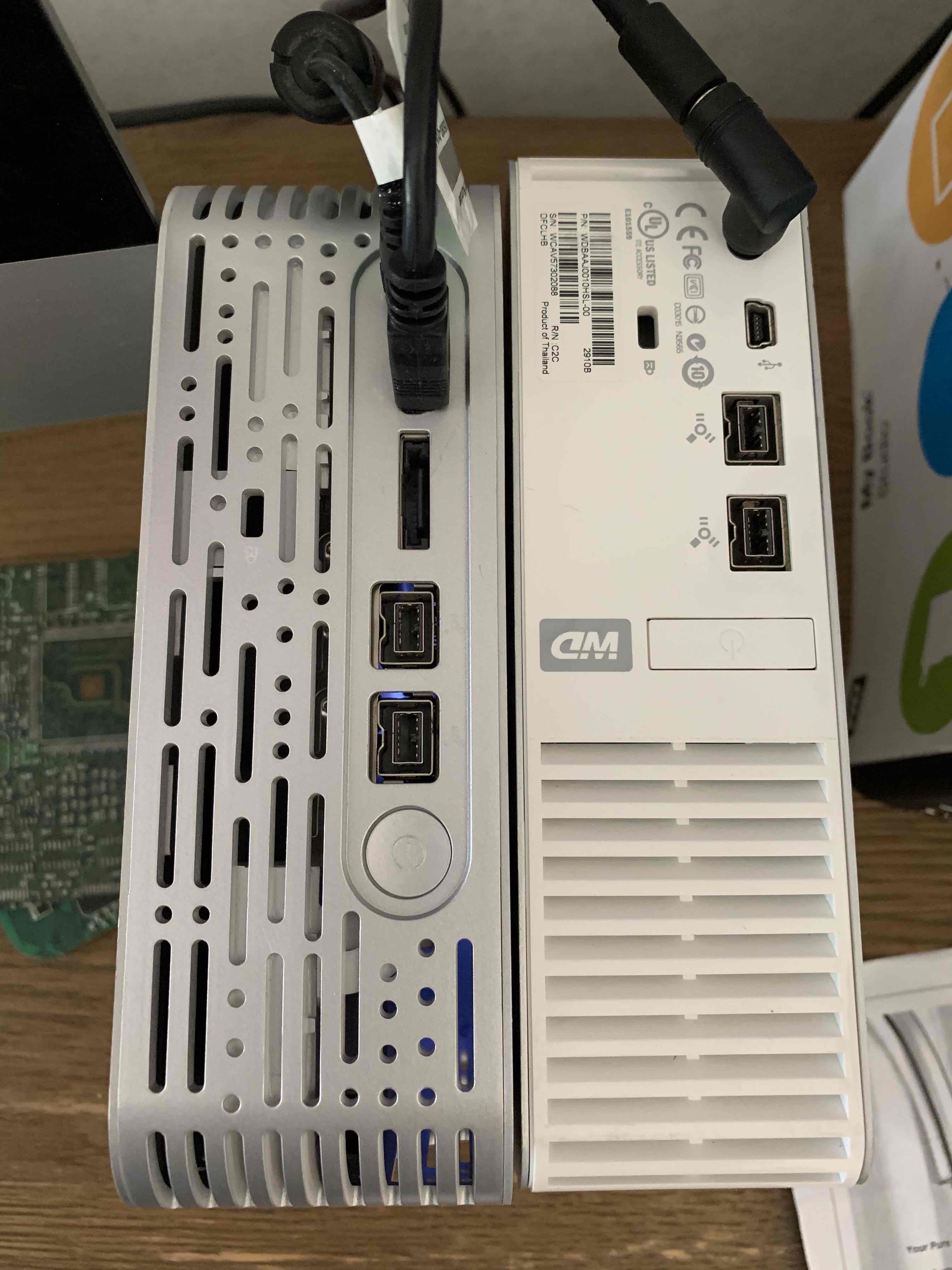

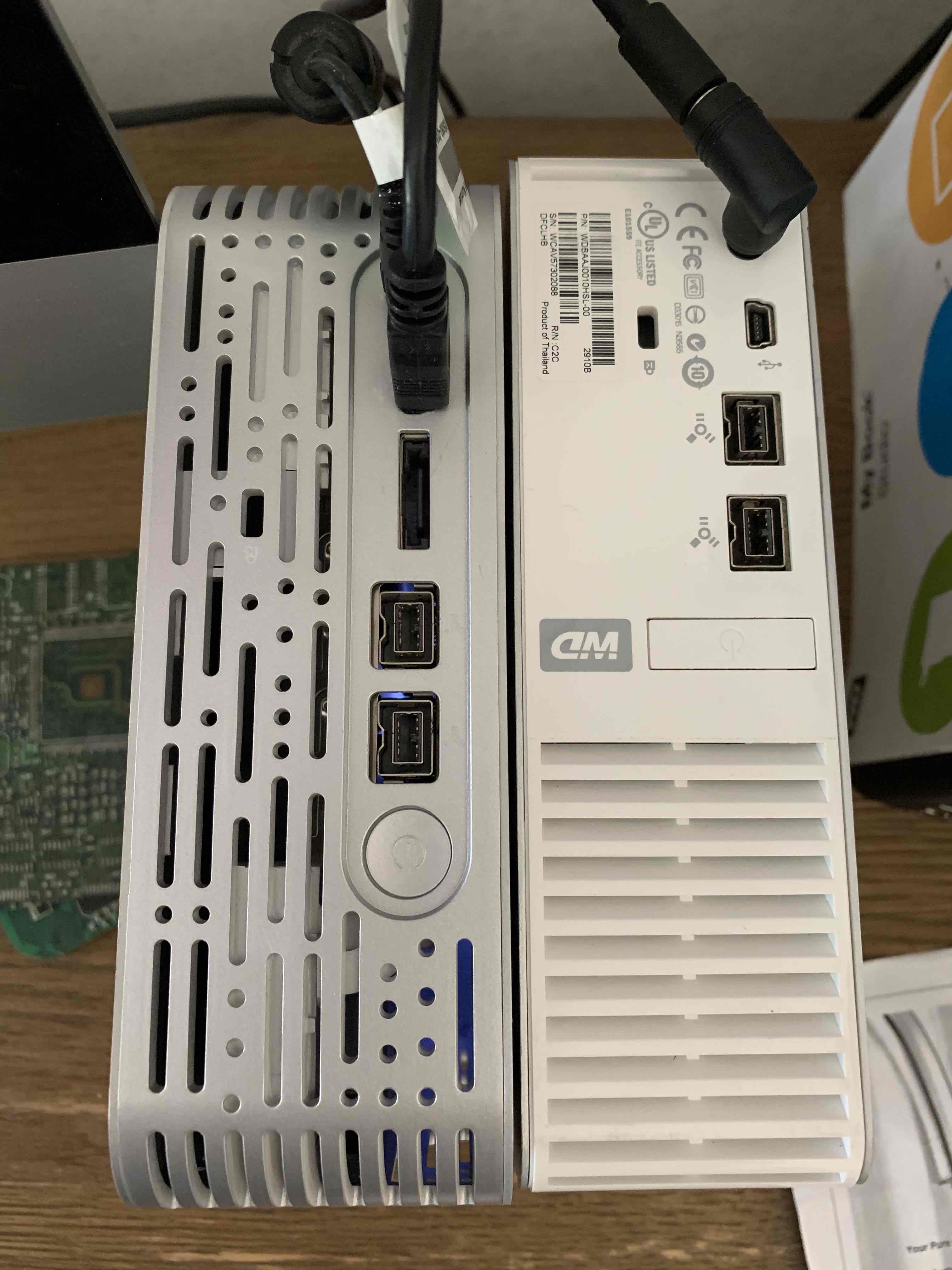

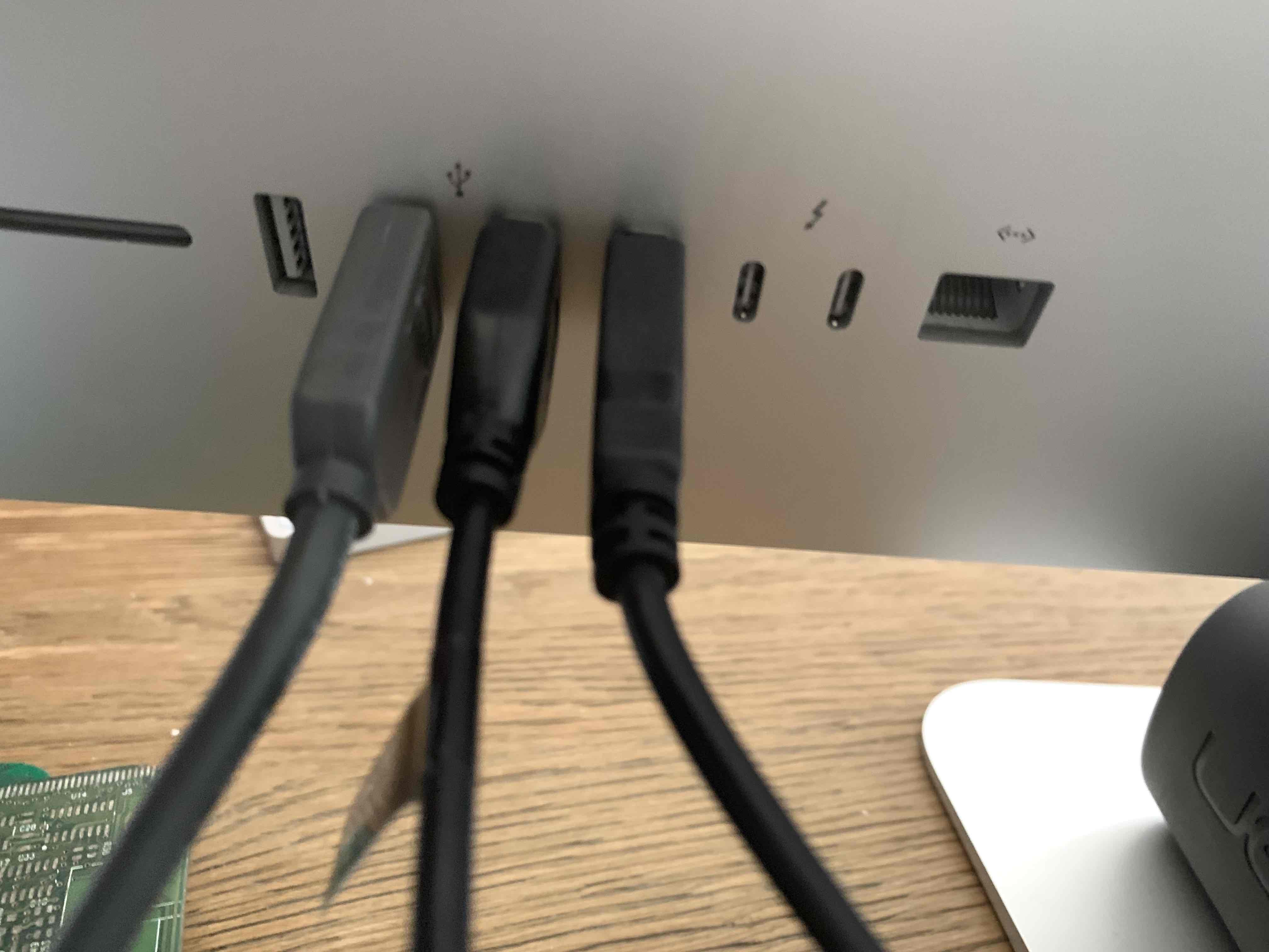

I have 2 external WD drives. I have one connected to my iMac with USB (the only alternative it seems) and connected the second WD drive to the first using Firewire but my iMac doesn't recognise it. Is there any way of daisychaining them so I can back-up the first external drive to the second drive please? I record music to the first hard drive and need to back it up if possible.
I've attached a photo of the back of the 2 drives (left is the first connected to the iMac) and also of the available ports at the rear of my iMac.

You cannot daisy chain using firewire if your first drive is connected to your Mac by USB.
You will need to connect the second drive via USB too and just copy the files across.
You can only utilise the firewire connection if you get a Thunderbolt 3 to Thunderbolt 2 converter and a Thunderbolt 2 to Firewire converter. These adapter cables aren't cheap so really, your firewire is as good as redundant.
I have 6 of these My Book Studios and was in the same boat until I returned my iMac.
Apple has that way of making the hardware you own redundant.
You can buy small (1”) USB C to USB A adapters from Amazon for about $8 US for a pair. Work fine. I was using them until I bought two new drives with USB C connections.
Looking at the pic above of the 2 drives...
The one on the right has a USB port -- you can use that drive with 2017/2019 iMac
The one on the left looks like it has only firewire800 and perhaps an eSATA port?
NO USB ports at all.
To connect this second drive to an iMac with only USBc and USBa ports, you would need TWO adapters:
Mac --> thunderbolt3 to thunderbolt2 --> thunderbolt2 to firewire800
(this way "goes in" through the tbolt3 port)
There's no guarantee it would work, and those two cables will run you about $90 new. Is it worth it?

The drive on the right.
That other port on that FW drive is USB 1.1/2 but it’s one of the mini or micro connectors. There’s 3 or 4 of them–without having the unit in hand, I don’t know which. WD has phone support—give them a call and ask. Once you know, you’ll find the cable cheep on Amazon. You might have one kicking around that you got with an old cell phone or other device – these are often included as charging cable.
You will not be able to daisy-chain the other FW drive to take advantage of that USB port.

Otherwise, it’s the Apple FW to TB adapter, a Thunderbolt 1/2 cable then into the Apple TB2 to TB3 adapter. Good luck doing that for $90 unless you have the space to do without the cable. Cost me more than that to see if my FW audio interface would work with my iMac Pro (it does).
As far as redundancy, Intel doesn’t support FireWire—never did. Apple stopped with the 2012 iMac. The 2011 has a FW port but it’s a builtin adapter that does not support the full FW spec—it can’t since TB doesn’t support it.

  • The "drive on the right" (white) has USB2.0 via the mini-B connector. With an appropriate cable (miniB<>A or miniB<>C), this will connect directly to an iMac.
  • The drive in the "white" housing is old and may be IDE/ATA rather than SATA. This means that if the OP tries to repackage it in a newer housing he should open the old housing first to determine which interface the drive uses so that an appropriate housing can be acquired. There are "hydra" type adapters available which connect to bare drives and have a range of interfaces, such as: https://www.amazon.com/Converter-Ex...drive+adapter&qid=1562351543&s=gateway&sr=8-3
