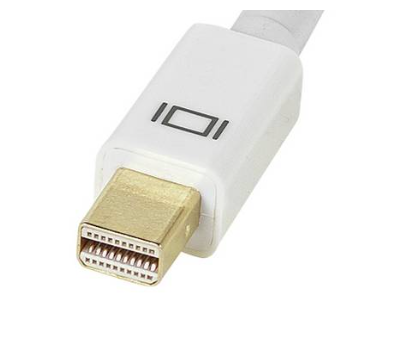

For an official Apple adapter, like the one in the photo, you would probably need to keep an eye out on eBay but I think StarTech one should also work (you'll have to try it as I've never used one), they look like they are still available but quite expensive - approx £100 on Amazon (in the UK anyway).
Good luck with it, I have a 30" Cinema Display attached to my MacBook using the Apple adapter and probably won't change it until the monitor eventually fails.

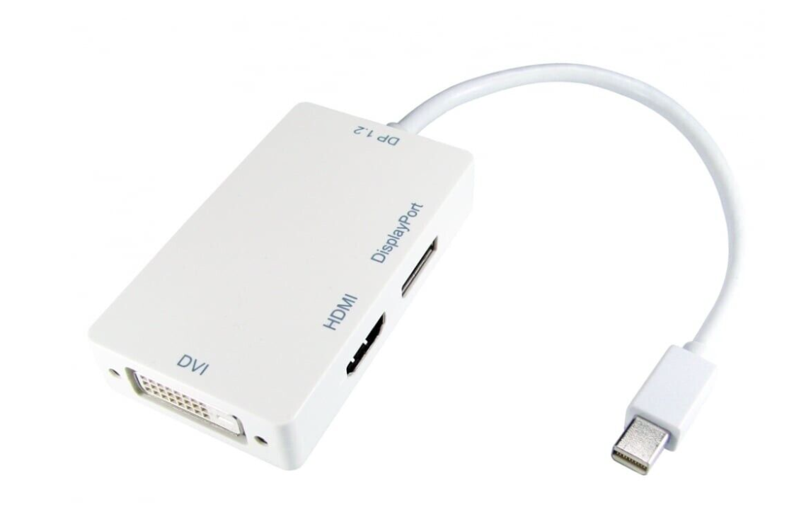

Ok thank you, would this device do it?
No. That would not work. There are essentially two variants of DVI, Single-Link and Dual-Link. Dual-Link is much less common than Single-Link and will require a special adapter. They are unfortunately often quite expensive and there are only a few models available that are known to work properly the way you want to use it.
Here's one from Startech: https://www.startech.com/en-eu/display-video-adapters/mdp2dvid2
And, of course, Apple's original: https://www.ebay.com/p/2255463935

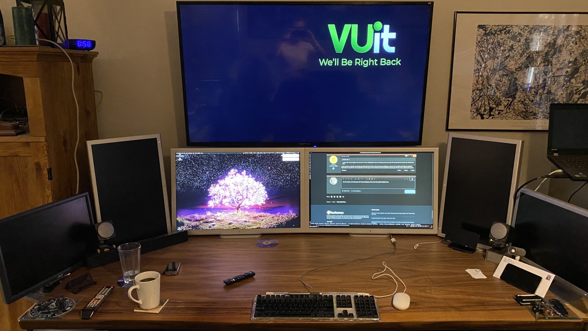

For the record…I am driving two 30" Cinema Displays off my work Mac (2015 MacBook Pro). I believe the 2012 MBP can drive three displays plus the internal, but this isn't possible on the 2015 MBP.
I am using two of the Apple DVI Dual Link adapters mentioned above. The displays are shared with my 2009 MacPro 4,1 (updated to 5,1) via a dual link high resolution KVM switch.
The TV and the other dark displays you see are connected directly to my MacPro. They are not shared to the MBP because the MBP can't drive anything more than these two displays and the internal LCD.

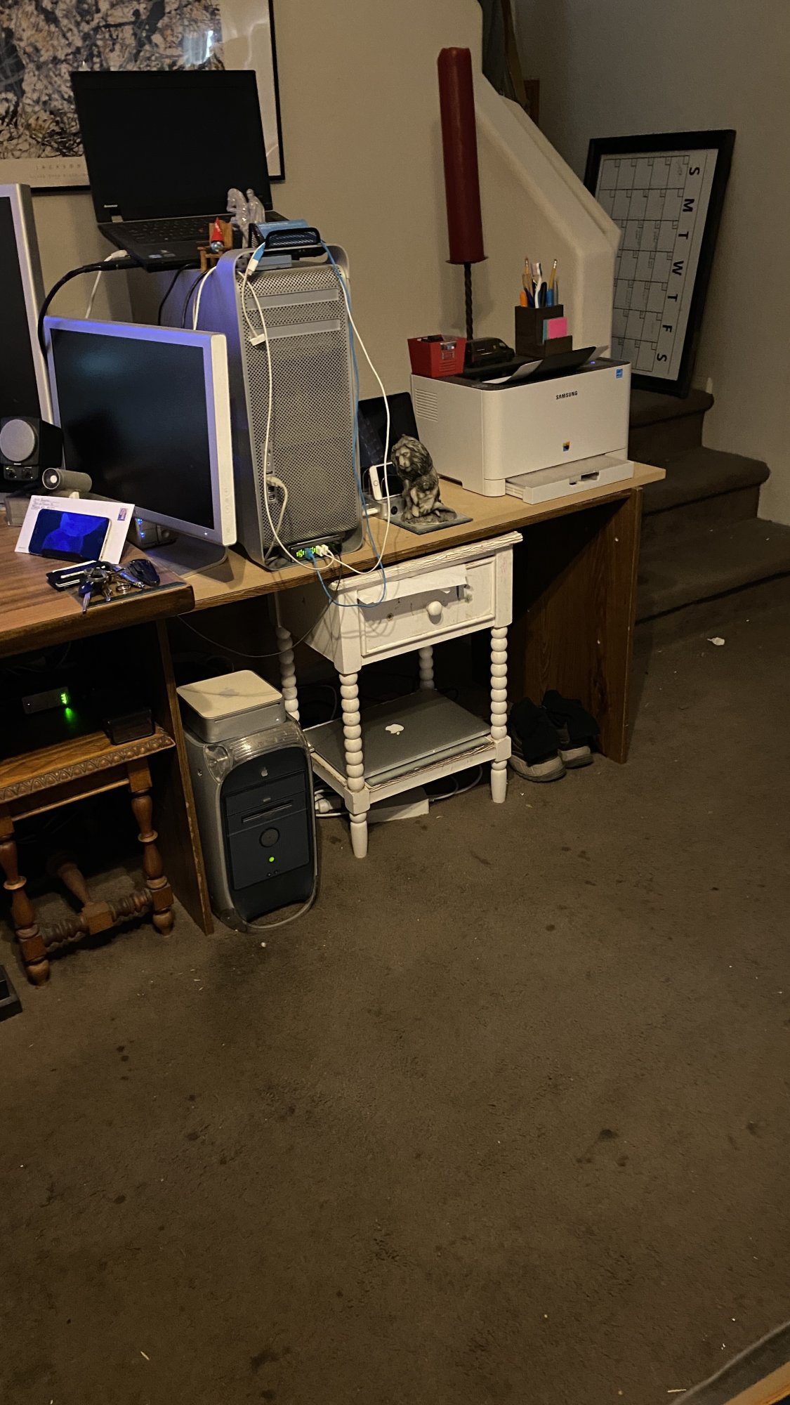

The work MBP is there on the white stand at the bottom. I run it in clamshell mode.

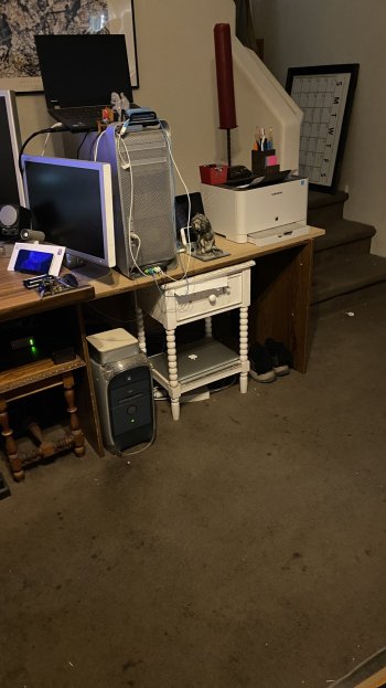

Lastly, I am using a DisplayLink adapter to get that smaller display on the far left connected to my MacPro. I only have two video cards installed with three ports so that was necessary. The adapter is dual port (DVI and HDMI) so technically I could add an eighth monitor.
I just don't have the space.
