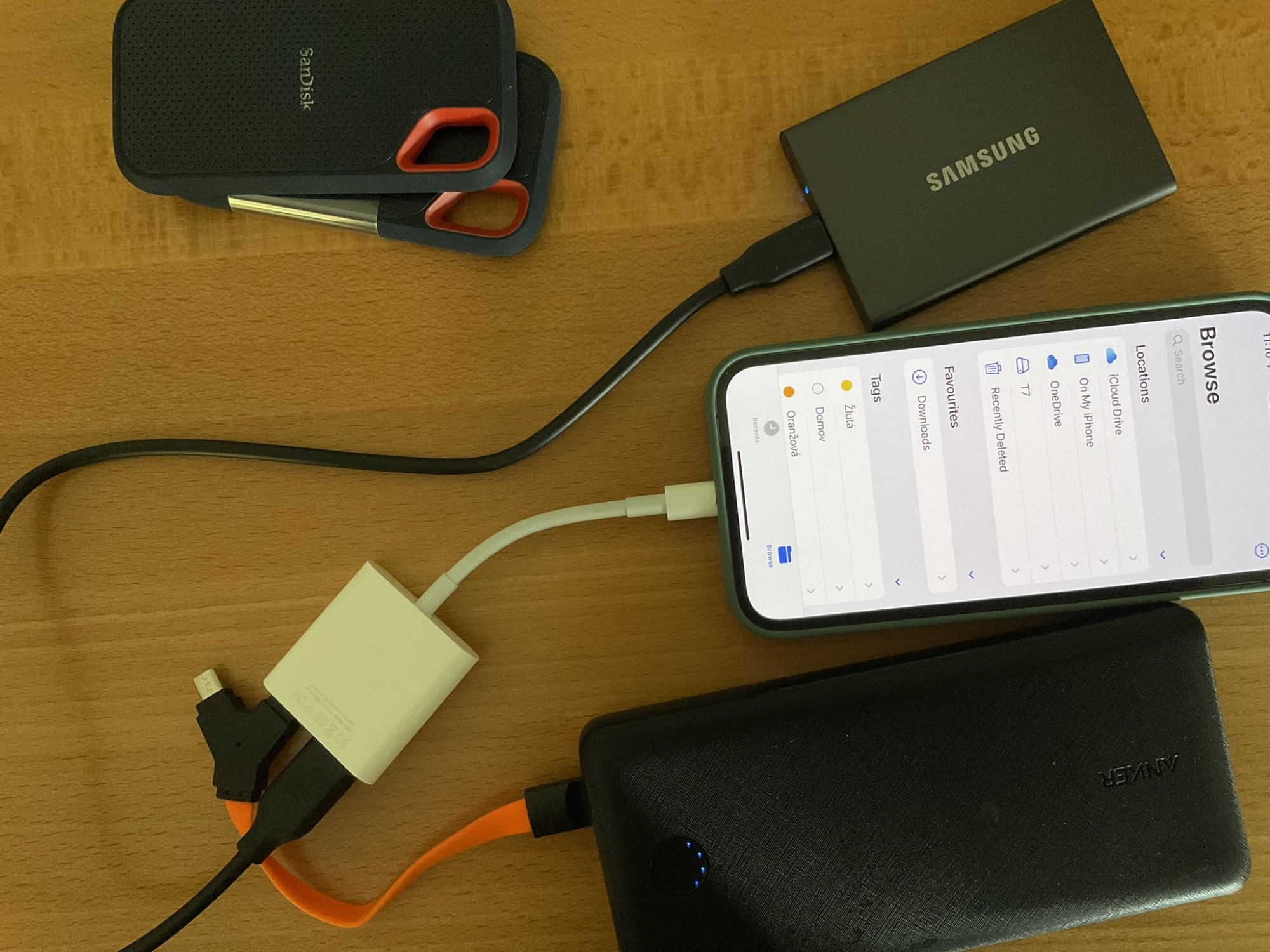

This error message is shown because your external device you are trying to connect requires power in order to function properly. The Lightening or USB-C port on your iPhone or iPad only will make a limited amount of power available to external devices. The error means that the external device you are trying to connect requires mores power than your Apple device can give: the maximum is 100mAh.
The last option remaining and your best option you have is to use a OTG adapter that has an additional power supply port available. This means that there are two ports in total: a data transfer port for your external device, and a power port (which will both provide additional power to the external device, and it will charge your iOS device). Thanks to the external power source, the external device you connect can now draw up to 500mAh, which is 5 times as much without extra power source.
That article says even with a powered adapter (like what you’re using actually), that the maximum supplied power is 500mAh. Kind of a weird measurement for them to use for this use case. What we need to know is how many watts. That will get us closer to answering this question, I think.
Can someone else chime in in regards to the output (wattage) of that lightning/USB adapter?
This article says that a similar SSD (I don’t know if it’s the same one as you OP) can draw as much as 7W (though these types of devices can work with lower outputs, down to a minimum i assume).
@slplss, Using your adapter, try plugging your phone into the wall instead of that external power bank, and then plug in the SSD and see if that will work.

I already tried that 😔. From your previous comment, it would make a perfect sense that the SSD draws too much power and not even the Camera adapter would help it. But as Snørrbjørg showed it works for him with the same SSD and it worked for me, for a while. Most plausible scenario at the moment is that the Camera adapter broke. I read somehwhere the the current Lighting Camera to to USB 3.0 adapter not only supports Pass Through Charging, but also powers the devices connected to the USB-3 port.
I'll hopefully get the final answer when the new Camera adapter and Samsung T7 SSD arrives.

Update: It was the Sandisk SSD, both of them. For some reason, they don't work for me anymore on iPhone (3 initial successful connections out of maybe 200 tries in total). Ok Sandisk, never again.
Samsung T7: not so rugged, but nice metal chasis, two short USB-A-C USB-C-C cables in the package (unlike the SanDisk provided USBC-A adapter I lost couple of times), a nice, blinking blue led light turns solid indicating the drive is powered. Most importantly: it works every single time, no matter the cable and its rotation, and the alignment of stars. As soon as I power on the brick (doesn't even need the USB-C PD ports, Qi USB-A does suffice), the T7 drive lights on and pops up in Files.
Interesting note: unlike Sandisk that tries to (unsuccessfully) connect with the power bank disconnected, the Samsung T7 drive stays off (no LED light), leaving no unsufficient power pop ups. I think this is how it should work. Cancelling my Camera adapter replacement order.
BTW I tried connecting the SanDisk SSDs with the Samsung provided cables. Nope.
Wish I could change my title: Connecting a SanDisk Extreme Portable SSD to iPhone 13 is a nightmare.
Still, having to carry two cables, one power bank and camera adapter just to do that.. is very annoying.

i have that exact SanDisk SSD for my 12 pro Max. works well enough for me.perhaps you got a faulty phone/ssd?
Samsung T7 works with everything, SanDisk works with everything except iPhone. It is a mystery.
