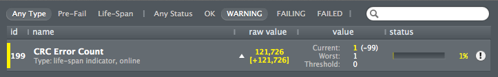

Well after 161 write errors on CCC and a CRC error using Drivedx to test my Samsung SSD completely disappeared in the middle of a cloning.
So it's possible it just completely died.
It is in the drive bay of my MBP and not visible on Disk Utility.

Anyone know what this means?
It says something about the cable being messed up but it's saying that both in my MBP and in the external drive, two totally different cables.
Cyclic Redundancy Check failures. It is indicating that files are corrupted. If that's from a clone, then the source was likely corrupted.

Drive DX is nothing more than an interface to smartmontools. The last time I used it the smartctl version embedded in their application was over a year old. If DriveDX hasn't been updated to support your drive or firmware it will often report erroneous data. You might want to try to contact them.
Like I said before, you should probably try to install the OS, preferably Mavericks onto an external hard drive. If the system works like that then you've at least isolated the problem to the SSD or its cable. If the same problems occur then you probably have some issue with the logic board or connections, or even the RAM. If the SATA cable has completely failed, the drive will not be visible to the system. If you order a new SSD and put it in and you have a bad cable, the same problems will just re-occur.
