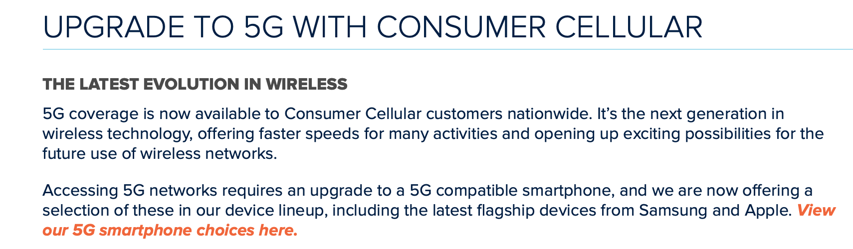

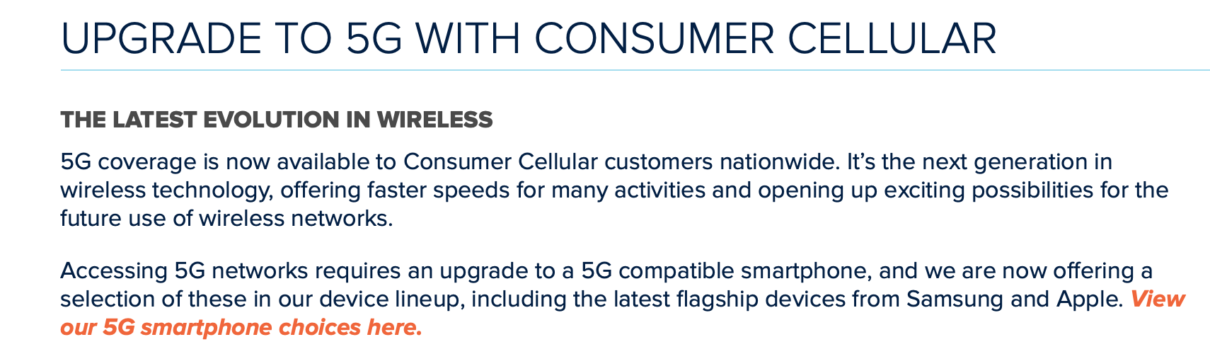

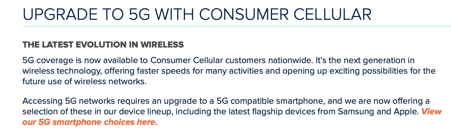

It's interesting that CC goes so far as to "encourage" you to buy a 5G smartphone because they have 5G availability on their network, telling you to "View our 5G smartphone choices here":
Yet there is no information on their website about only certain plans allowing 5G.
Although I personally didn't get the iPhone 12 mini super excited about 5G because I don't currently use any applications that could make use of it, I could see how someone would be very frustrated if they ordered a 5G smartphone through CC, intending to actually access 5G, only to find that they could not.
