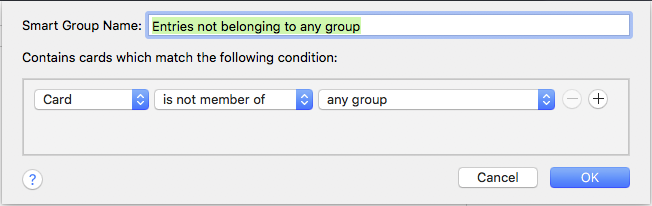

2) Then ensuring every entry was part of at least one group. I did this by creating a Smart Group like this:
Seeing that there were no entries in this Smart Group I moved on to the next step (if the Smart Group had some entries in it I would have put them in the existing groups (or some new ones) just so that no entries were "orphaned).

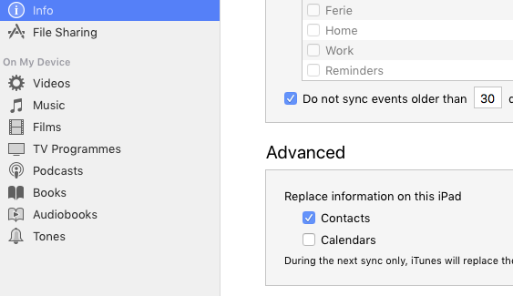

10) now, in iTunes, ensure that on the right hand side, go to "Info", and ensure that "Sync contacts" in turned on (enabled)
If the iPad already contains some contacts you might also want to scroll down to the "Advanced" section of "Info" and turn on "Replace information on this iPad: Contacts" so it'll be easier to see what's going on.
