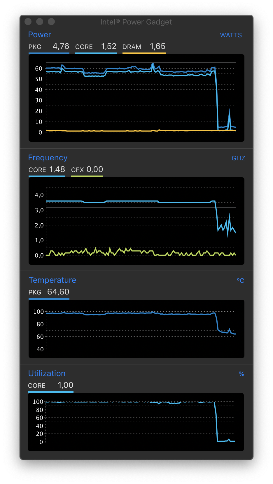

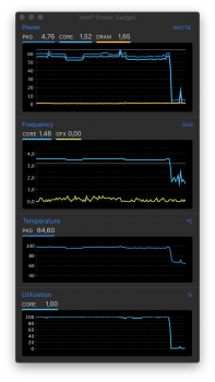

I just did quick experiment. Removing bottom cover increases 12-core "yes" test from 3.7Ghz to 3.8Ghz.
Not much, I agree, but it may indeed suggest that a larger/faster fan would make a difference for long/heavy renders.
Reactions: tagumcity and Ploki
Intriguing though...your CPU wattage is lower. Do you have anything drawing power from the mini? Could it be the TB hub inside the LG display...?
indeed it's the LG and maybe the drives? i get 3.5 stable when running the LG, however if i disconnect it it jumps up 🙂
edit:
just to clarify, i'm happy with how the mini performs.
Interesting result - thanks for posting! It's not obvious that external items would power limit the CPU. It is something some people will like to be aware of. i.e. Time critical render tasks should be run headless.

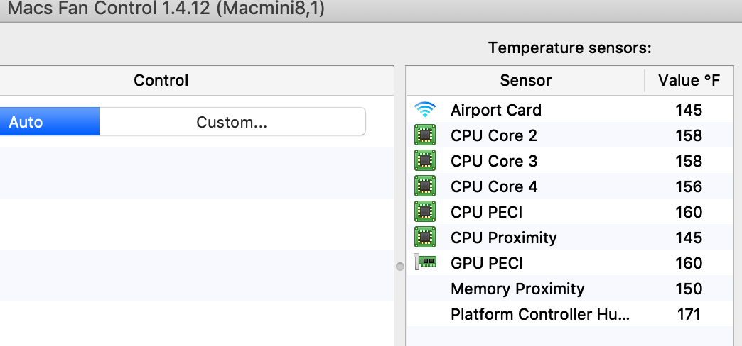

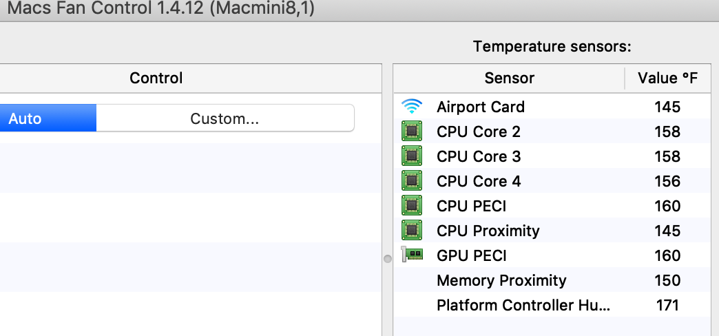

My i7 MacMini w/32GB RAM has been slowing down recently for no reason. It gets super hot and performance begins to slow down. I downloaded a temperature app called Macs Fan Control and I cannot believe the results. My biggest fear is that something went wrong during the RAM upgrade.
Have you checked activity monitor to see what is hogging the CPU?
What are you running to achieve those temps, they aren't that hot. The temperatures are around 70C that isn't that bad.
