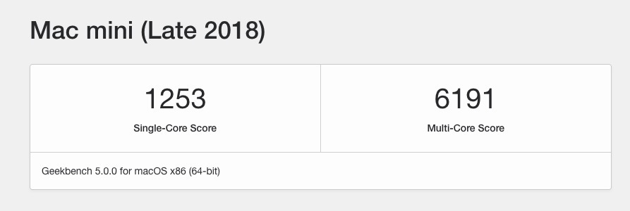

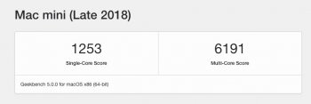

Just did an application of Thermal Grizzly Kryonaut on my new 2018 i7 Mini while upgrading the RAM. No additional cooling, yet. But I'm looking at doing one of those coolers from Ali Express with a Noctua NF-A12x25 fan in it.
9to5 Mac must have had a bad batch of kryonaut or something as well, since on my first Cinebench R15 run, this system scored 1210 without any additional fans. Just the kryonaut application. Sure, it's still throttling some, but not a terrible amount. The noctua setup could help out even more...we'll see. 🙂

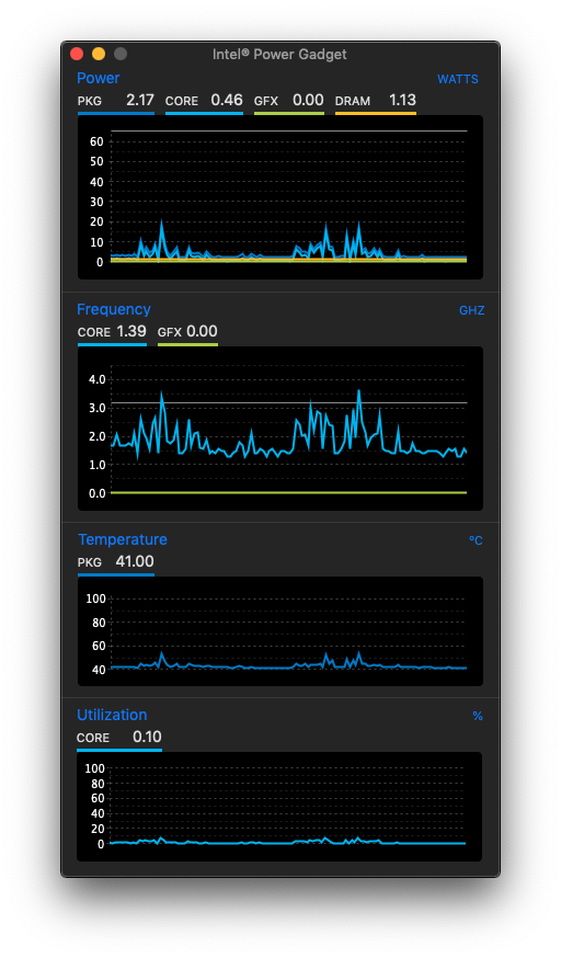

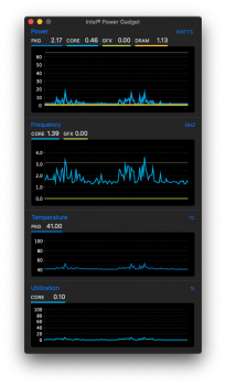

The power gadget screenshot shows your cpu idling, not throttling, so what do you mean it was throttling some? it shouldn't throttle at all, specially ater using top notch thermal paste. do you mean it doesn't turbo all the way through the test (which is normal)? throttling means it will go under your base clock. Did it actually? (sorry if it's obvious for you but it's a bit confusing)
Reactions: dabotsonline
You have correctly identified this was illustrative of idle temperatures, not load temperatures. 🙂
It was hitting 100C and downclocking during both application usage and benchmarks. I come from the land of servers and workstations where any reduction in turbo boost speeds due to thermals is “throttling.” Regardless of it throttling from a turbo boost speed, throttling is throttling.
I get that we like being pedantic about that here, however when the CPU keeps hitting 100C and reducing its speed, it’s “throttling” from its max turbo boost speed, which while considered “normal” as one is only promised the base clock, is sub-optimal from a maximum potential performance standpoint.
I agree. Given a more robust cooling solution, at peak usage, the CPU should be able to maintain its full turbo clock. However, this is a small, compromised desktop design. I knew that coming into it. 🙂
In many systems (HP workstations/ ProLiant Gen 10 servers, for example), the single core turbo boost speed may be applied to all cores because the cooling solution can maintain the TDP of all cores fully boosting at max load, without “throttling” from max turbo boost.
All that being said, I’m very happy with the system for the price I paid, and I’m happy with the noise/form factor/cooling and performance compromises made. The Kryonaut helps reduce temps somewhat, even at idle.

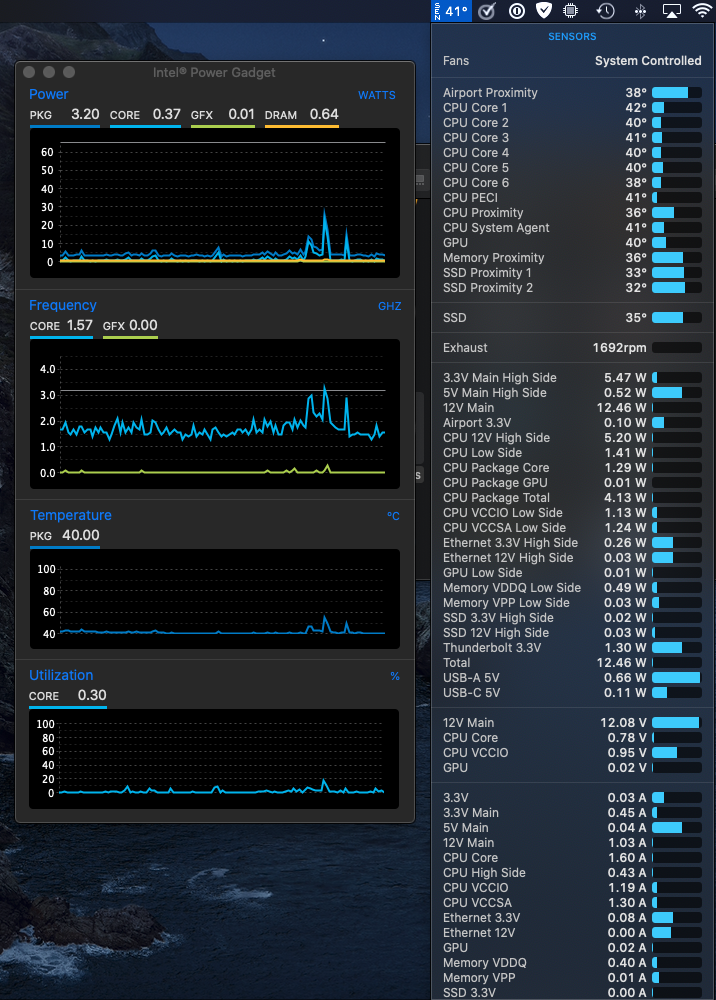

I'm looking for CPU temps, before and after. As well as what clock speed it's running at before and after. The case being warm doesn't really matter.
The Intel power gadget will show temps and clock speed and load. Macs fan control will report all the temp readings of the various sensors inside.

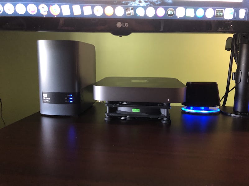

I am surprised that nobody has a product out there that allows you to remove the bottom cover and attach a good fan. The design has been about for so long now and it would be a popular purchase I suspect.
I have one of these. It covers most of the bottom and is very steady.
https://www.amazon.com/gp/product/B00MWH4FL4/ref=ppx_yo_dt_b_asin_title_o02_s00?ie=UTF8&psc=1
I purchased a smaller one to exhaust my My Cloud EXT2 Ultra, to cool my HD’s.
