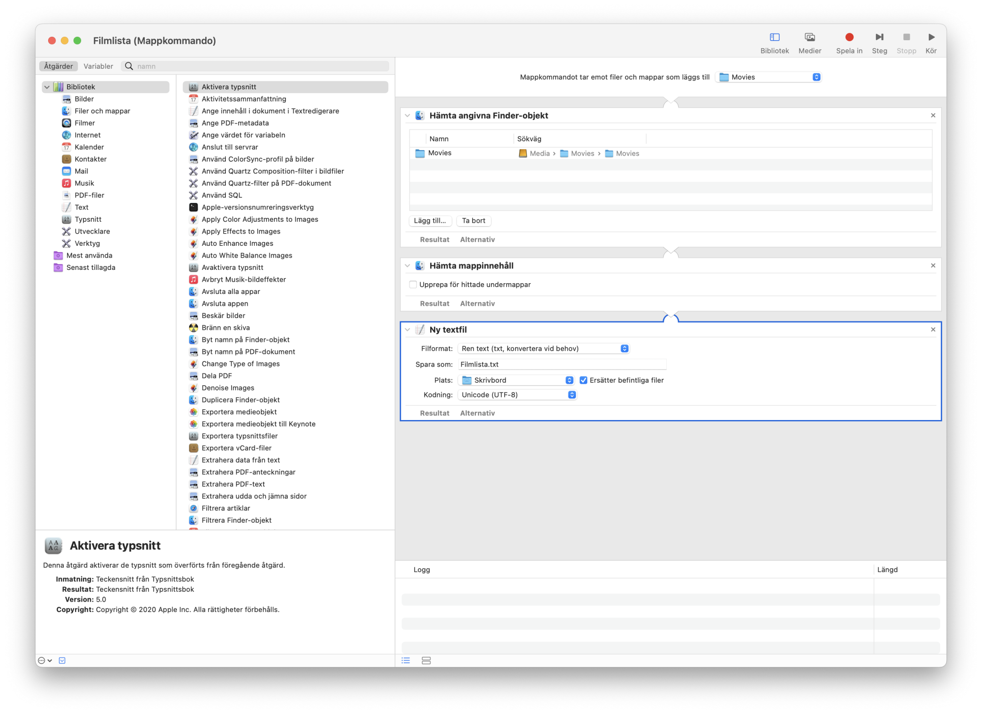

I ended up doing this which does what I wanted.
Listing things in a folder and putting out a txt file.
Everytime there is a change in the folder.
Thank you for putting me on the right path.
