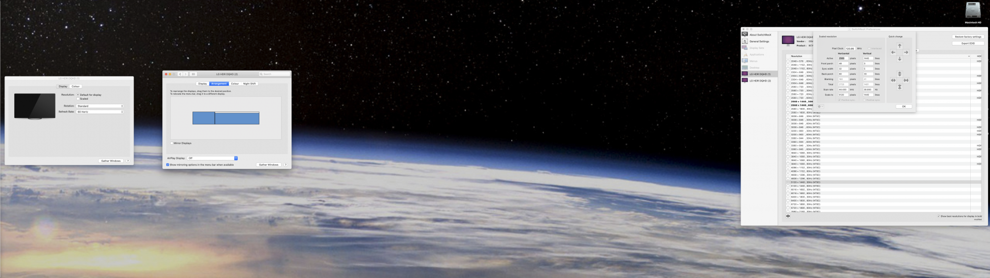

Oddly when I put the Mac into 5120x1440 mode and capture a screen shot it's "correct" (see second screen shot) - so whatever the problem is seems to be downstream of what the windowing system is presenting to the graphics driver.

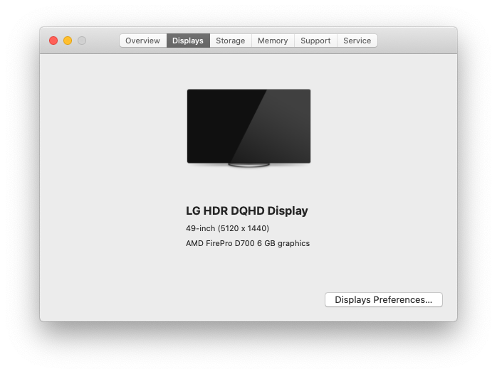

My concern is that I am not 100% certain that I am getting the pixels I paid for - oddly the screen is being detected as a 5120x1440 screen (see attached) but I'm not confident that I'm getting as much screen real-estate as I was expecting.

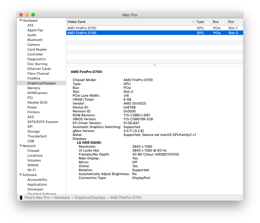

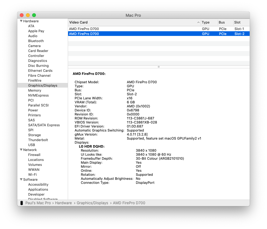

Forgot to add the system profile for Graphics/Display which shows that the screen is being used at the lower res as you would expect (and oddly 30 bit colour)
