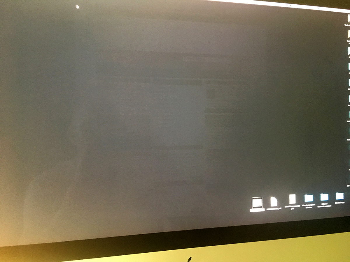

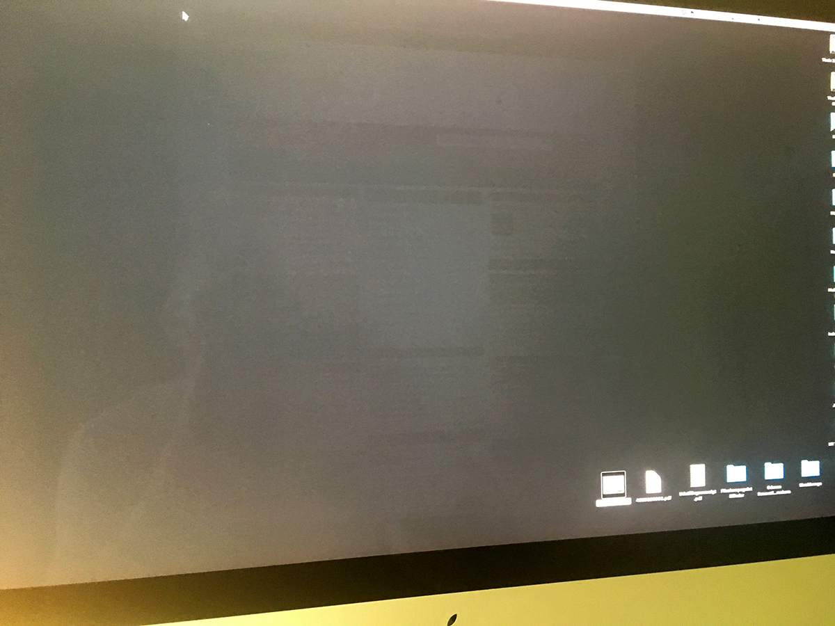

I experience very clear retention/ghosting on my 18 month old iMac 5K. I am shocked that Apple says that this is normal and should be expected. The image below shows the retention/ghosting from a browser window that has been open for less than 5 minutes.
I have talked to Apple Customer Service (over phone as it was bought online). They tell me that retention after only 5-10 minutes is to expected. So if I hand it in for repair, I not only have to do without my Mac for days, but will also have to pay a danish kr. 500,- (+/- $100) fee as they hand it back, having only found what Apple says is to be expected.
In your image it looks like the retention is only visible as a reflection. Is that really the case? Do you still see it in a dark room?

This is a problem that started when the iMac was 16-17 month old. It only occurs when the iMac has been on for 1-2 hours, so I expect the temperature to be the source of the problem, even though the back doesn't feel any warmer than normally. The fan functions and can't be the problem.
I have talked to Apple Customer Service and explained what I experience. They say that this is normal and it is to be expected. They refer to an article on apple.com http://support.apple.com/kb/HT5455 and http://support.apple.com/kb/HT2807 that you should use the screensaver to prevent this from happening. BUT that makes no sense when the problem already occurs when the window has been open 10 minutes.
(PS: The reflection on the screen is of me taking the photo. The retention/ghosting is not a reflection and can be seen in the dark)

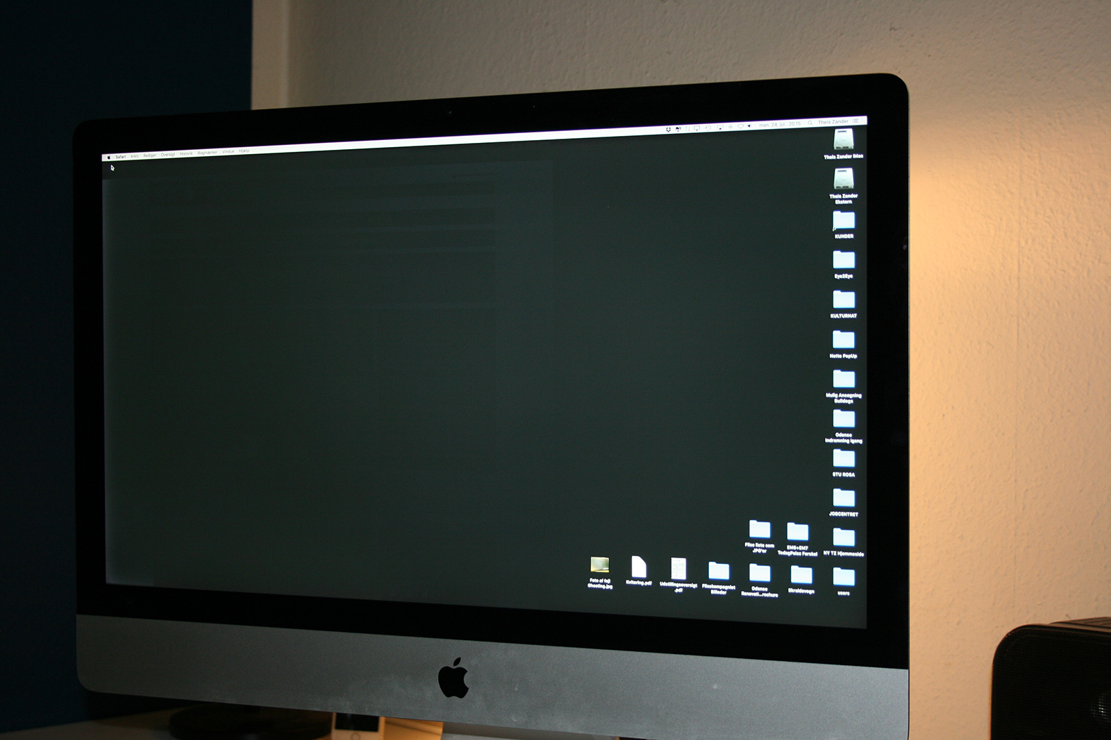

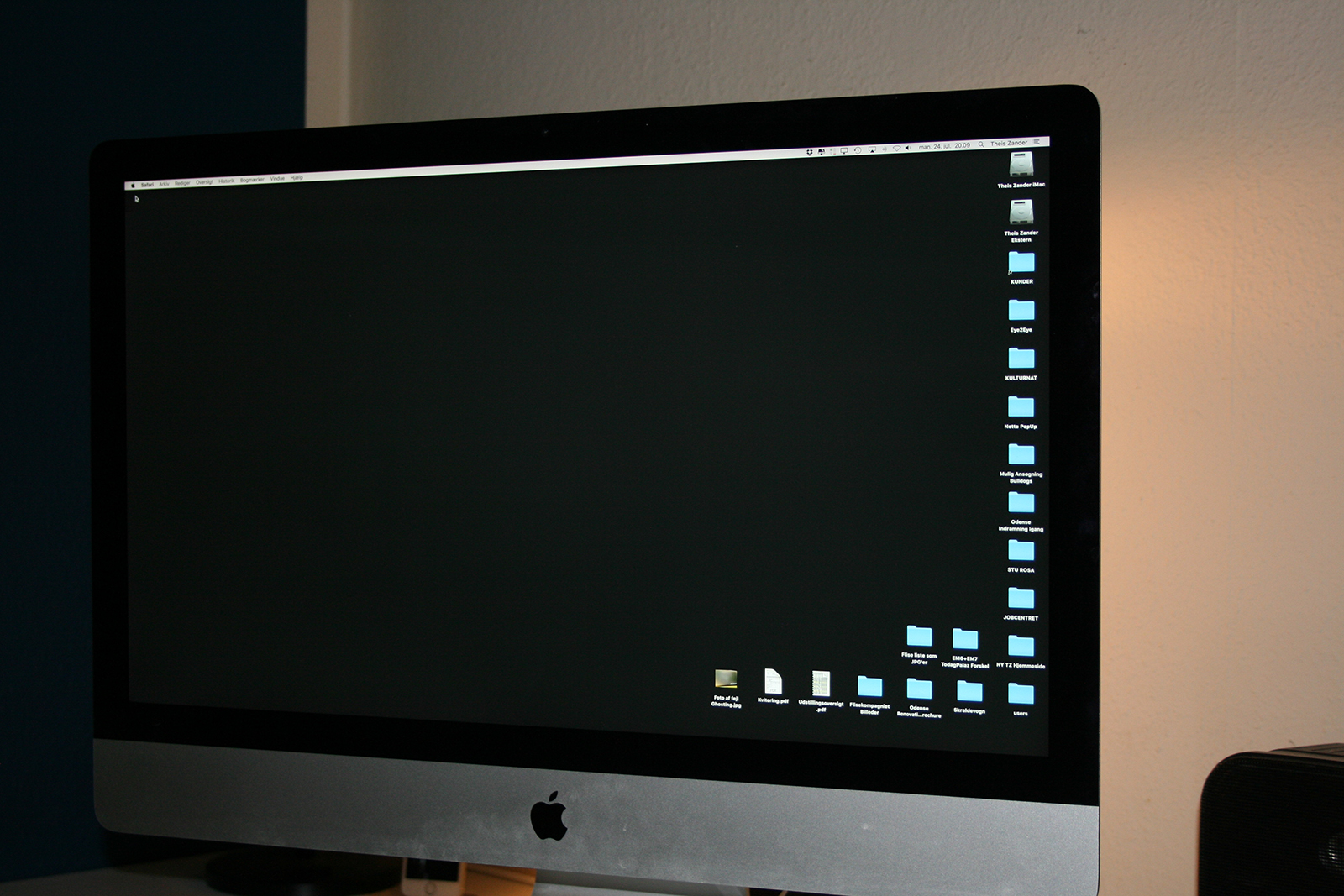

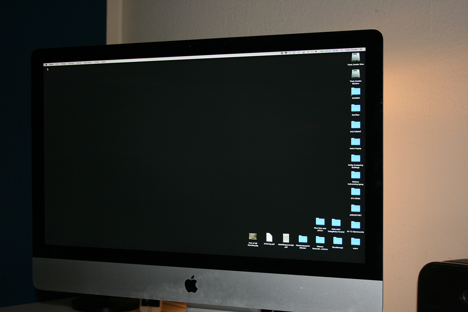

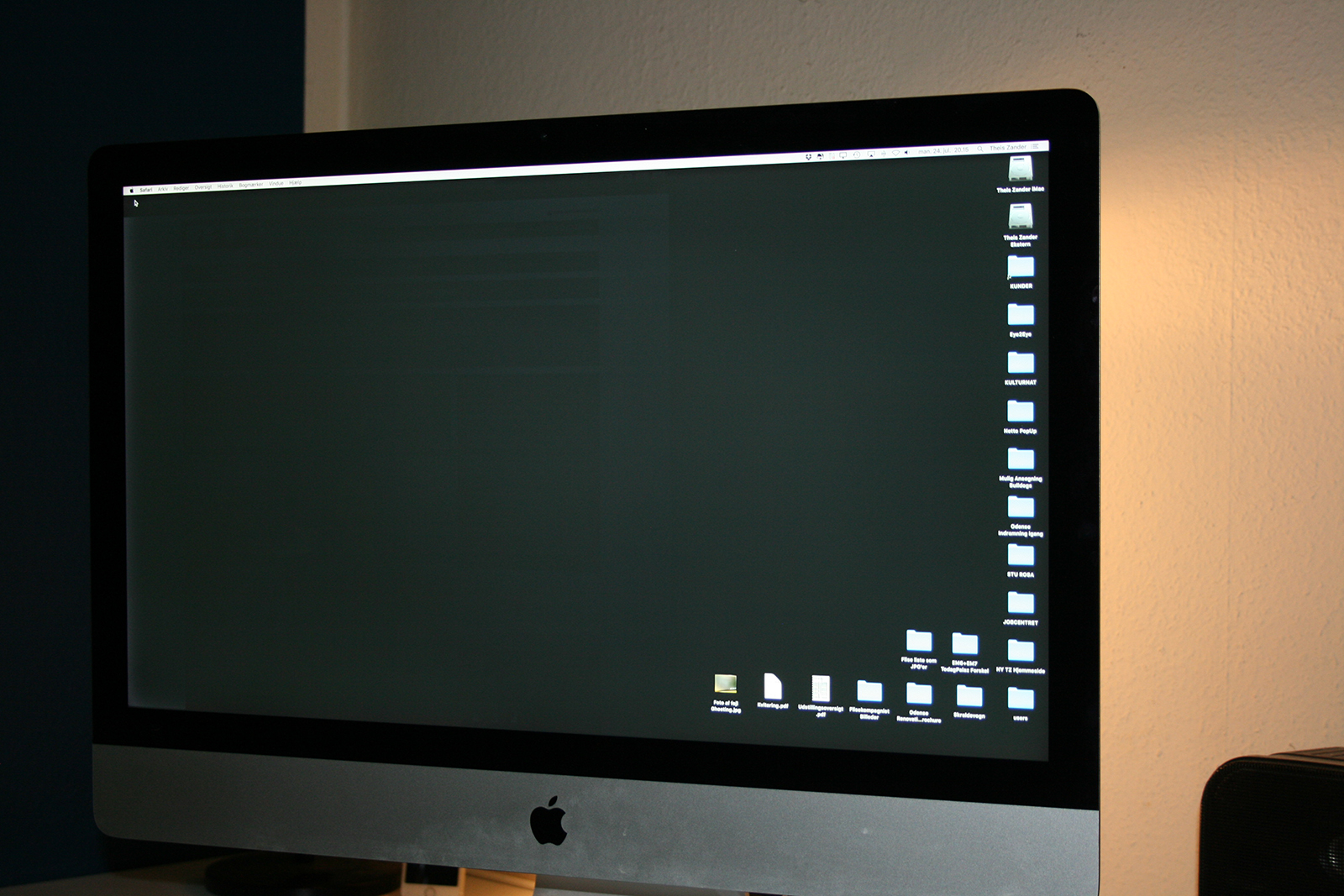

Here is a long explanation because some has talked about reflection and even about the previous being manipulated:
It is really difficult to photograph the screen, as it is emitting light (just like it is difficult to take pictures directly at a light or the sun) How the photo ends up, depends on where the camera focuses - the lighter folders, or the dark desktop.
If the camera focuses on the desktop, the retention shows up as it is seen in real life - just like the contrast between the dark desktop and the black frame of the iMac is as it is seen in real life.
So here is a couple of photos - one with correct folders but a almost black desktop and one with to light folders but correct desktop AND almost correct depiction of the retention. In real life the retention is even more noticeable.
Interesting. Your two photos appear to be at different angles-- was that the only thing you changed? Or was the room lighting or background changed?
I ask because if it's only visible through screen reflection, you'd solve two problems by reducing that.
What? The two photos are at exactly the same angel! I really don't know how you can see it differently.
The problem with RETENTION on the iMac has NOTHING to do reflection!
The retention can be seen very clearly in a totally black/dark room with NO source of reflection.
The second picture is just to show that it is difficult to photograph a monitor because it is emitting light.
The retention is still there in photo 2 - its only the camera that can not catch the screen as it is in real life.

Ok, good to know. That distict grey shading of the top image is probably a black-level difference in the camera's auto-level.
An interesting test would be to look at a pure-black screen with the lights off, since it should photograph better. (create an all black .png image, view it in Preview, and zoom to full screen)
There is no problem getting rid of the retention - it disappears by it self after 10-15 seconds.
The problem is that it reappears if I f.ex. have a browser window open for only 5 minutes, and then close it.
