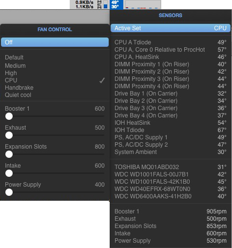

you may get a benefit from installing a fan control app like SMC that you can set presets for and keep your CPU's cooler than the system would left to its own devices...
I always thought that iStat Menus already had some fan control included. Do you suggest SMC in addition to iStat?
picture.php
For me i can get faster access to the presets on SMC than iSTAT but thats the only benefit.

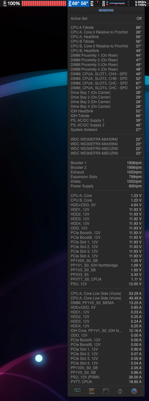

Hi everyone,
since I have a dual X5690 system, I have checked my temps (all in °C by the way).
My temps were a little bit higher after the initial installation on CPU A, so I decided to reapply thermal paste a few months ago. I used MX4.
They came down quite a bit, and I think there OK now.
Anyway, I was running a 15min full blast. Fan settings were not changed (system default), ambient temps are about 23°C...

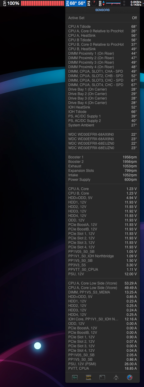

Anyone know why in istat 5 when you adjust the booster on either a or b it reads it as double so if i adjust both booster a and b to 1500 it will read as 3000 on both a and b on the dropdown menu
Did you modify the custom "Medium" setting of the fan rules? Try to add a new set and modify this to your needs. I think the "Medium" setting of iStat is somehow broke. It is configured with 2300 rpm for CPU A and 3000 rpm for CPU B. If you modify the rpm setting for CPU B it will nevertheless let the fans spin at 3000 ....
I set up a new one and that appears to be working as intended.
After reinstalling the heatsink with a torque screw driver I can report back that everything is running cooler now.
Temperature difference between CPU A and B between 1 and 7 degrees (1 at startup, 5 at light usage and 7 under full load). Temp difference between CPU and heatsink 15 degrees under heavy load. Both heatsinks warm up. Without fan rules modification i get low 70 degrees C under full load (handbrake) on CPU A and if I increase both CPU fans to 2400 it cools down.
Machine is still amazingly quiet.
Under light usage both CPUs are between 40 and 50 degrees C and I think I do not need to modify the fan speed. That means I have the same level of sound emitted as with my 2x 2,4 GhZ setting.
Under heavy load I increase the rpm of the fans slightly (CPUs > 2300 and the rest >1000-1100) in order to have a lower temp, but the machine is running still at almost the same sound level when stressed out.
So anyone who is interested in putting two X5690 in their MAC PRO: yes you can, and yes it will still be the same quite machine you bought.
I would like to thank @h9826790, @lexR and @JronMasteR as well as all the others for their support!
