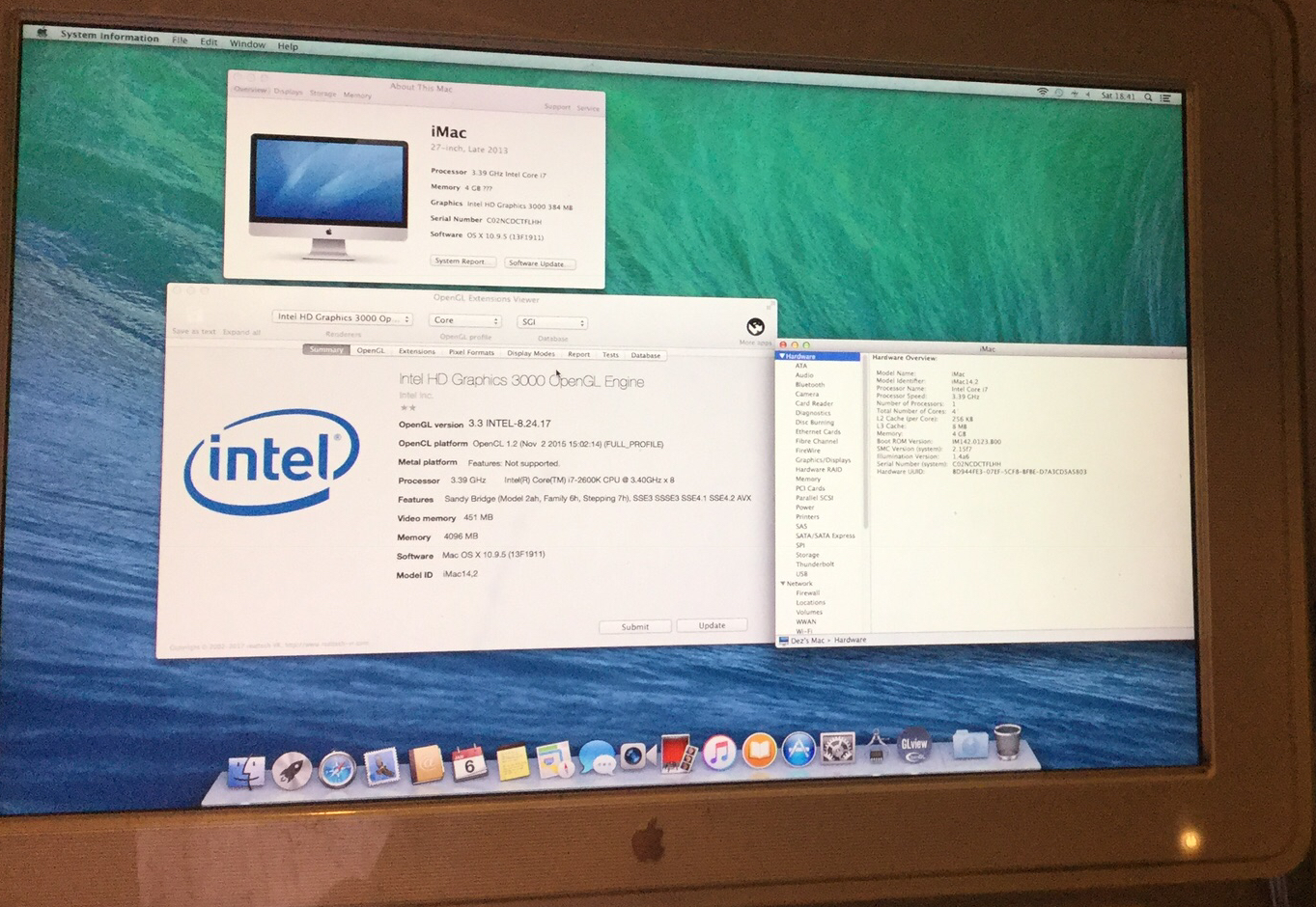

I can easily tell you why the ??? in about this mac, about this mac does this when it (System Profiler) cant detect any memory modules so cant fetch any information about them to feed to About this Mac,
what I dont know is why the 32GB Memory stick does not show up at all to OS X/System Profiler anywhere despite it clearly working in the Mac Pro 5,1, the only other time I have seen this is on a Hackintosh I made/was playing with a few months ago (in the Hackintosh case the way I solved the issue in the end IIRC I just moved the Memory stick to the other slot, motherboard had 2 slots and i had just 1 4GB stick installed)

it wouldnt work in an imac because the memory for the mac pro is a totally different type of chip. imacs use standard desktop memory and a standard desktop chipset, whereas the mac pros use either ECC or ECC/Registered memory and server chipsets. The imac chipset simply does not have the hardware necessary to work with those kinds of chips. the ??? is probably because the presence of the 32gb chip is preventing it from properly reading any memory information including your 4GB chip. We've seen cases like this in a datacenter when people arent paying attention and mix and match memory types.
Seems some misunderstanding here.
That's a Hackintosh ident itself at iMac, but not an iMac. The Late 2013 27" iMac won't use i7-2600K.
The Mac Pro just can support ECC memory, but not necessary use ECC memory.
If install ECC memory on a normal PC, the computer shouldn't boot at all, but not present some ???
The 32GB DIMM was installed on the cMP, but not in that Hackintosh. That Hackintosh only installed one 4GB DIMM. And the same module didn't recognise well in one of the slot 1, but works good in another one.
