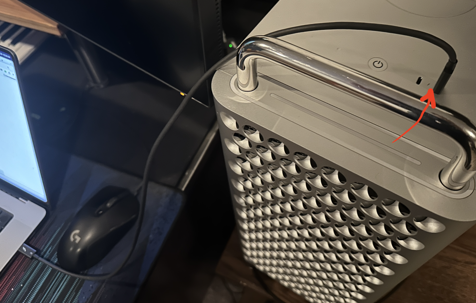

  1. Have a second Mac, Apple Silicon works fine. I used a M1 Max. Get the Apple Configuration utility.
  2. Connect your Macs together, use the right most top port (away from the power button). I used a Thunderbolt cable because it was the first thing on my desk

  3. Unplug the Mac Pro. The trick is when you yank the power cord, you'll hear a "ding". At least mine does, that means waiting all of about 2 seconds.
  4. Hold down the power button and plug in the power cable. Count off to about 5.
  5. You will not hear any fans spin, the light will not change or receive iany confirmation that the Mac Pro has booted, check your other Mac in Apple Configuration utility, it should display the dfu screen.

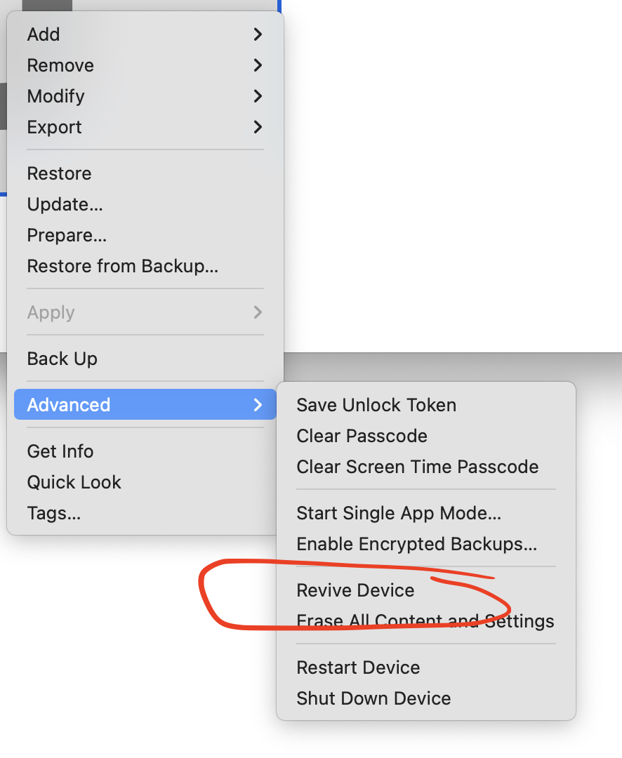

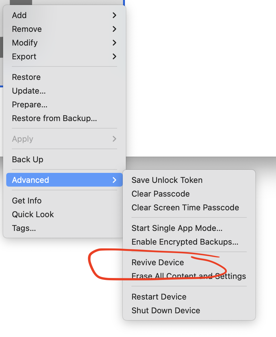

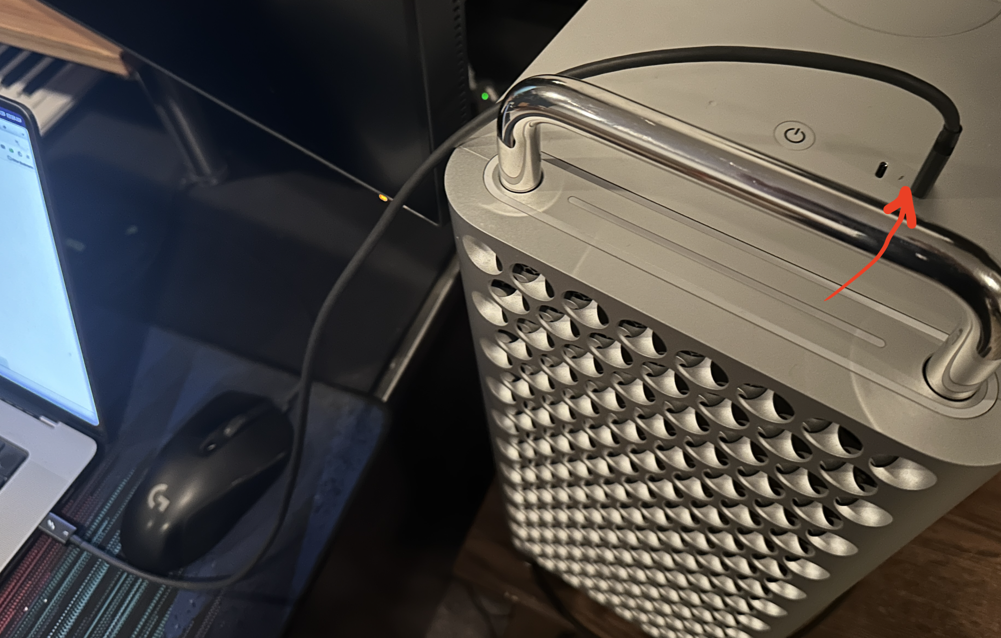

  6. Proceed as planned. Right click in the configurator, and go to advanced -> Revive Device.

It went fast, I'm on FiOS but it was all of a minute or so to restore.
