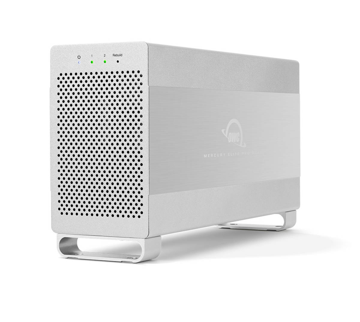

The last RAID enclosure I purchased was two years ago, a Mercury Elite Pro Dual. I got mine off eBay, but am providing the link so you can see what it looks like.
I also have a Fantom Drives Data Dock II, one I bought several years back. These are great, but much harder to find now.

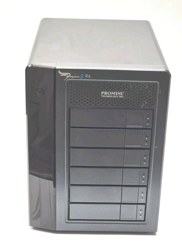

It looks like the Pegasus is the one to go for because despite being used, older and discontinued, the spec is superior.
Bought it!
Listed as £250 GBP but I received an offer of £235, which I accepted. It was the best price that I saw on eBay for Pegasus RAID units. All of the others within the same price region were either older TB1's or had less drive bays, so I think that I did alright. :)

The R6 has arrived!
There's no Thunderbolt 2 cable provided but I expected that - so I pre-emptively ordered a 2 metre one from China. That amount of length will allow me to stash it away from my already cluttered work area. However, it was pretty stingy of them not to throw in a power cable but again, that's not an issue because I have plenty on hand.
Now I need to work out which drives I'm going to use and where I'll obtain them from. :)
