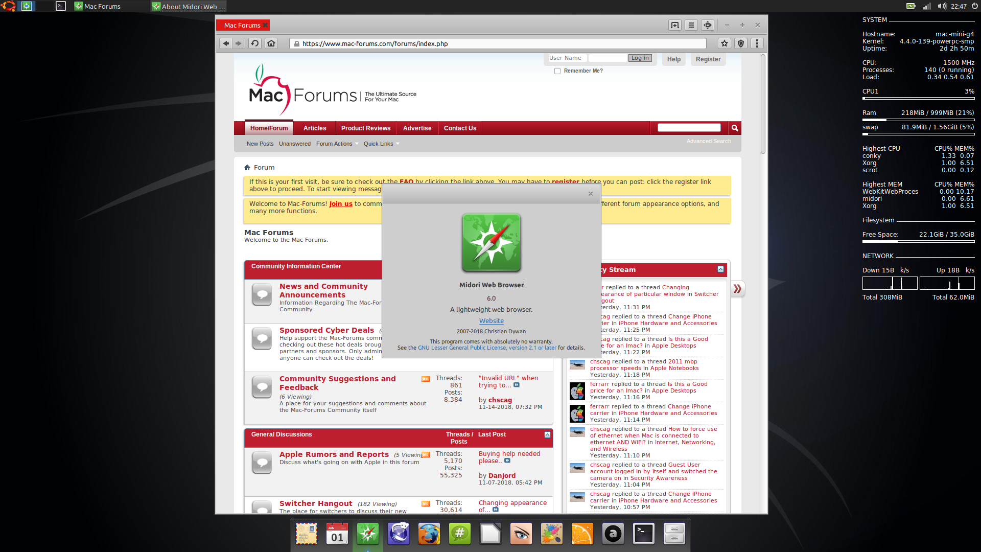

Midori 6 (web browser) is out, and I will attempt to compile it for sid once my move back home is complete. I know it can be compiled for PowerPC, but there are issues with certificate management, and Midori 5.11 on PowerPC is built without gcr support. GCR is now built and working in sid, so there's only one more issue to get around, and that is an error while configuring the build. I have a theory that it's actually an issue with the syntax of newer builds of cmake clashing with older syntax (the error is "add_custom_command Wrong syntax. A TARGET or OUTPUT must be specified." in ValaPrecompile.cmake), and will try to figure out how to get around this even if it means opening a new bug report. I compared the file from 5.11 to that of 6.0, and they're identical. My attempt to build this a few weeks ago has failed so far due to this error, and I'm not exactly a genius when it comes to figuring out these sorts of issues.
If someone else wants to give it a go, the source is here: https://www.midori-browser.org/download/
Well.... It built on Lubuntu without issue. Using it however is buggy. Some pages load, some do not. I have to disable JS for it even load anything. However, the pages that do load (MR is not one of them sadly) it's fast. I tried to build with /opt for install prefix, however it couldn't find it's libraries until i rebuilt and used /usr. Anyway, here it is if you want to play with it. I backed up /usr/bin/midori and /usr/lib/midori before i dropped this there. https://drive.google.com/file/d/1GyfGS70gpI58GU-vuwTxo64CdfDFy3jC/view?usp=sharing
Cheers
Cheers
Ahh that's too bad. it would have been cool to have another up-to-date browser for PPC linux. I don't suppose filing a bug report would do anything, unfortunately.
Cheers
I got it to build as well, and you're right. Nothing seems to work. Too bad...
