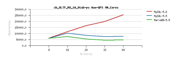

Performance drop-off with high amounts of cores are something that is discussed quite a lot among people who work with database optimization. Depending on the specific database, there is different points in cores where you only see a tiny increase in performance if you go above it. As an example of this see the attached graph which is from a benchmark of three different database software being tested. Notice how two of them not only don't gain any performance after 16 cores, but they actually get lower performance when adding more cores. This is just an example and not directly related to the iMac, but it does show that software needs to be highly optimized to really utilize large amounts of cores and threads. And most desktop software have never been optimized to run with the amount of cores we're starting to see in regular computers. Just a few years ago 8+ cores were only seen in servers or high-end workstations - Not a regular desktop computer such as the iMac.
So the point still stands - It's not just a matter of more cores = better performance. Which is the entire reason why it's a point worth discussing and for people really to consider. Not only their specific workload, but also the specific software they use and whether they will get a benefit by having 10 cores at a lower base lock or fewer cores with a higher base clock.

Every time you add a core you are not getting a linear increase in performance in most situations.
Sure. Basics of parallel computing :)
