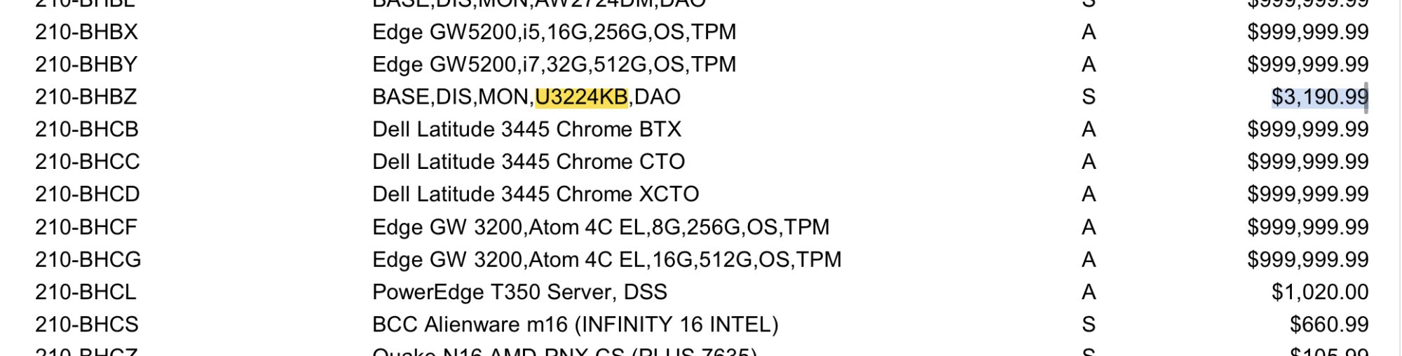

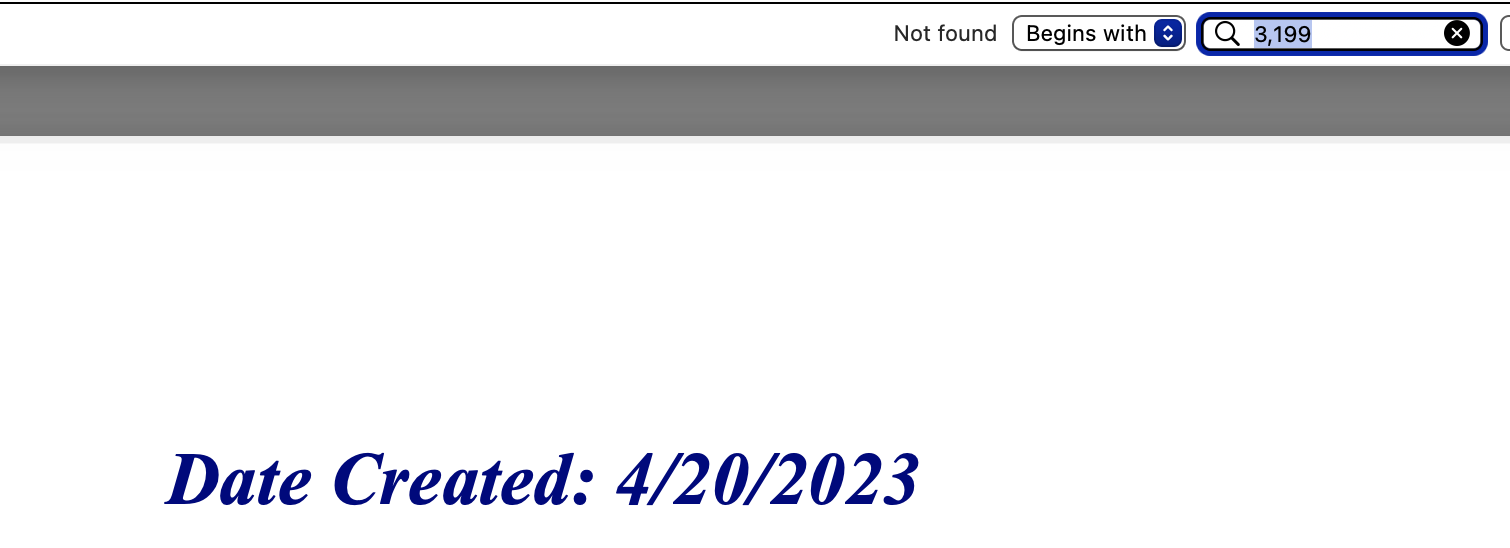

MSRP ($3,199) and spec sheet are up.
Let the discussion begin!
There's no hits for 3,199 in that pricing document Where are you seeing it? What's the SKU?
rumz
macrumors 65816
Feb 11, 2006
1,218
633
Utah
There is actually. I had the same issue until I realised that the search field doesn't go through all those 20k pages or so.
What I found was actually 3,190.99 rather than 3,199.99, but that almost seems like a typo huh. Would be a slightly odd price.

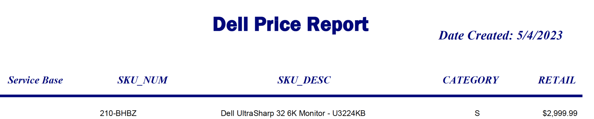

Today's update of the MSRP price list dropped the U3224KB to $2,999. After the eventual discount that should bring it to around $2,399.
Thanks for posting that. And nice to see it's listed less cyptically this time (see screenshot)
The 20% discount you're assuming seems reasonable, since I filtered Dell's site for Ultrasharp monitors, and nearly all were indeed discounted 20%. But how long do you think it will take before a discount shows up for this one, particularly given its premium nature?
