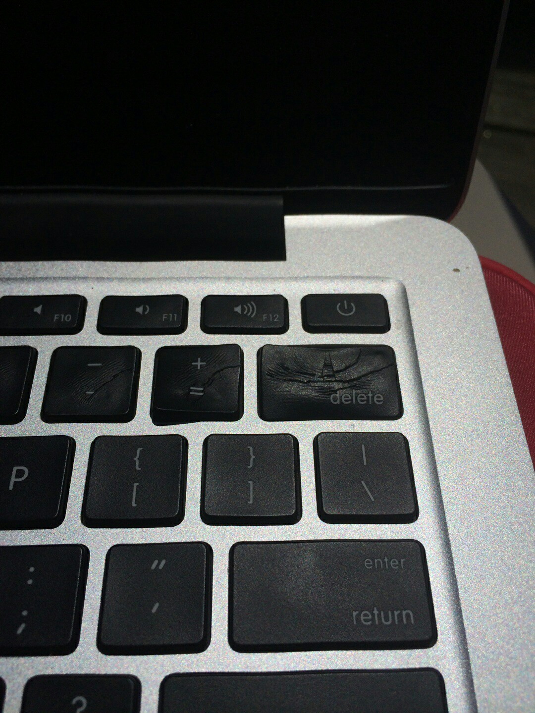

Is it happened to the macbook user who start using external display connected,?:confused:
http://www.reddit.com/r/WTF/comments/34unnw/my_friends_laptops_keys_melted_overnight_when_it/
Lessee, there's no mention of the words "Dell" (except from a poster who had something happen "a few years ago") or "external" or "display" or "monitor" in that thread, so why would you offer up the post as a "cause" in this thread? The OP didn't know either - posting for a "friend" who didn't know. So, I don't know - I've got two of these connected to my rMBP and it doesn't have any "melted" keys.

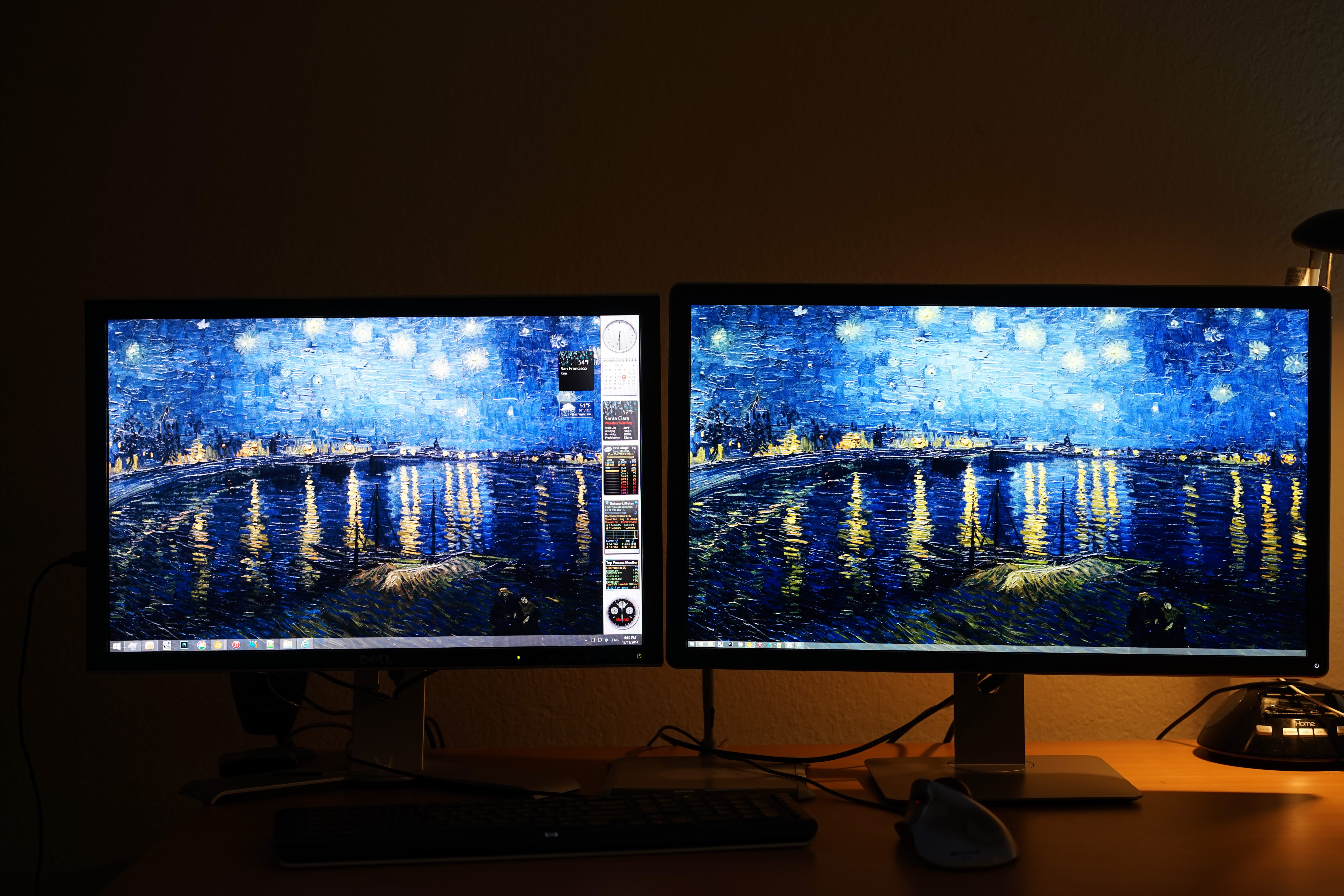

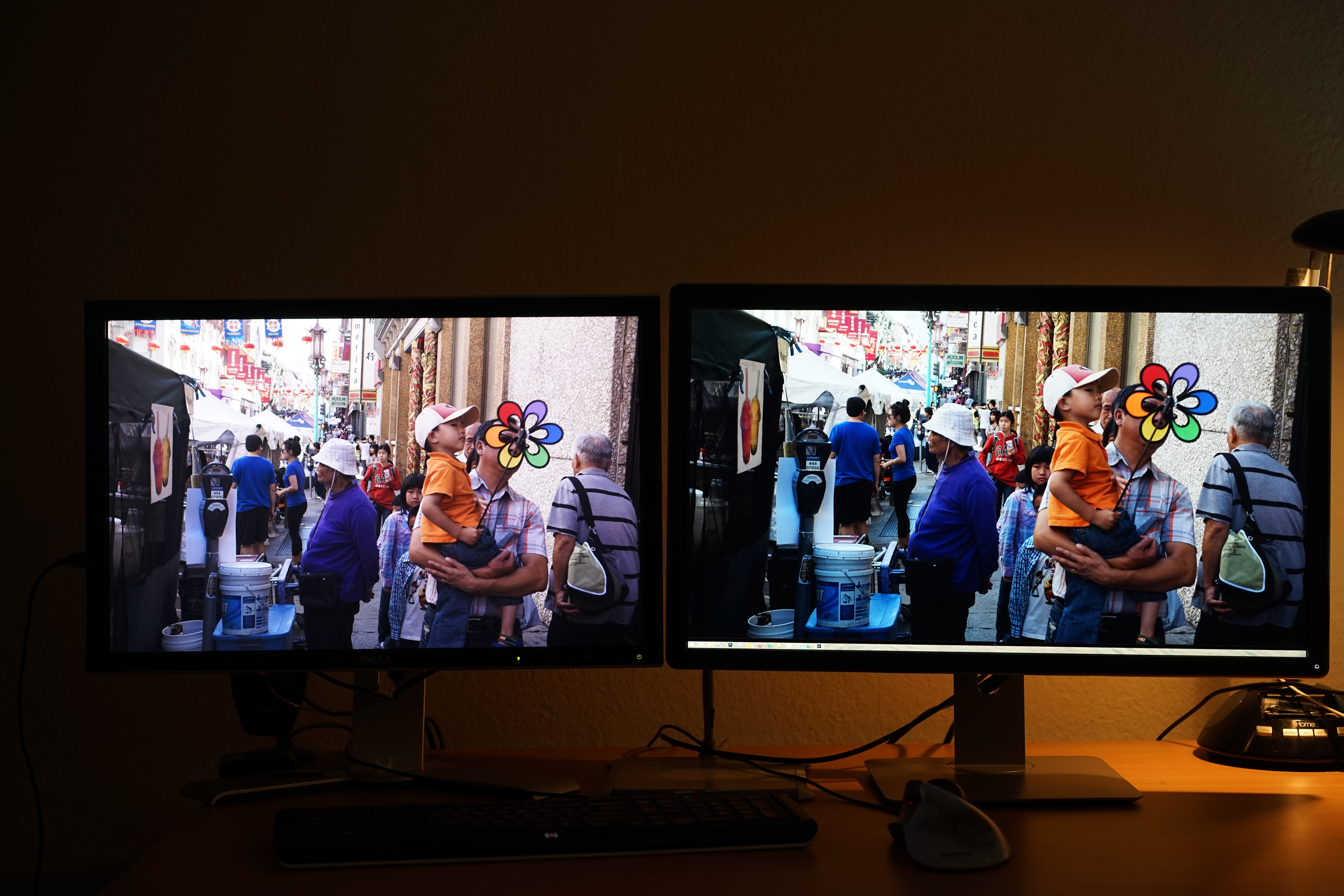

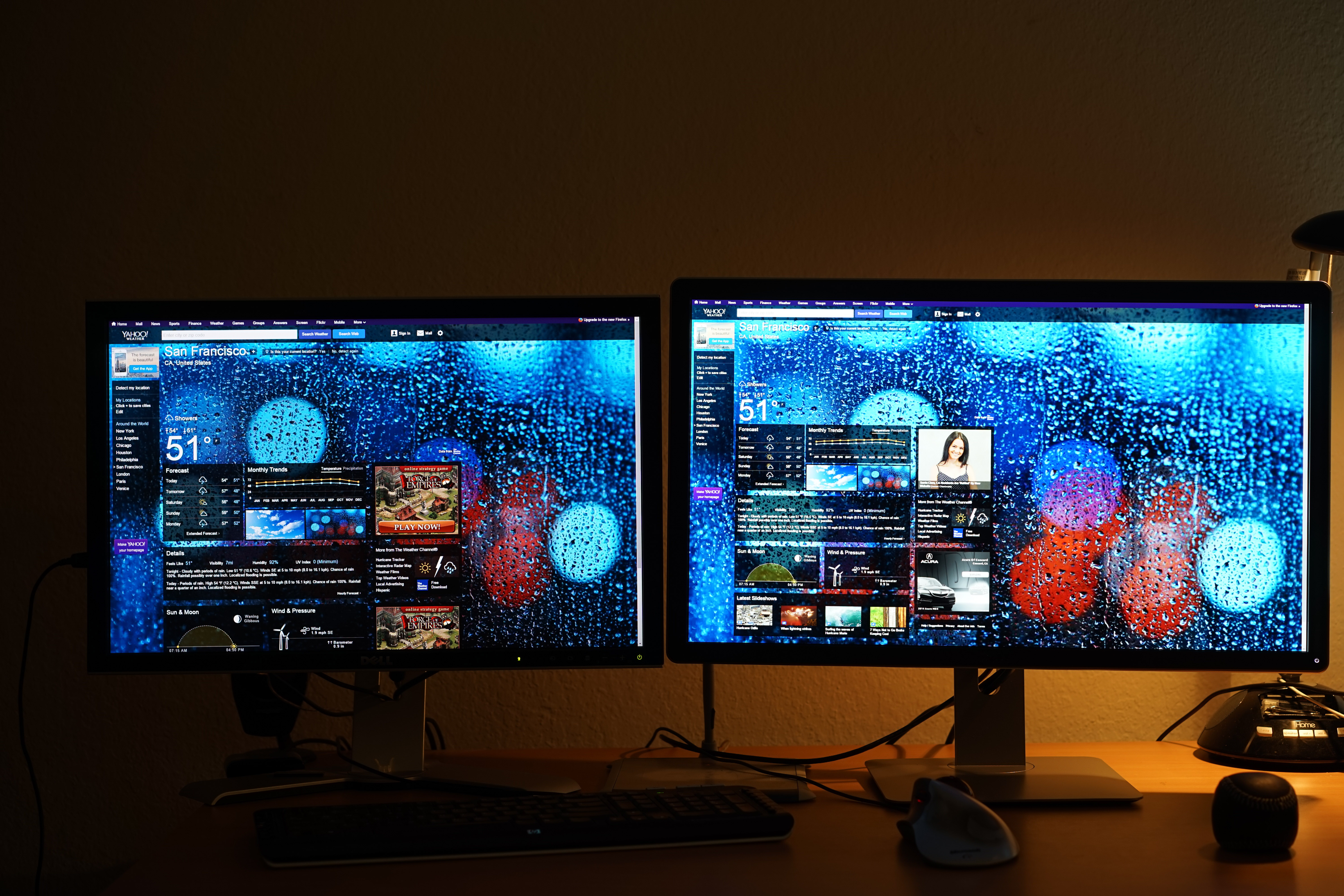

I have second monitor - Eizo EV2736W (native 2560x1440). I can connect it to Dell and it works via MST mode (daisy chain). I get 2 mirrored monitors (works only with lid closed). Only mirrored option works - I can't change this.
After some time I can tell that in Dell (with scaled 2560x1440 resolution) everything is blur, Eizo have beautiful text, Dell not.
You can see some photos (little bad colors pics from my phone, but you can see difference it in 2560x1440)
I miss light sensor, but Eizo 4K is too expensive, I can buy 2x Dell 4K. If you want work only on 2560x1440 - buy Eizo.
