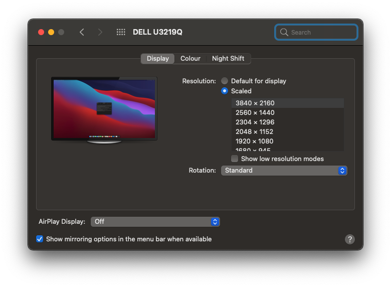

I couldn't get USB ports to work with my M1 Mac mini just with the single USB-C cable. I used the cable supplied by Dell with the monitor.
Now I ended up switching to HDMI + uplink USB cable and things work pretty well. However, I noticed that there are less scaling options available with HDMI cable (I'm running display in 2560 x 1440 mode - its super crisp ?). As a plus side I think screen wakes up more reliably (but still slowly) with HDMI compared to USB-C.
Reactions: pldelisle
