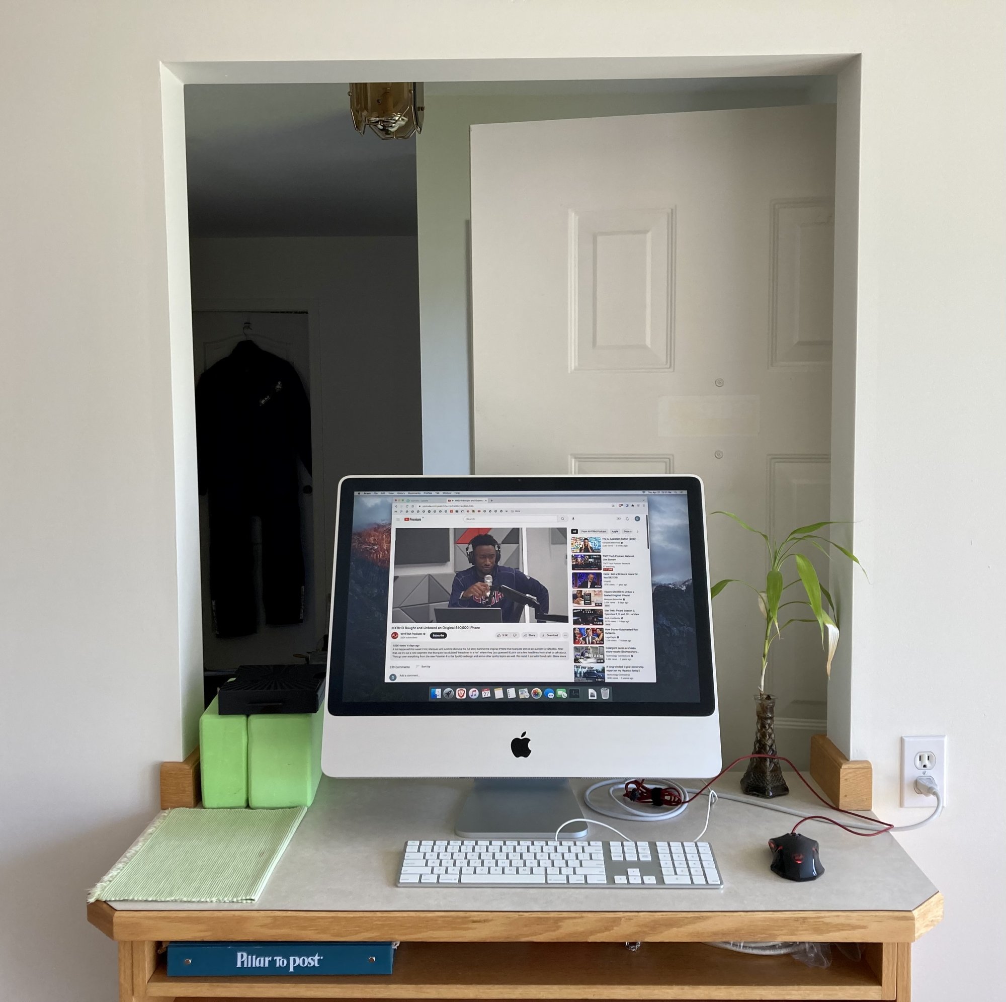

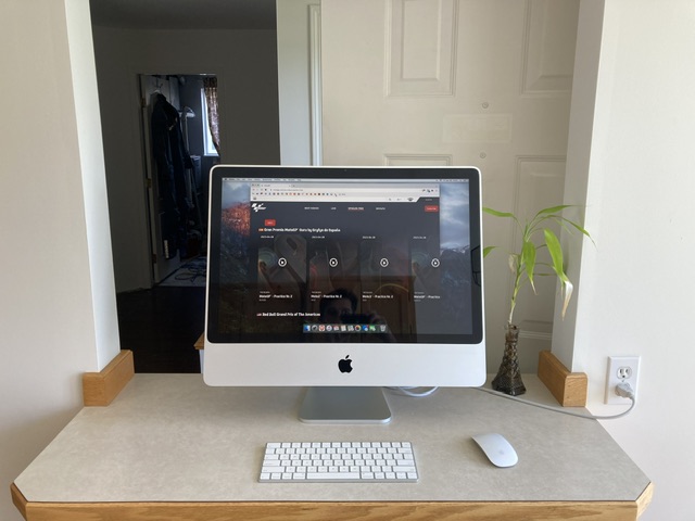

Set up as a kitchen computer where it really seems to be a perfect fit. I also paired a spare Magic Keyboard and just need to get another mouse for a full wireless setup.

Picked up a secondhand Magic Mouse 2 from Craigslist so I’ve got a proper clean set up now.

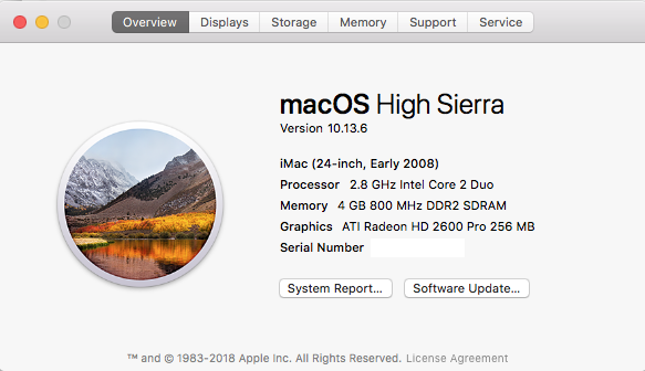

For what it's worth, these machines run High Sierra beautifully using the Dosdude1 patcher found here. I've been running HS on my 2008 24" for years now, and other than the APFS patch at startup you'd be hard pressed to tell that it wasn't natively supported.

I had previously patched a Mac mini up to Catalina with a dosdude1 patcher. Considering that most software today is High Sierra minimum, maybe I should consider patching this.
Go for it! I’ve used the Mojave and Catalina patchers before as well, and they’re a bit iffier of an experience compared to the High Sierra patcher I’ve found. They work well enough but with some clear compromises, none of which I’ve found with the high Sierra patcher.

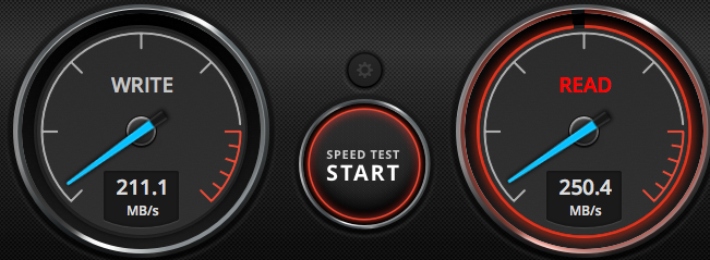

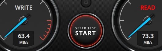

Done! Easy install and it was good to clean out all the dust which had built up since 2008.
Before:
After:
With an SSD it's downright zippy!
Those iMacs are great to work on, and as you’ve found out for yourself now, quite peppy with an SSD! So many of these older machines are held back so severely by their spinning disks and can be brought up to respectable usability with a cheap SSD.

So far I can report that most everything works pretty well with one exception: the microphone is a bit hit-or-miss. I have definitely had it working before but more often than not it doesn't. I guess this is a bug. I have seen the iSight camera/microphone listed as a bug with the Mojave patcher but not High Sierra. I suppose it's the same bug?
Hard to know, to be honest, unless someone’s already reported running into this same issue in HS on the 7,1 before you (it could be buried somewhere on a stackexchange thread, for all we know). There are a couple of people on this forum who might have a more concrete hunch (dosdude1 and LightBulbFun are my perennial “they probably know what’s up” folks for really unusual/rare issues/quirks like this).
An update: microphone issue was completely my doing. I took the frame off and adjusted the microphone cable, making sure it was plugged in correctly and not twisted when I put the case back on. All fine now on High Sierra.
I also after much pain and gnashing of teeth managed to get the latest supported versions of Pages and Numbers installed from the App Store.
