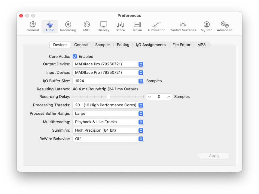

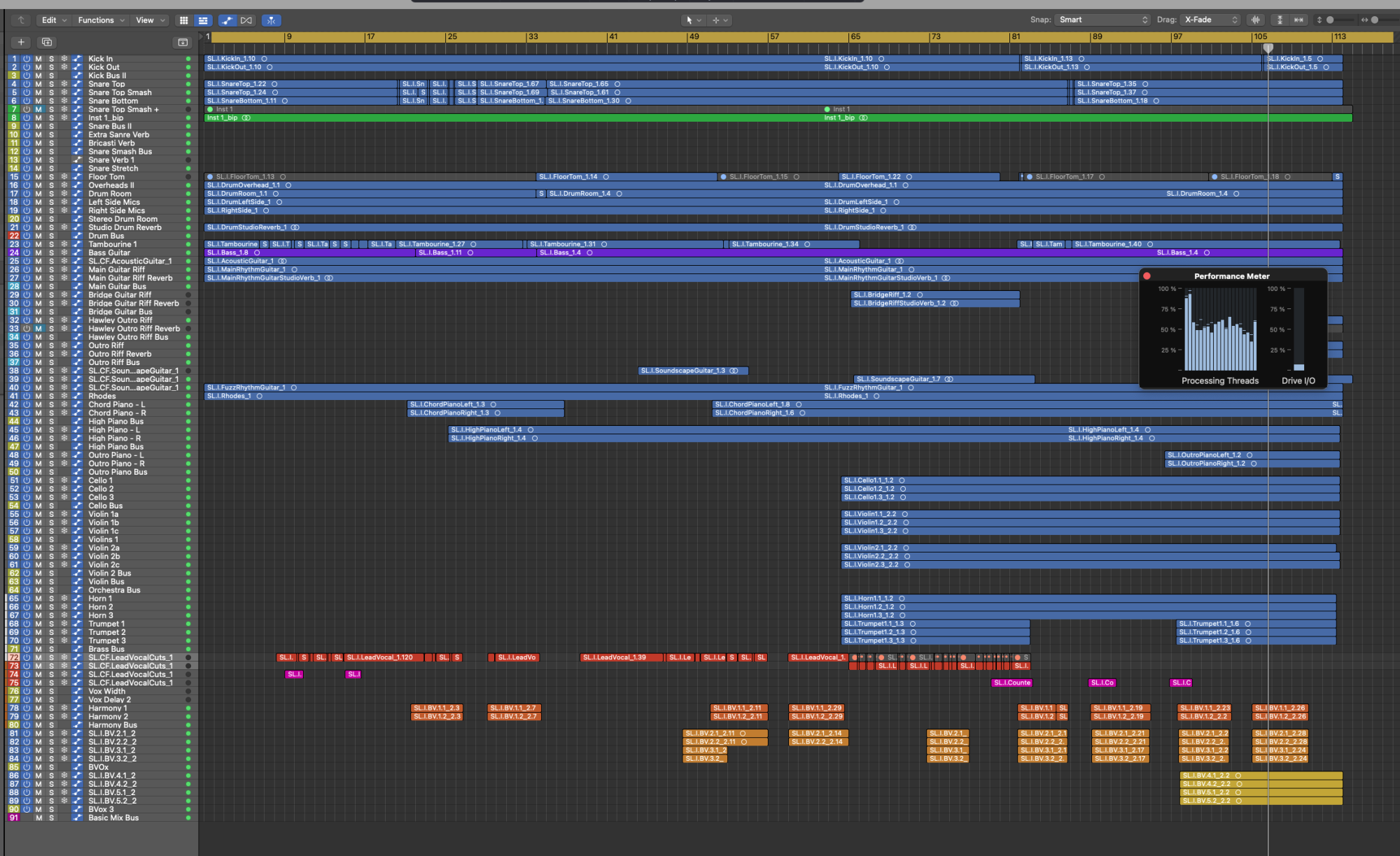

Here's a mix that I started on my intel Mac, and I'm just bouncing it out now. You can see the CPU meter in the Logic arrange page screenshot.
On my maxed out old 5,1 Mac Pro, I had to freeze some of the tracks to get it to play back, however I don't consider this to be a 'huge' project by my standards. It's at 44.1KHz, and I often work at 96KHz (when I get the choice vs when I get a mix to send in). I had planned on upsampling songs I get sent in to 96KHz, too.
There are Intel based plugins running here, but that's going to have to be the case until I can run everything Native. the vast majority of plugins are ARM native though.
As you can see, there is not a lot of chance that an M1 Max would run this mix easily, and it's just at 44.1KHz. A fair bit of oversampling is enabled on the plugins, however.
I think things will get better when everything is ARM native and perhaps also when the project began life on an ARM system. Plus just because the plugins are ARM native, doesn't mean they're very optimised, hopefully things will improve then.
However if you need to get work done *today*, then hopefully this real world example offers a bit of realistic context for people who haven't switched yet and are wondering how much power they need. I do use a lot of heavy plugins FYI.
