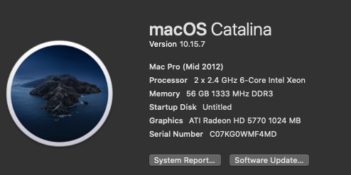

I was on highsierra and used dosdude to upgrade to catalina 10.15.7 while still using the ati 5770.
Everything is fine and Catalina works.
Went to swap the GPU to rx5700xt and nothing is showing up on my computer screen, it's just black.
Boot ROM Version: MP51.0089.B00
Is this the reason?
Do I need to install opencore?
Do I need to download the driver and it'll work?
Help plz.
One of my memory sticks crapped out so that's why its at 56gb. Noticed this as I'm typing this post.
First thing, you should upgrade your Mac Pro firmware to 144.0.0.0.0, MP51.0089.B00 do not have the correct microcodes or the APFS EFI module for supporting APFS disks post High Sierra. Unfortunately you can't upgrade the Mac Pro firmware with a RX 5700XT, while the RX 5700XT is a METAL GPU, the METAL GPU needs to have High Sierra drivers for the BootROM upgrade to proceed. If you can't borrow a High Sierra METAL supported GPU, the only workaround is a BootROM reconstruction service.
Second thing, there are no GPU drivers to download anymore. Since Mojave, Apple provide all GPU drivers with macOS already. If a GPU is only supported after a specific macOS release, like RX 5700XT being supported only after 10.15.1, you can only run after that.
Third thing, the patches necessary to make a non-METAL GPU (the ATI HD 5770) to work with Mojave and newer macOS releases make METAL cards to not work anymore, you have to revert the patches or re-instal when you move from a non-METAL to a METAL supported GPU.
If you are sure that the RX 5700XT is a working card, get a spare disk and do a clean install of Big Sur/Monterey via OCLP just for a quick test, but you should upgrade the BootROM first.
Try different ports in your 5700XT. If that doesn't work, you will likely need OpenCore. Specifically, Lilu, Whatevergreen and the agdpmod=pikera boot flag.
