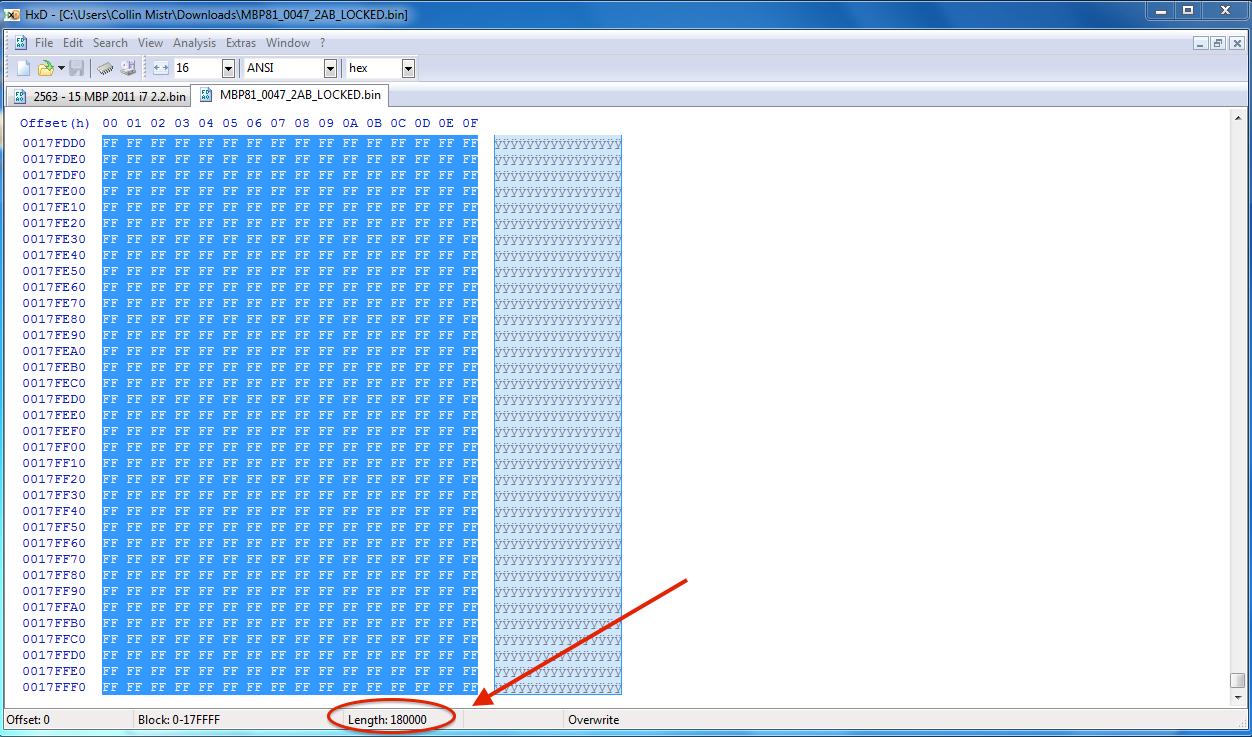

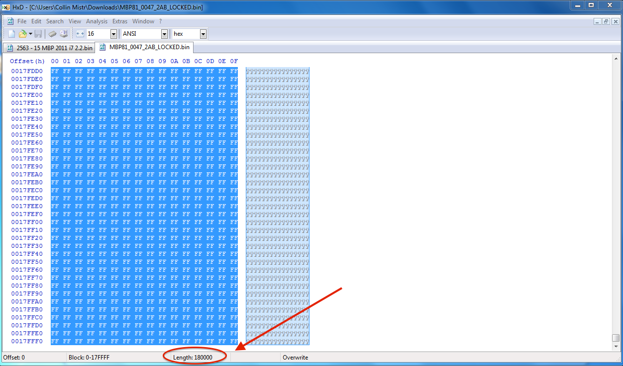

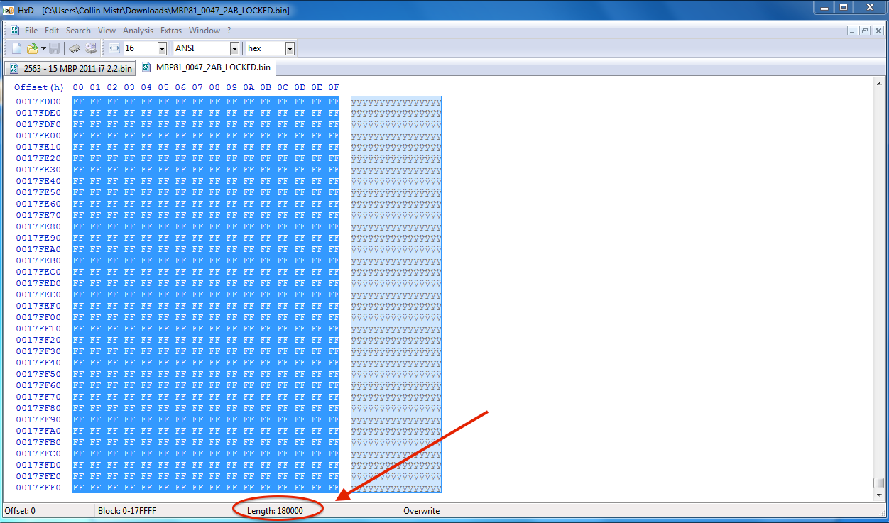

3) Download this file, containing the clean ME region for the MacBook Pro 8,1.
4) Next, open both it, and your dumped ROM in a hex editor.

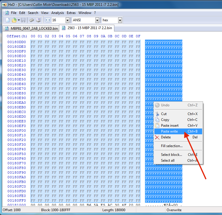

5) In the ME region file, highlight everything by pressing Ctrl + A keys, or right-clicking, and selecting "Select All". Press Ctrl + C to copy all, and take note of the Length value shown at the bottom of the window.

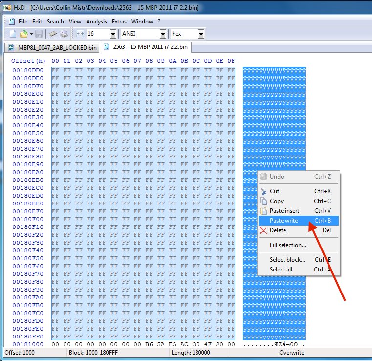

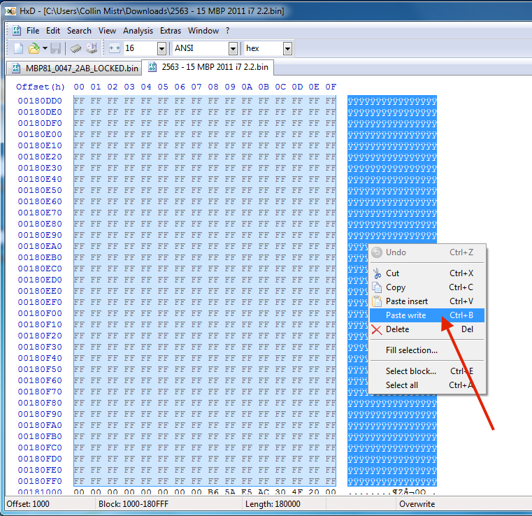

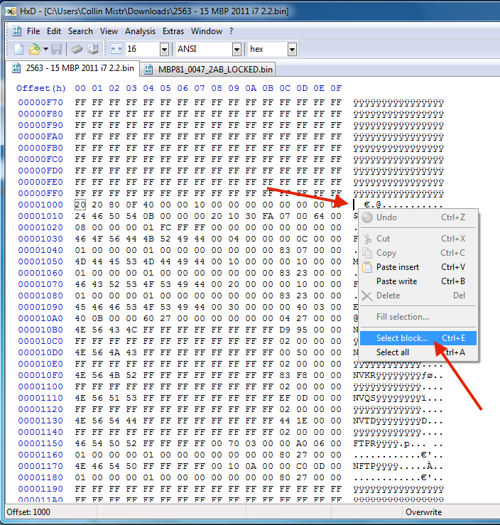

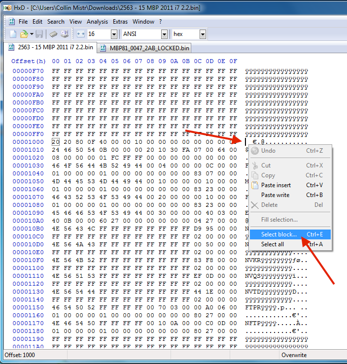

6) In your ROM dump, search for the string "krid". This string is located towards the beginning of the ME region. From the string "krid", go up a bit and look for the start of the region, which consists of " €.@".

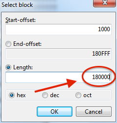

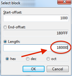

7) Right-click right before the first of the two white-space characters, and select "Select block".
8) In the dialog box, select the "Length" option, and enter the Length value you obtained earlier.
9) Click OK, then right-click in the newly-highlighted area and select "Paste write".
