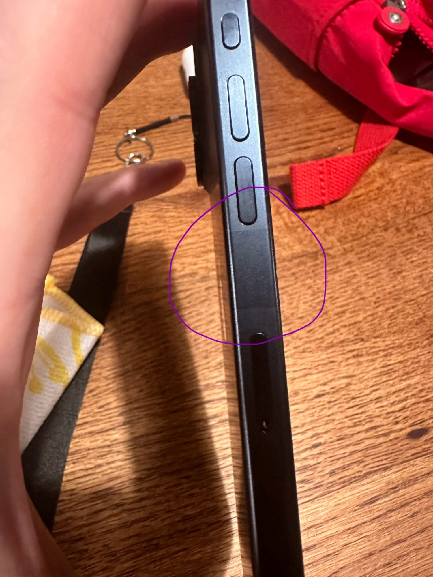

UPDATE: So interestingly, it looks like heat has 0 impact to my discoloration blotch. At least on my device...
I had my phone off for 10 minutes (which was completely cool to the touch), wiped it down with isopropyl alcohol (which temporarily removed the discoloration), then proceeded to wipe it with a microfiber cloth and the blotch instantly reappeared.
Looks to be material related and a manufacturing defect. I definitely plan on returning it, but I'm curious on what may be causing this. I absolutely suspect it's something related to the PVD coating being incorrectly applied at the factory.
Looks to be material related and a manufacturing defect. I definitely plan on returning it, but I'm curious on what may be causing this. I absolutely suspect it's something PVD coating being incorrectly applied at the factory.

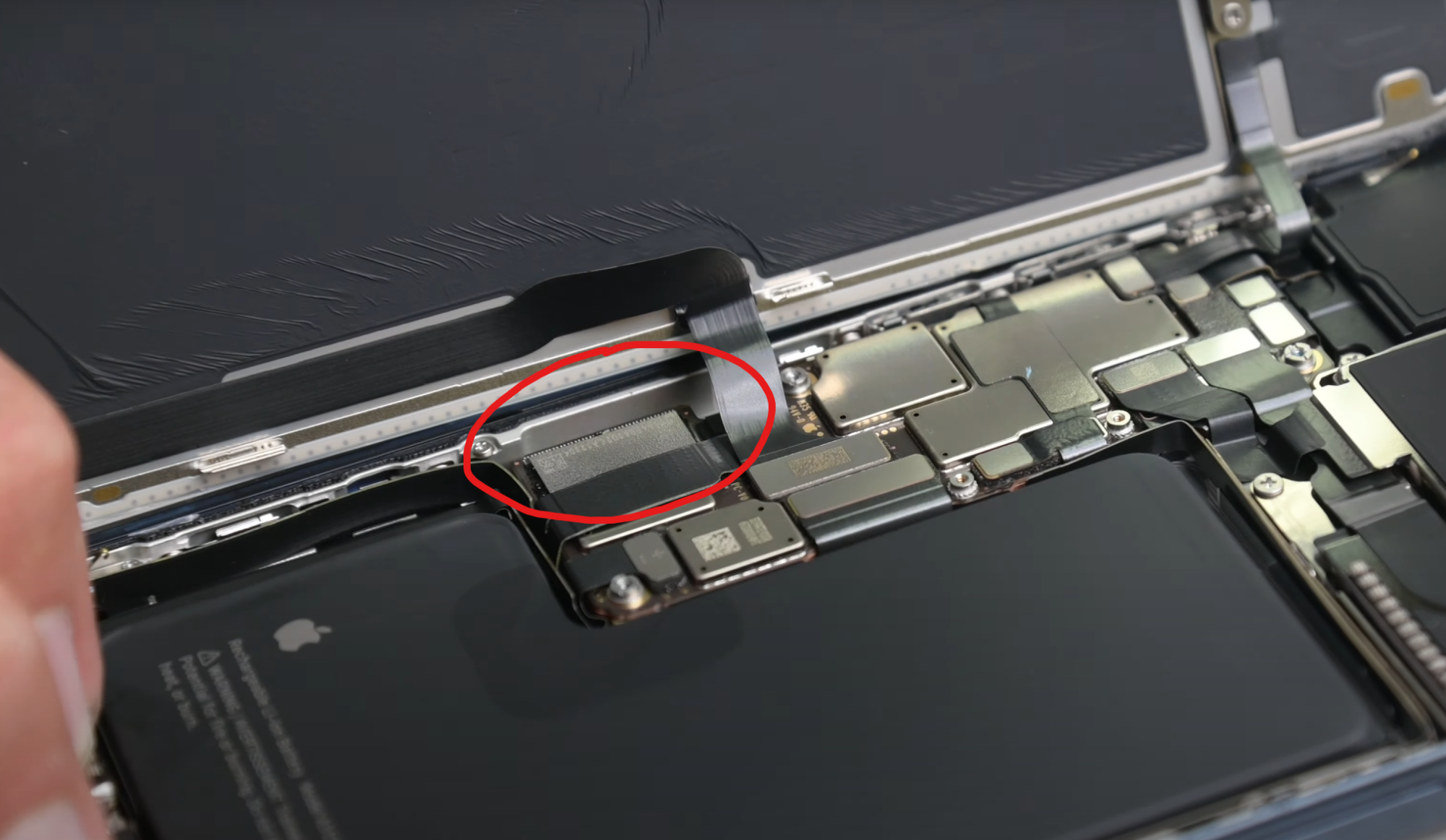

I was watching the teardown videos right now. Next to this place where the color changes, there is obviously the motherboard. However, which component is behind the area whose color changes directly? I don't know.
The question we are looking for an answer to is exactly about this place. What is the component I circled in red? Because there is a color change right behind this. As you can see, the part after the screw on the left is thinner and continues to the right side.

All I want to know is what is the component I marked in red? People just sit and wait for an explanation. Why isn't anyone investigating the issue?

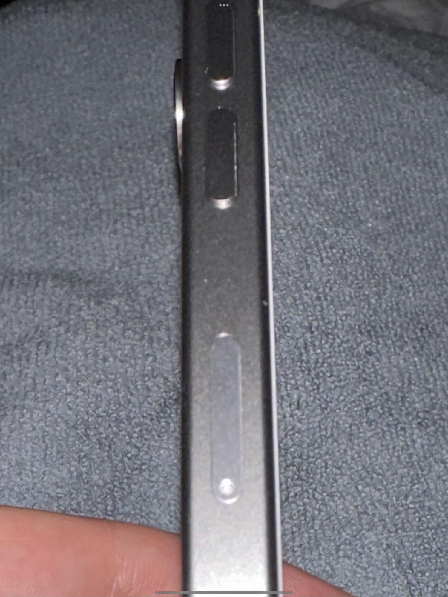

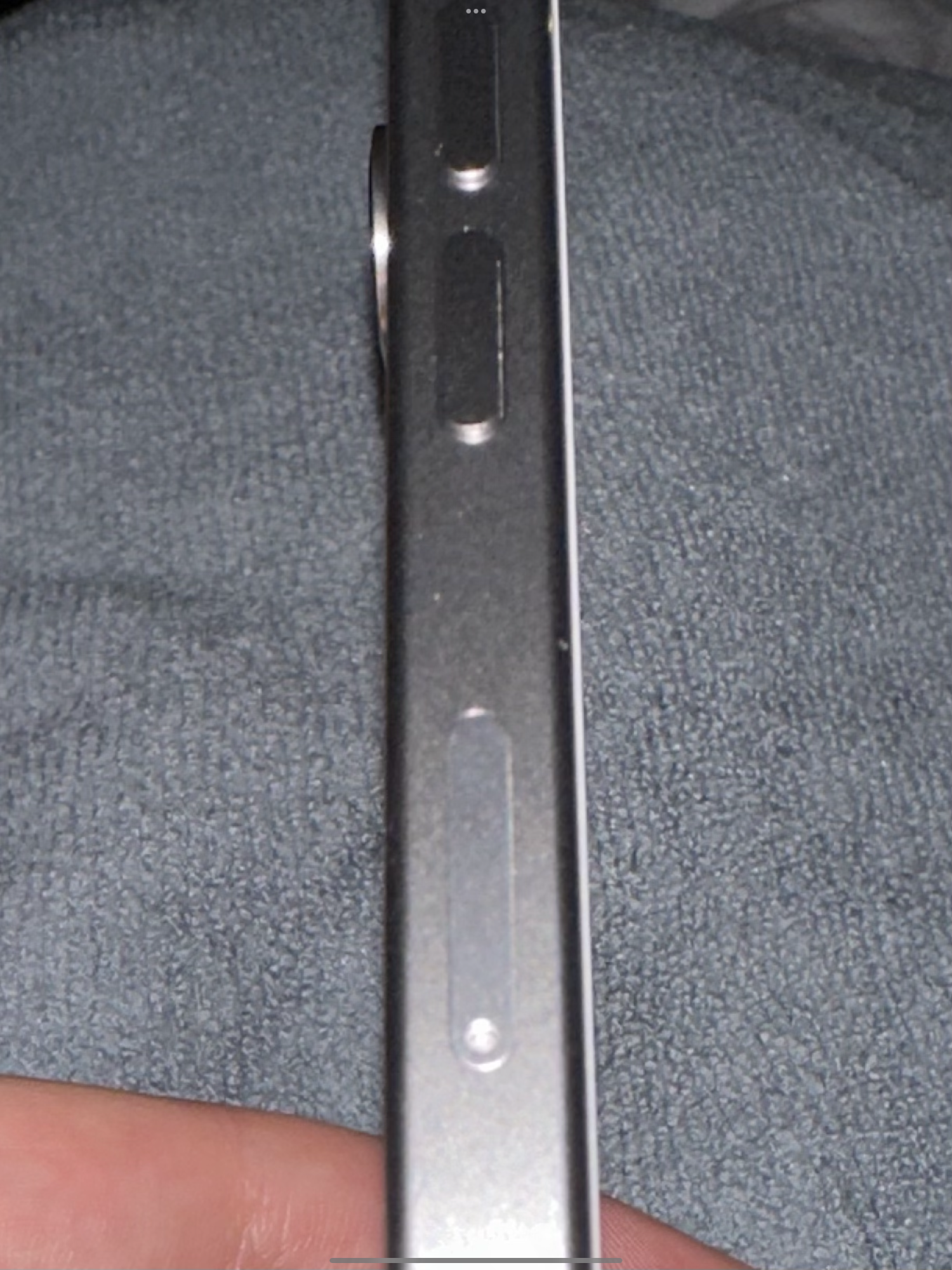

I had a really good look at mine and I don’t have it, checked every angle with led flashlight and the attached pic is with flash on.

Yeah it’s weird and agreed you don’t have it!
