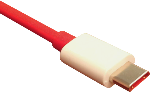

As a quick check, try replacing the cables.
Plutonius
macrumors G3
Feb 22, 2003
9,078
8,491
New Hampshire, USA
I'm using original cables... Can you suggest an alternative?
Thank you very much.
The cables may not be the issue but a few people claimed that replacing them has cured the problem (cheaper fix than trying a new enclosure).
I'm not sure what you have for original cables but Amazon has lots to choose from if you decide to try replacements.
