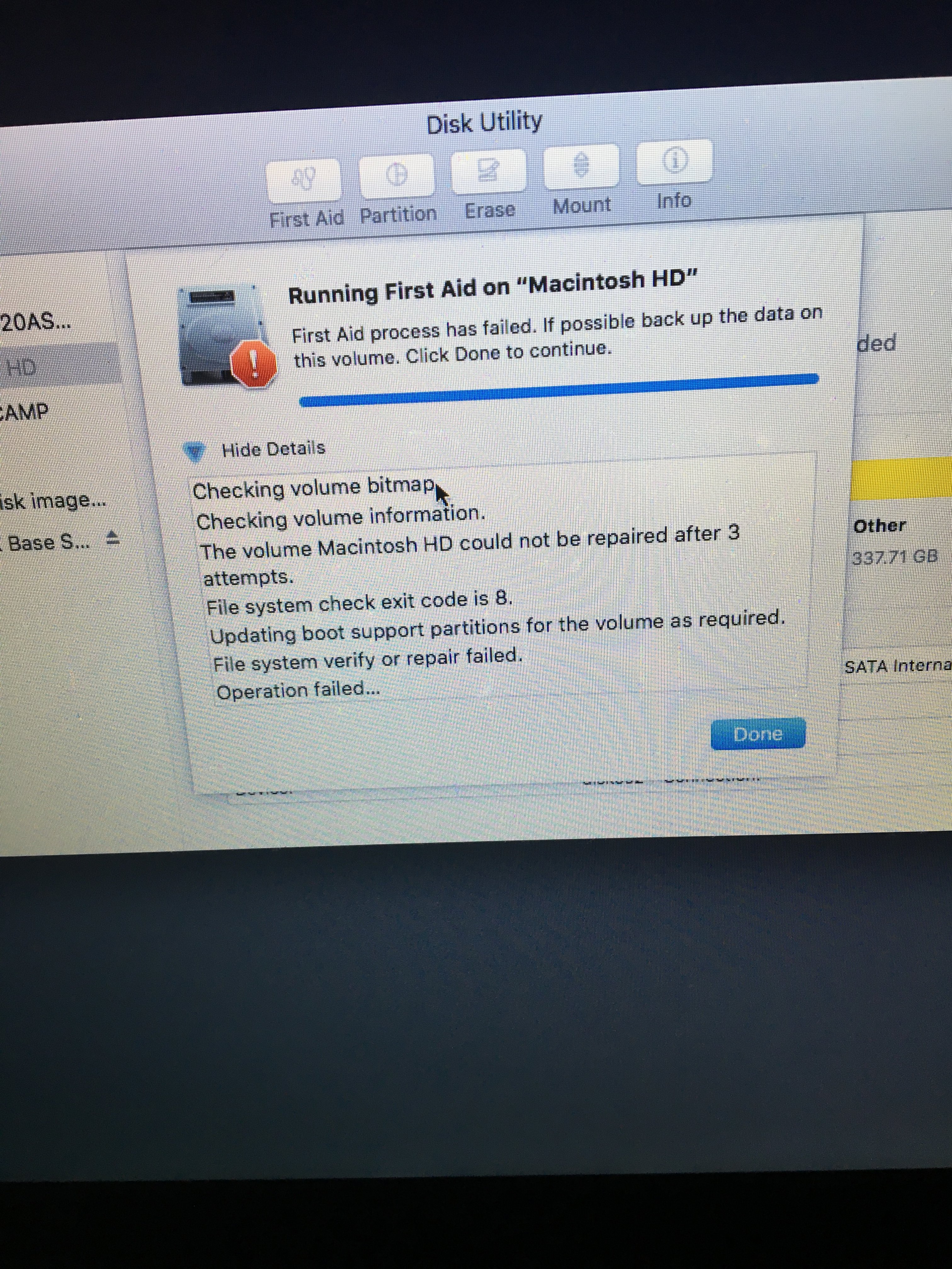

Thanks for your help sir far, DeltaMac. But I didn't have any luck. Disk utility tried to repair it but I guess I'm gonna have to go to the Apple Store or get a third party repair program..
I'm gonna try to use a time machine backup and see if that will work.
Update: scratch that. It can't even find my external HDD.

I think at this point, I would make an attempt to reinstall OS X.
Boot to El Capitan installer (I keep El Capitan installer on a bootable flash drive, just for that occasional use), and see if the install will both see your OS X drive, and complete the reinstall without errors.
That SHOULD reinstall OS X, as something like a repair install for Windows, without losing anything.
However, you may also see that the OS X reinstall won't work, and stops with an error, or reports that the hard drive needs to be repaired, or some other bad result. But, I think it won't hurt anything at this point to try a reinstall. That will sometimes fix up hard drive directory errors - but it will also try to fix errors as you try the install, and may fail then. And now, you will know why it has failed.
Diskwarrior would be a good next step (you will get to buy that software, good to have around, too.)

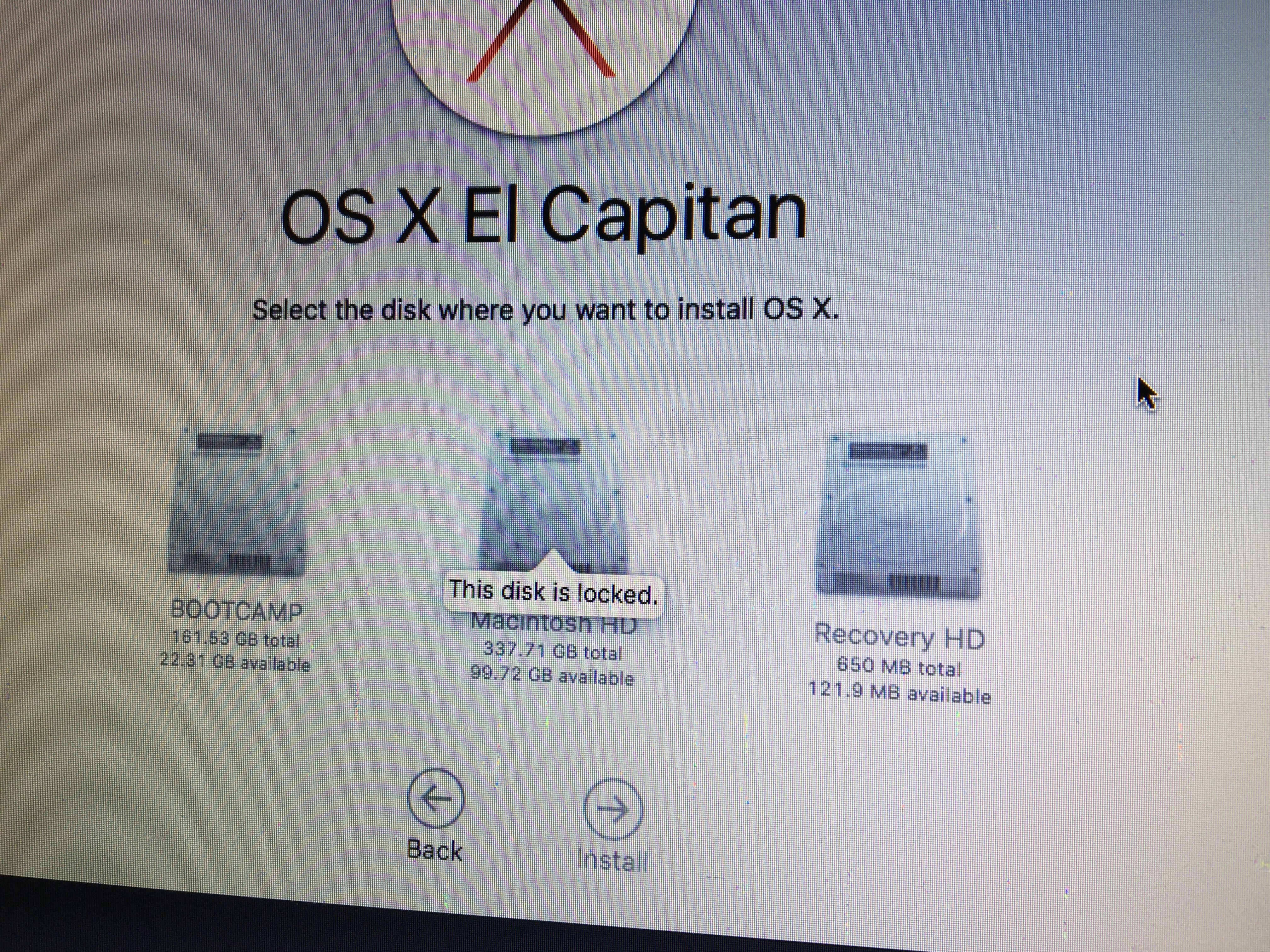

As an update, the OSX install wizard recognizes the Macintosh HD drive, but all drives are locked. Any way to unlock them?

Here's the simple answer - it's in multiple parts.
1. Back up your Windows partition, if you don't already have it backed up
2. Back up your OS X partition, too.
3. reformat your drive - wiping all partitions.
4. Reinstall OS X, then restore your back up
5. Run the Boot Camp assistant to recreate your Windows partition, and restore the back up for your Windows software.
And, that's it. If you already have everything backed up that you need, then it won't take too long, possibly less than 2 hours, and you are back in business.
Or, alternatively, as Step 1 - try to repair the drive as it is now with Disk Warrior.
That may be all you need to do.
And, if you do need all the steps, you might consider replacing the drive after step 2 - as it could just be a failing drive.
After 5 years, it has served a good life, and full SSDs continue to come down in price. And, going to a (real) SSD will mean a noticeable jump in performance, better than new 😀
