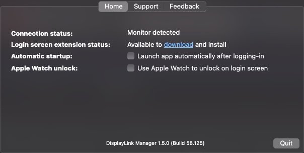

My LG Ultrafine 5k 2019 (5120 X 2880, same as iMac) is connected directly to the Air. That's the only way to connect a TB3 monitor to an M1. With Intel, it can be a direct TB3 connection or a BlackMagic eGPU.
(Docks don't support TB3. M1 doesn't support eGPUs. Regular (e)GPUs don't support TB3. Overall, connection options for LG Ultrafine 5k are generally quite limited.)
On the LG back panel, there are three USB-C ports. I've connected the DisplayLink dock to one of them. The dock has HDMI ports, and I use two of them to connect two WQHD monitors to both sides of the LG. Three-monitor stand. I can set the resolutions of all 3 monitors to almost anything I want with RDM.app, including scaled resolutions.
That's probably a very different setup from yours.

Just got my Belking usb-c hub which uses DisplayLink Manager to use with 2x4k monitors and its really disappointing, theres a visible lag while moving mouse on both of my monitors, DisplayLink manager software uses almost 3GB of ram, switched back to use two usb-c ports with display port to usb-c cables 🙁
I've been trumpeting the M1+DisplayLink combo a few times, might as well do it once more. In short, it's fantastic. Coming from an MBP16 + eGPU combo, it's so much more responsive overall. Completely silent. Nothing to eject, just pop the M1 off when done. Three ext monitors connected via one TB3 cable that includes power. One more TB3 port (and bus) free for other peripherals. Performs just as fast as a "real" GPU for my graphics/design-related workflows. Clamshell works fine. The native M1 app is just icing on the cake.
Trade-offs, which I consider minor compared to the upsides, are:
  1. Log in with Apple Watch doesn't work when ext monitors are active (due to screen recording API being active); it works when undocked in laptop mode.
  2. NightShift/Flux doesn't work on DisplayLink monitors, only on the primary 5k TB3 monitor that is direct-connected, and also works as a USB-C hub for DisplayLink daisy-chaining, for 2 more WQHD monitors.
  3. Can't think of #3.
I sold my 1-year old setup second hand and got enough money to get the M1, the dock, AirPods Max, and still had money left over. It's been 13 years since I had a Mac setup that worked as well as the current one does. That was a well-equipped "cheesegrater" Mac Pro with a 32" Cinema Display.

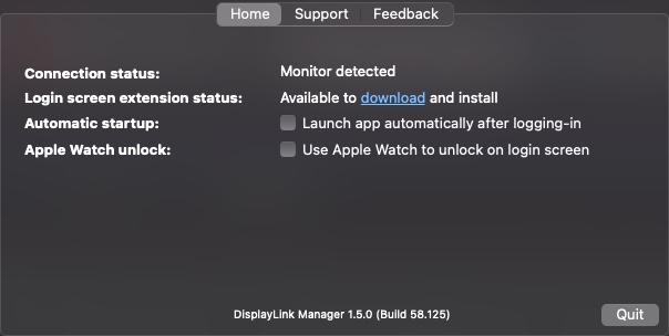

Hello @petterihiisila ,
Applewatch unlock might work now (sorry can't test) .
I saw with the 1.5 drivers it is listed.
