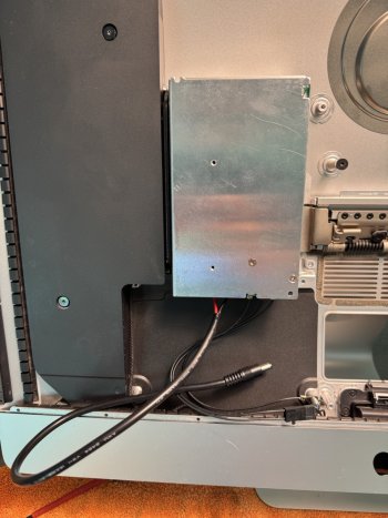

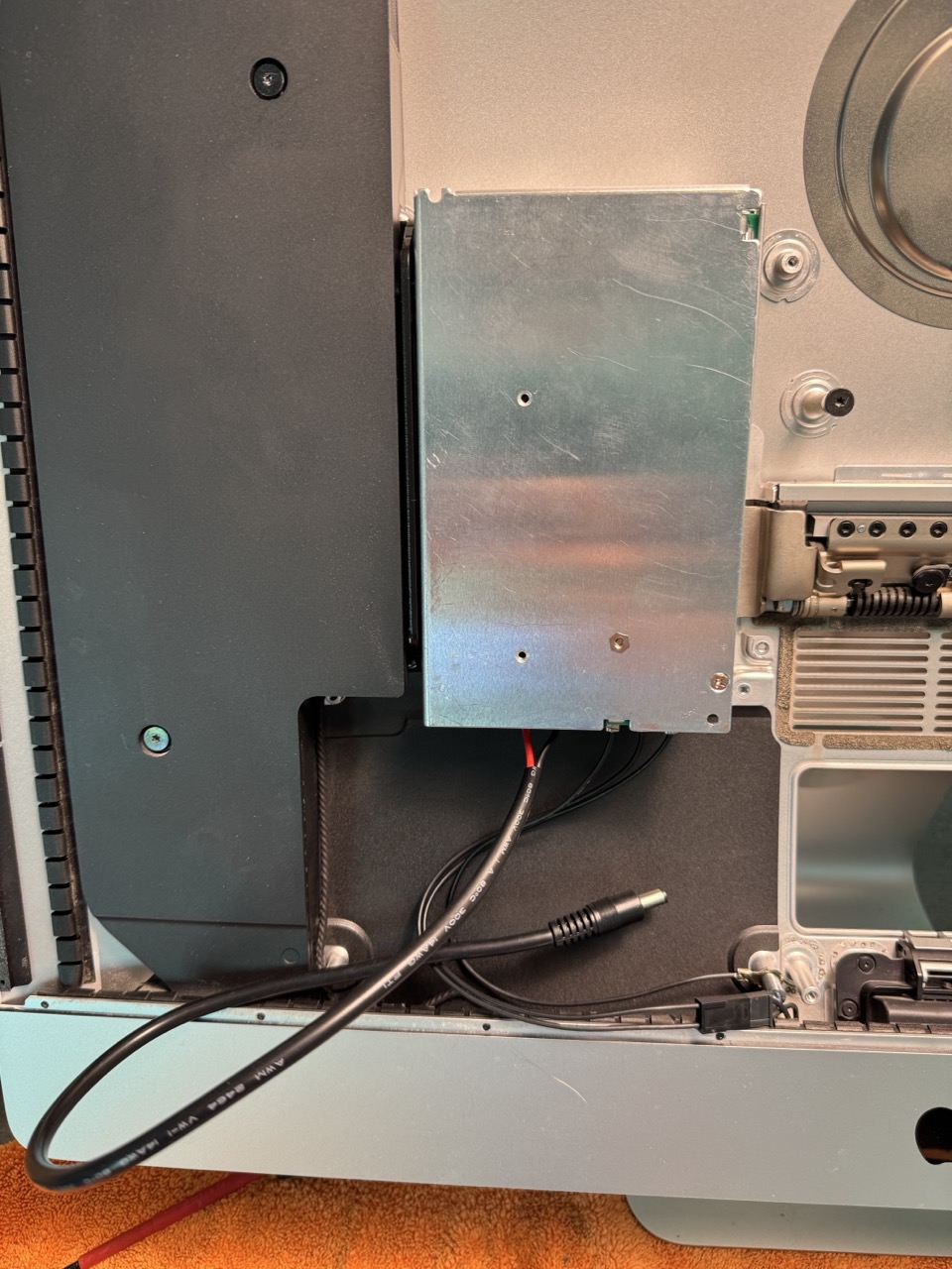

Second successful conversion. Switched from iMac PSU to LRS-150-24 (LRS-200-24 is a bit too big to fit nicely). Fits perfectly, silent, barely any heat. Perfect for a fanless setup. Connected through a molex directly to the iMac connector.

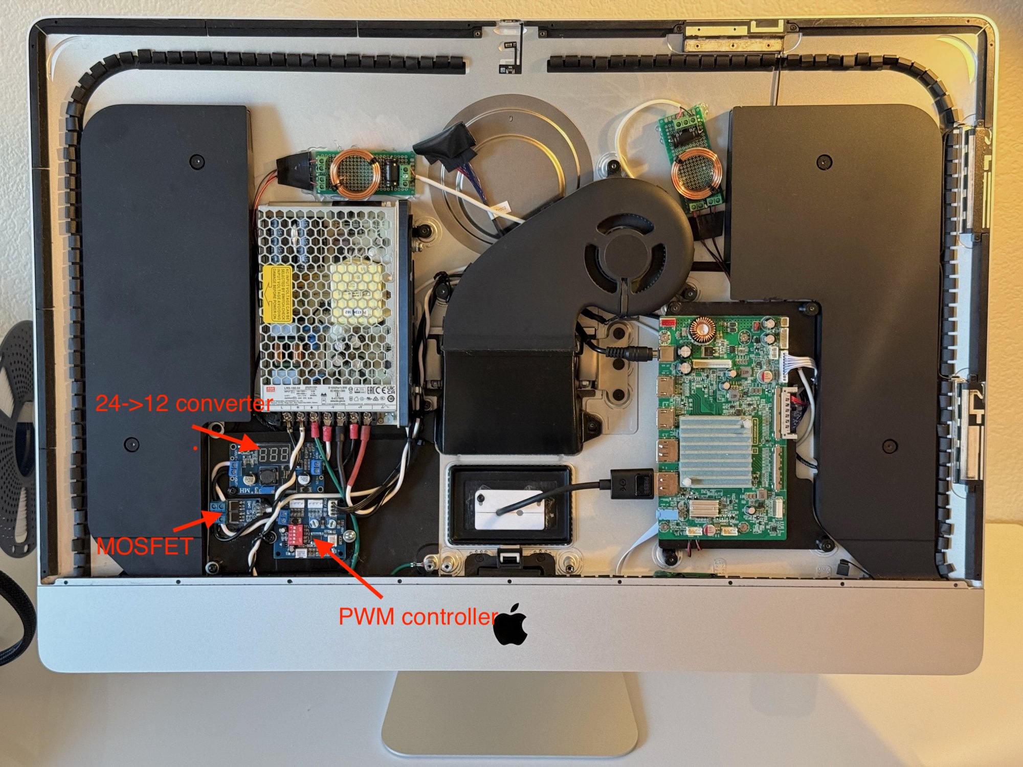

Ok... some T18 progress shots... 4 control buttons printed and working in the 4 USB-A slots (plus original power button connected) and other ports blanked, IEC power removed and replaced with a heavy duty DC input, screen taped into place and running up against my iMac Pro. I'll get some internal shots when I next have it open to finish off the extension ports which I am carefully cutting into the original RAM door.
So far so good - its been running all day on my desk for work and is imperceptibly close to the iMac Pro in brightness, colour and accuracy, whilst the panel seems to be running far cooler than the front or back of the iMac Pro (I opted for an external power brick so I can swap input to my caravan when needed).
Might stay this way a week or so before I go digging around in there for the final time though 😆
@jag001 , I really like how you did the display driver control buttons in the rear reusing the existing USB ports. Can you please tell me how you did it? What switches did you use and how did you choose to connect them to the control button board: To the button solder pads are directly to the wire harness? And how did you mount them? Did you use a 3D printer, and if so, have you published the files?

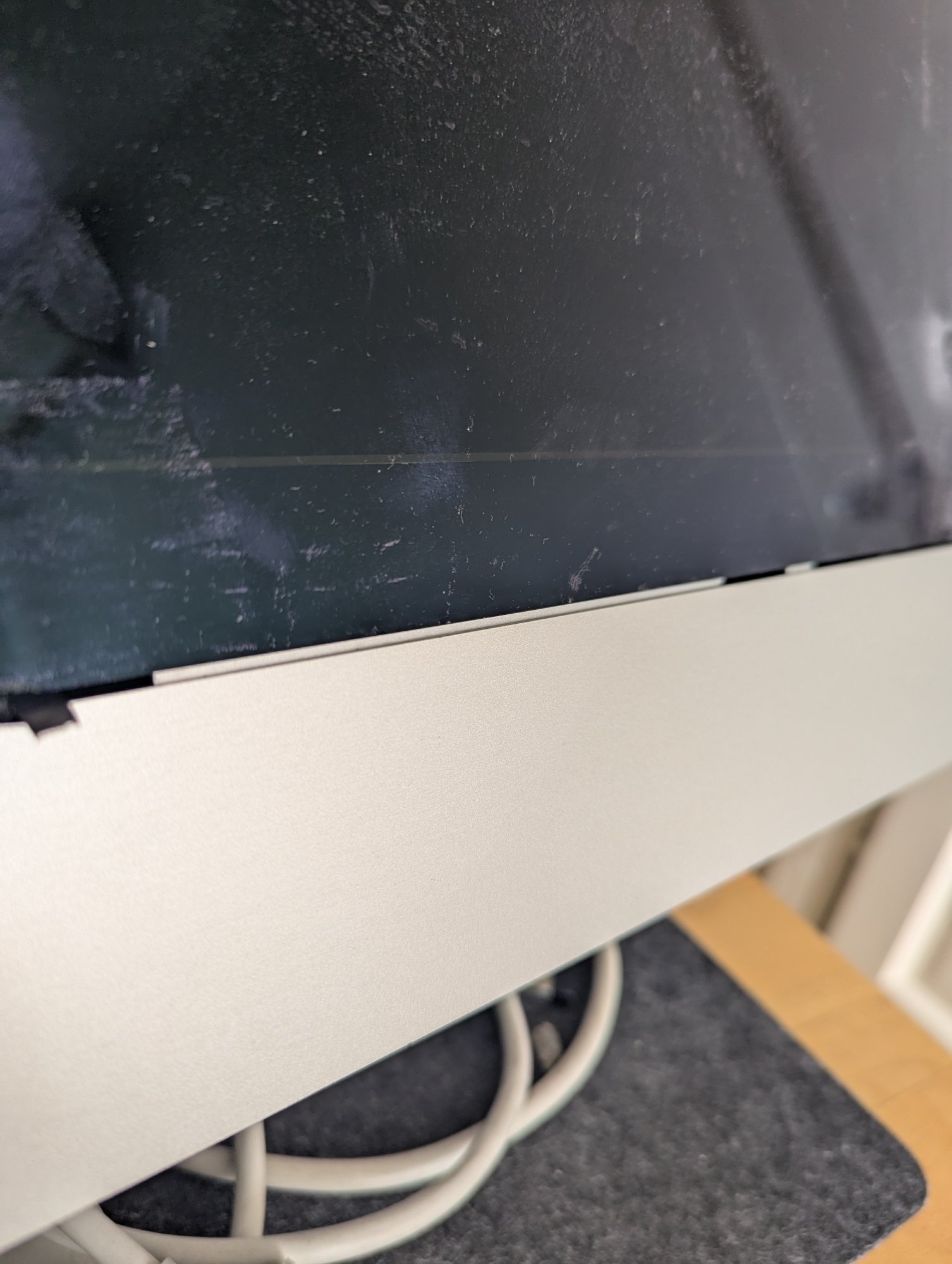

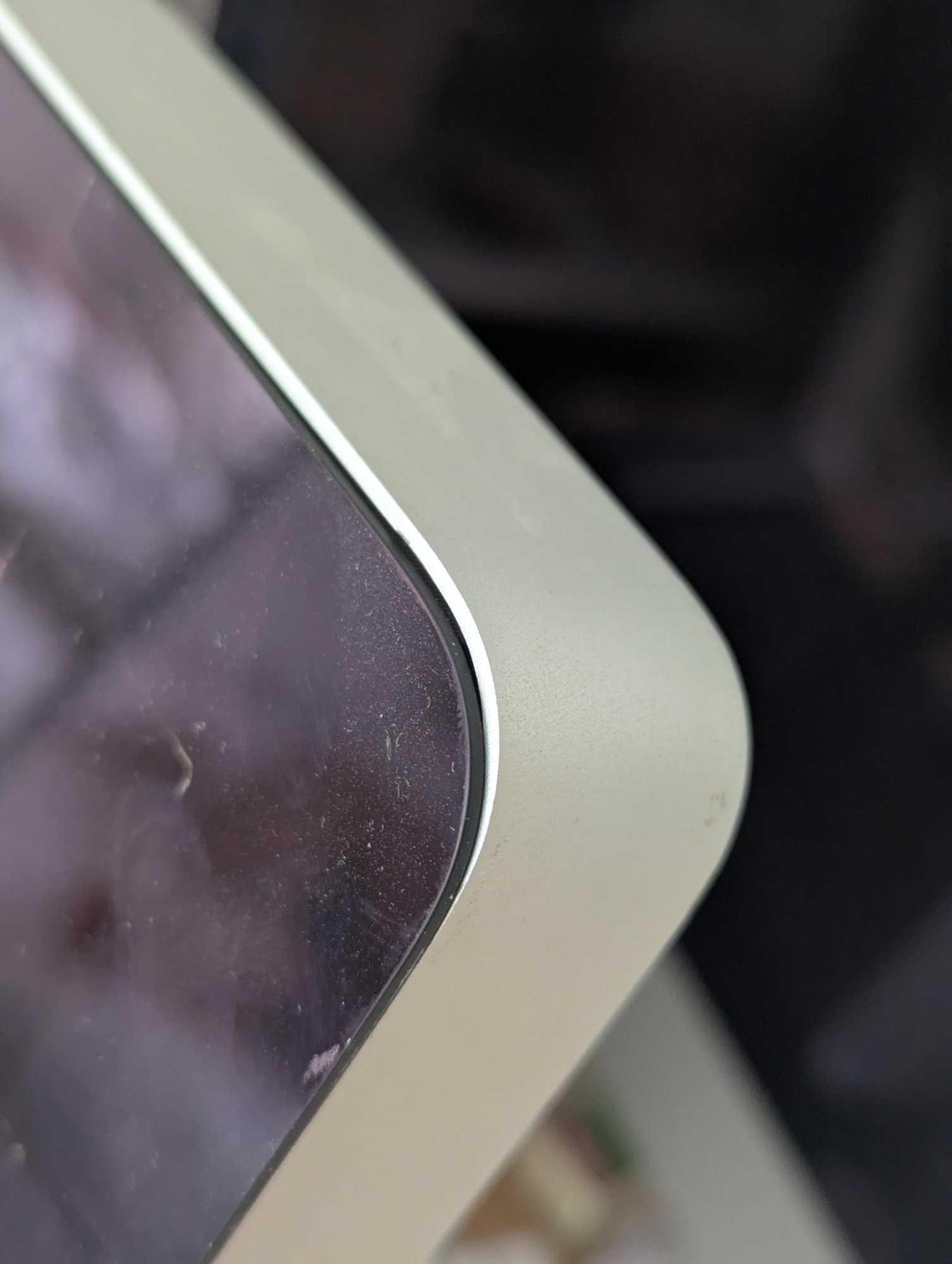

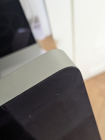

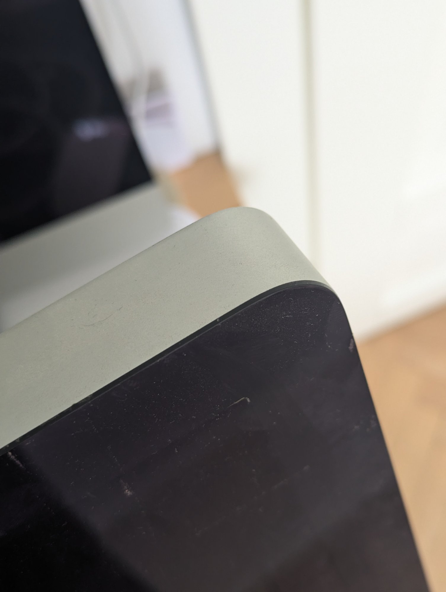

I installed the a1419 display in the a1312 case. The difference is 1.5 mm, you need to extend it and the display will fit perfectly, and you can use magnets to have constant access to the insides.

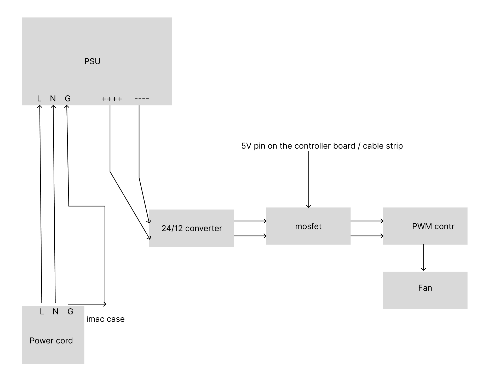

The Mosfet is driving a circuit to switch mains power toff on the PSU when the video driver board it switched off.
This needs to be done with proper quality components certified to run at 230V.

@gul1ver "I installed the a1419 display in the a1312 case."
As @Borzab did, earlier at the start of this thread.
I saw this post, but it is not clear whether the round edges match. I was convinced that if you make an insert at the bottom of 1.5 mm, you can perfectly install the display. There is a lot of space in the a1312 case, I plan to disassemble the mac mini and mark it inside. and use original magnets instead of glue.
The Mosfet is driving a circuit to switch mains power to the PSU when the video driver board it switched off.
Thanks @PaulD-UK can't thanks you enough.
Not really sure what you mean by that though. From my understanding of Cole's build, here is what he is doing (see attachements).
So i suspect when turning off the board it shut's down the fans through the mosfet but i don't see how it could shut down the whole PSU (which would be nice).
It would required a mosfet before the entrance of the psu, but then the mosfet would shut down the PSU, not sure the on/off button would work (since the board is no longer on) to turn it back on. For this I was simply thinking a global switch outside of the build. Not sure it's really a problem the alim stays "on" if there is no power draw.

Edit : for the components
- 24/12 converter https://www.amazon.com/dp/B00LSEBYHU?ref=ppx_yo2ov_dt_b_fed_asin_title&tag=mrforums-20
- PWM controller
-- https://www.amazon.com/dp/B0DBT6B7PG?ref=ppx_yo2ov_dt_b_fed_asin_title&tag=mrforums-20
or this one on ali,
not sure if the Noctua NA-FC1 works here since it has no temperature probe?
- mosfet: something like this
