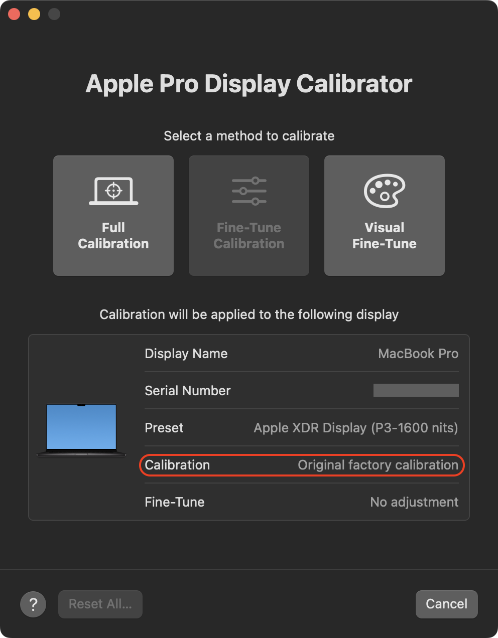

I have erased my MBP several times, including doing an IPSW restore via Apple Configurator, which essentially nukes everything. When I go into Apple Pro Display Calibrator, it says I'm using the original factory calibration.
If what @Mr.Fox says is true - that the factory calibration is lost after an erase - then why would this still say "Original factory calibration" instead of something like "None"?
Also, FWIW, there's a guide on how to reset to factory calibration. It doesn't mention anything about it only being applicable as long as you haven't erased your Mac (if we're going by the claim that the factory calibration is lost after an erase).
Display panels can be adjusted in hardware before assembly, or they can be adjusted in software if you have an OS that offers colourmanagement. A more accurate hardware calibration will cost more effort, and as such will be more expensive. Accuracy levels of most hardware vendors are quite low. Some not even close to the levels of what is considered as mandatory for colour-critical work. This is why there is a market for colour calibration.
Apple's accuracy levels are high, better than some vendors and more than adequate for most consumers. If it isn't, you can calibrate your display with one of the many solutions available. The profiles option that some Macs support make changing between auto brightness and true-tone easier than ever.
To answer the original question - whatever hardware calibration is present in your screen will NOT be wiped out of you reinstall your OS or reset your Mac. The suggestion that Apple would slip a custom file into every device's OS before it leaves the factory and then not offering any way to recover that file is simply ludicrous.
On macbook - Just go to colorsync profile and see the ICC profile for inbuilt monitor. It has an mmod tag which embeds the serial number. I don't have another mac to compare values against, but the ICC profile is dynamically generated based on the embedded hardware info.
The calibration data is likely embedded in the firmware itself and cannot be altered by the end user.
When an item is factory reset, it returns to the state it was in when you first unboxed and turned on the device. This process does not change the internal firmware, which is directly linked to the hardware, including the screen calibration. This aspect is not software-based; any claims suggesting otherwise are incorrect.
