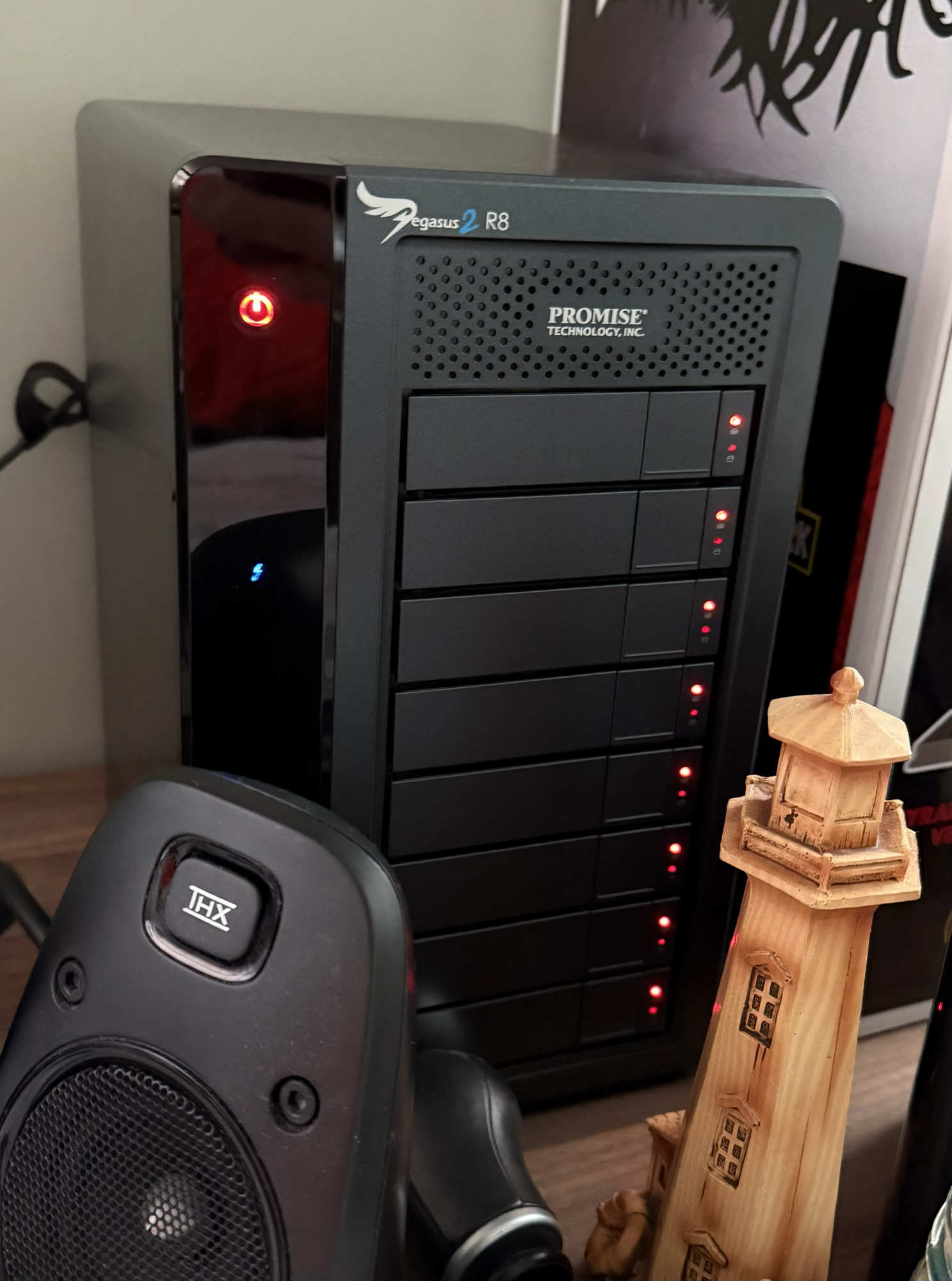

Hello,
This morning my Pegasus2 R8 stopped to mount on my Mac Studio M1 on sequoia 15.4.
I used this drive daily in the last weeks, no issue.
All the drives LED are blue but the power button LED of the unit is ORANGE.
I can't use promise utility because the app won't launch it's guy for unknown reason.
Did full uninstall / reinstall of software and hardware without solving the issue.
Contacted support and waiting for feedback.
Any idea is welcomed, thanks.

Hey thanks for all the additional infos.
In my case :
- DEXT driver reinstalled.
- port and cable changed.
- Full 10 min discharge of the unit without power and cables.
- Tried with my laptop M4 pro.
- Confirmed via terminal that the computer ports are working, can see the Pegasus R8 connected.
- In promiseutil terminal the utility doesn't see any subsystem.
It could be the RAID controller of the unit that doesn't boot correctly or is damaged.

Both computers are on 14.4.1
What's strange is that was already on the latest OS while working with the drive.
Davinci resolve crashed the computer, the pegasus didn't shut down, on reboot the computer wasn't seing it anymore.
After removing the pegasus power and plugin it back the power LED became orange.
Waiting for a quick connect with Seagate support.
I finished a project yesterday and was about to launch it today -_-
