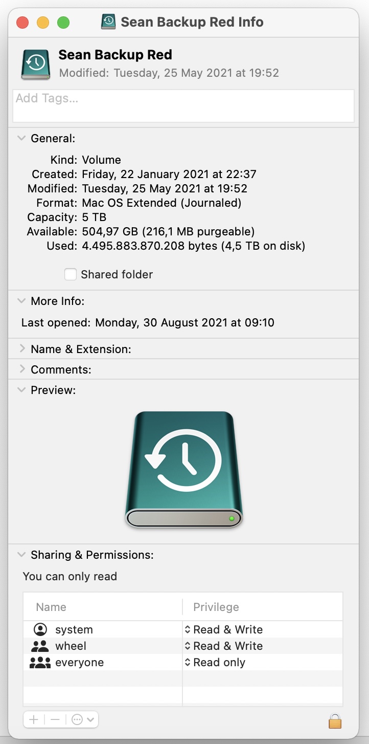

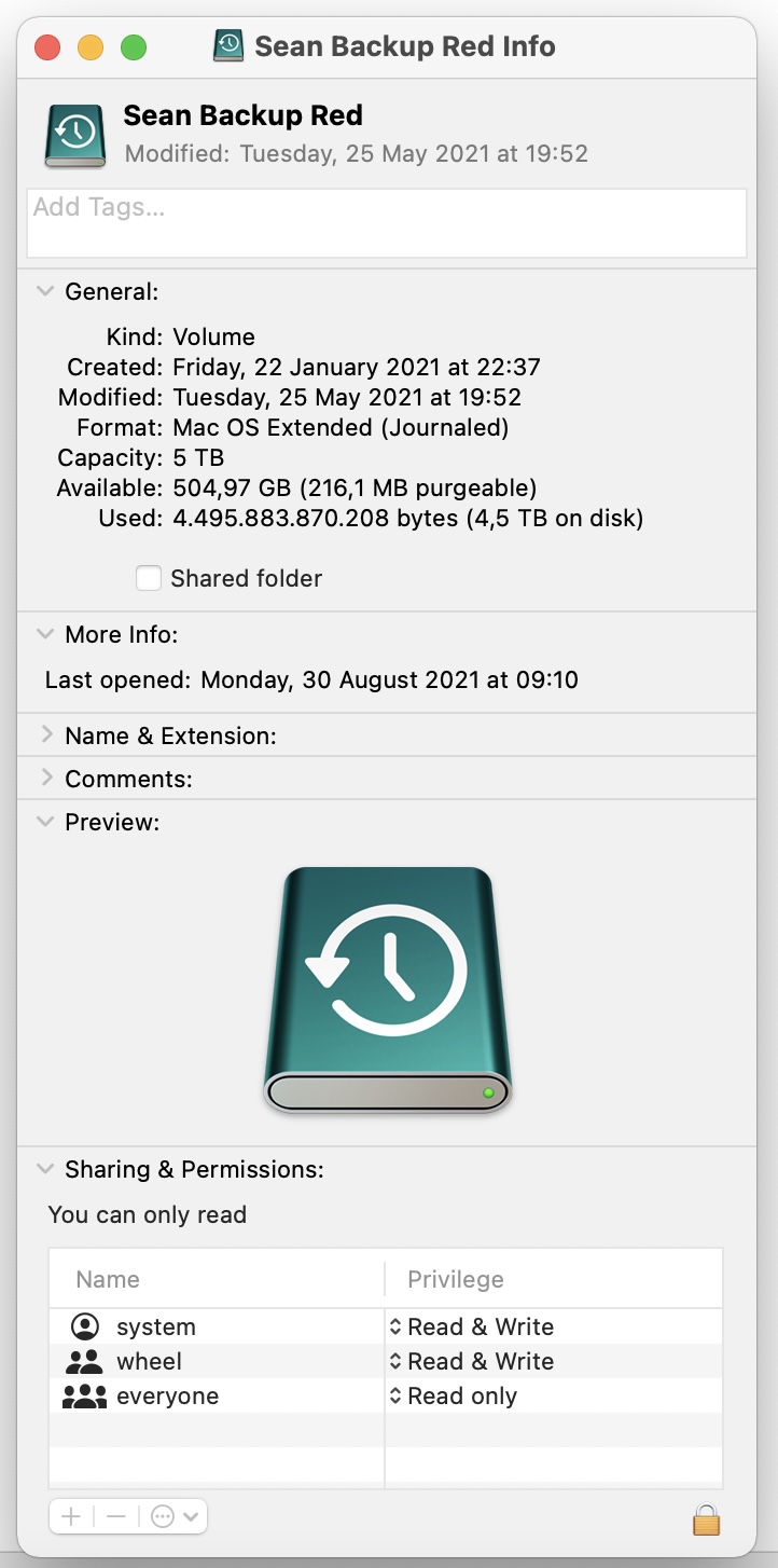

This is my Seagate 5TB HDD, format HFS+:

You know what, (when I was at home) I think I actually used my 2011 MBP running High Sierra to format the drive to HFS+, I then made a backup of that computer on that drive. I then took that drive, connected it to my brand new Big Sur M1 (never upgraded the OS on that), and made a backup of my new machine. The drive stayed HFS+.

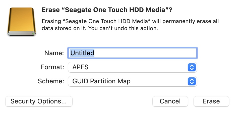

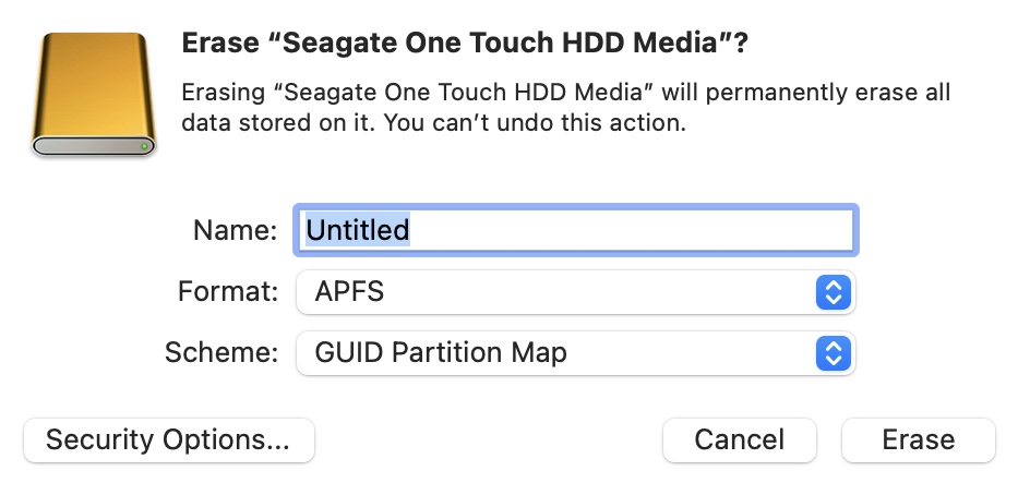

I just attempted to erase my current Time Machine Seagate HDD, with my Big Sur M1. It defaulted to APFS, and it would have formatted it to that, but there was a drop down menu that offered HFS+, and ExFAT etc. I fail to see how/why Time Machine would just switch that to APFS when, to be bluntly honest, it doesn't have to.
