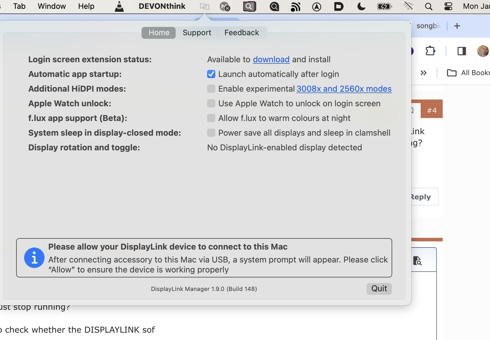

Hey, thanks! that may be it.
But why would it just stop running?
is there any way to check whether the DISPLAYLINK software is working? It is on my menu bar, so that must mean it's "on" - right?
thanks again for feedback!
w
