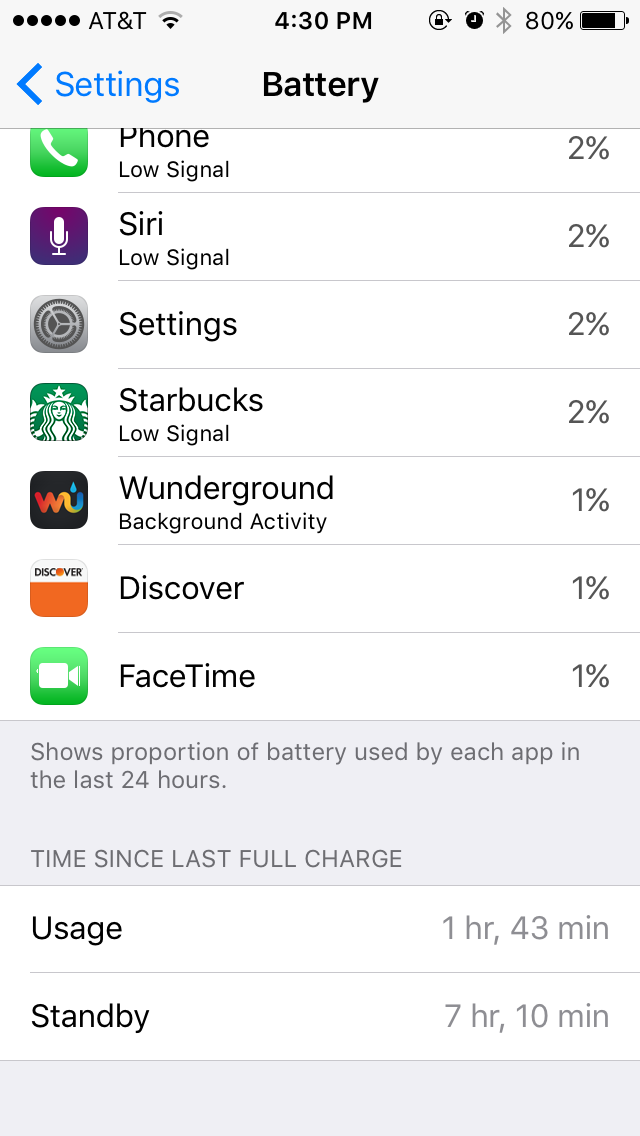

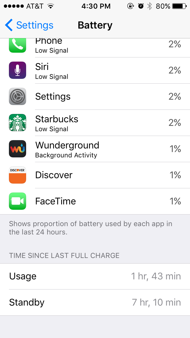

My phone didn't do this from iOS 7.0-9.0.2. Started on 9.1 for me.
That "something" will most likely not be iOS 9 (unless it is a relog of an online account of some kind). Check your usage and see.
I am familiar with iOS and battery usage. It was not showing any app that was being used in the background for nearly that long, and background app refresh was turned off. Again, this first occurred for me with 9.1.
Day one after a restore in iTunes and iTunes backup restore seems to be looking better. Time will tell.

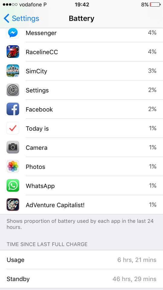

I started having issues after upgrading to 9.1. I have had my 6S for a few weeks now and never had any battery issues with iOS 9.0.2 (although I had the unable to wake bug few times and that was really nasty). The phone used to last for a whole day with a lot of usage. After update to 9.1 it started acting weird. One day it would last OK, the other day it will get slightly warmer and the battery would drain in a matter of hours. If I put in Low Power mode when at 20% it would somehow help. When I look at my battery stats, it seems the Safari has used more than half the battery. Well, I am mostly browsing indeed, but I am always browsing one and same stuff for one and same time and it's not normal for the phone to last whole day once, and only 1-2 hours next time. I usually leave it on the charger for the night and get it at the morning. Since 9.1 there are at least few times when the phone is at 100%, has not been used at all and is hot. Then it drains battery pretty fast. I usually restart it and that helped but not today. I have set it as a new phone when I bought it, so I don't want to reset it again since I have already gathered some health stats, etc. I am very disappointed in Apple lately. This is my third iPhone and I have been a loyal Apple user for the last 6 years however I am getting more and more frustrated and disappointed. I am really considering a switch to Android if the current trend of fixing one bug and introducing another continues. Besides, my iPad 3 has become so sluggish with each newer iOS that it is currently almost unusable.
