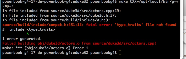

I need help, I found out that all my problems are centered on the imbecility of mac os x or macports, every time I try to make it, it looks for the damn gcc 4.2 instead of my newly compiled 7.5! I've already added variables and symlinks for 7.5, but every time I try to compile something, I get errors, and when I check the log, the compiler searched for stupid version 4.2 instead of 7.5.
I tried to compile eduke without luajit, but I got the error "'type_traits' file not found" which I believe is happening because the system is invoking version 4.2 instead of 7.5

if you're building manually you should be able to specify the compiler via make. this project uses cpp so make CXX=/path/to/gcc/7.5 etc

if the issue is the wrong gcc, see my earlier comment. you can select the compiler in the make command

I was not successful even using the command. When trying to compile, I get the error
I had some success specifying everything in detail to the compiler.
make CC=gcc-mp-7 CXX=g++-mp-7 LDFLAGS="-static-libgcc7 -static-libstdc++.6"

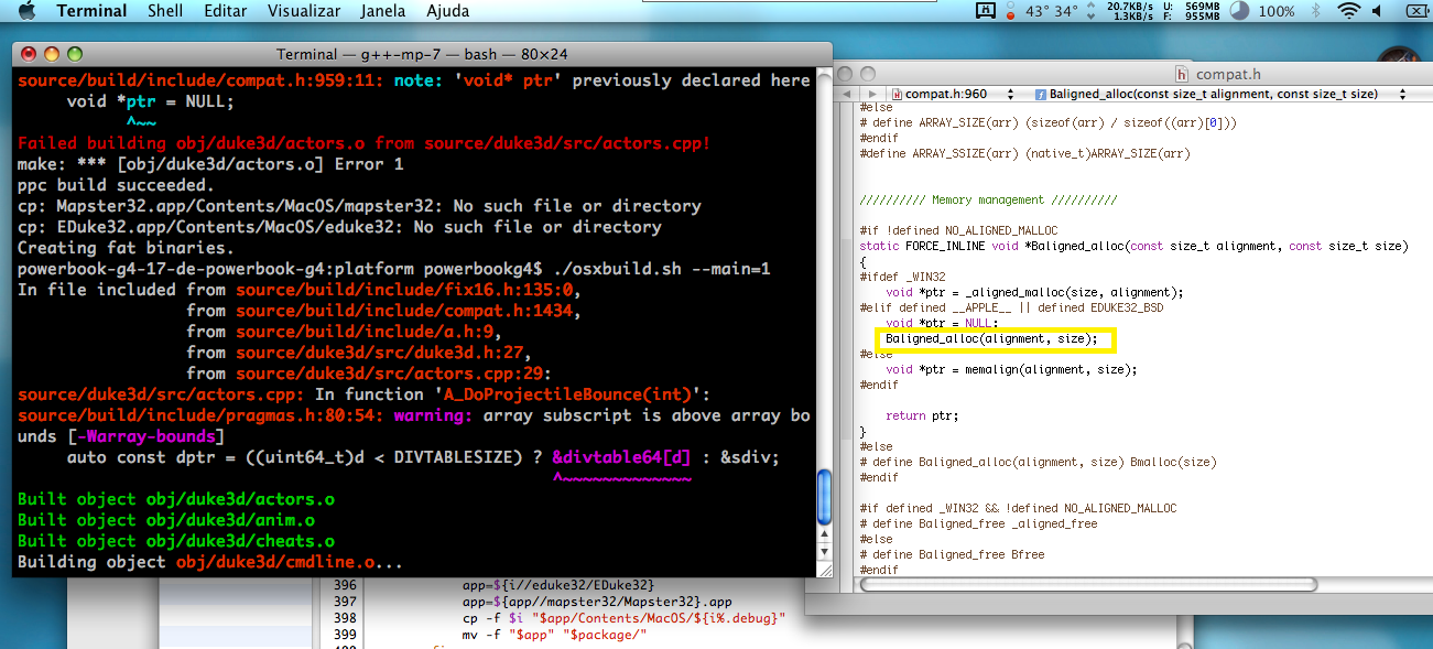

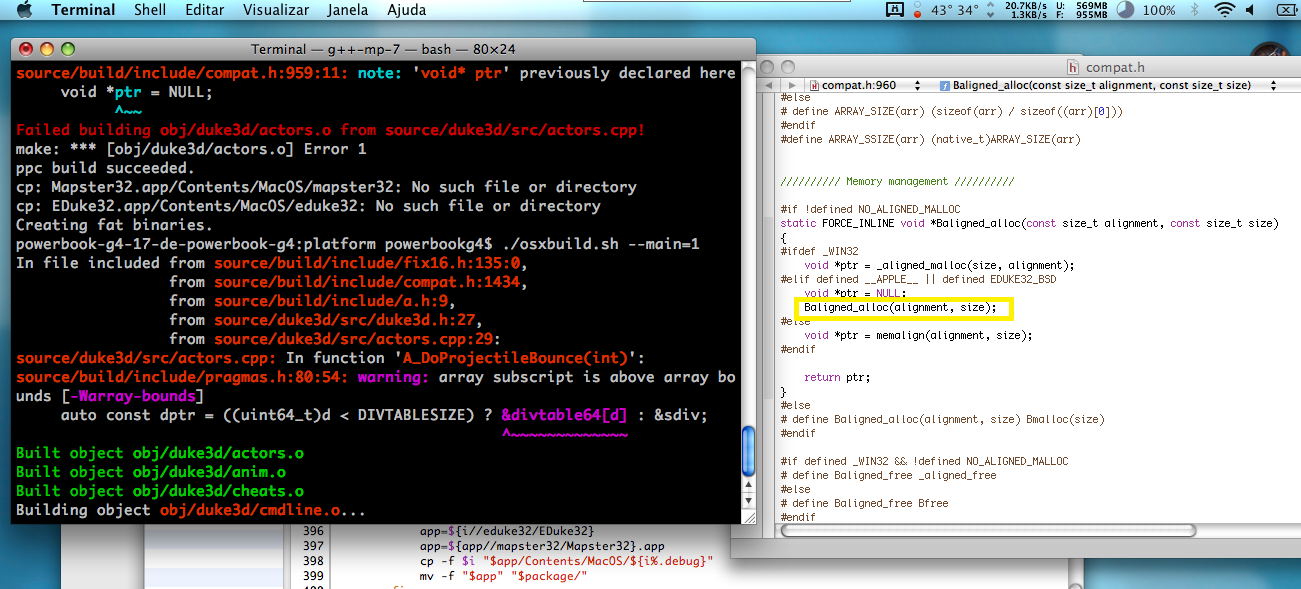

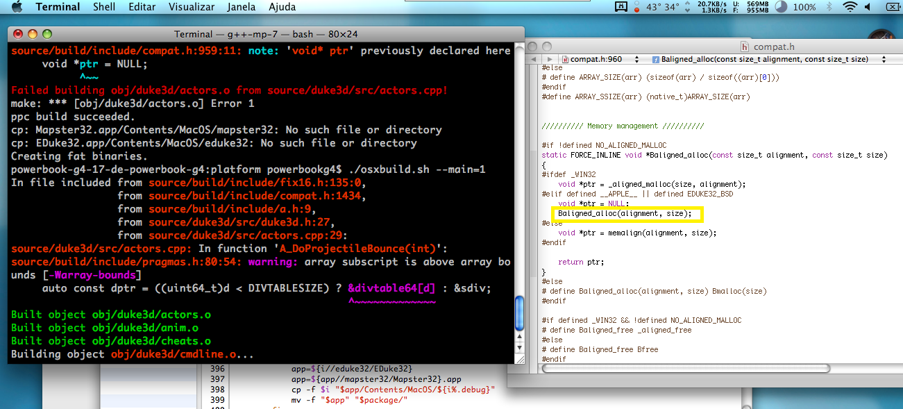

I had a problem with "compat.h" in the memory management section, I deleted the problematic line just to see if it was possible to compile the rest without problems. Currently building without problems, I will soon post the results
