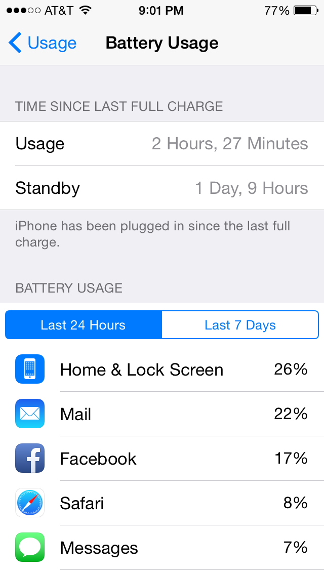

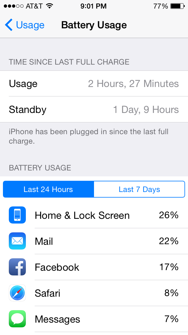

However....I decided not to change the password and I thought I would just see how my phone does for the weekend, and check out these stats in the screenshot attached (i know it says the phone has been plugged in but my 3 year old plugged it in for literally a minute).
So....I have not changed ANYTHING on the phone (including password) and the only difference in what i have done with the phone is that the phone has been on wifi rather than LTE for 'most' of the time.
I'm not sure if apple have fixed the glitch in iCloud over the past 3 days (thanks to jdvoracek's findings) but I would be interested to hear if anyone else has experienced any improvements?
Sat at 76% battery with 1 day 10 hours s'by and 2 hours 34 mins usage at the moment. Happy but perplexed........

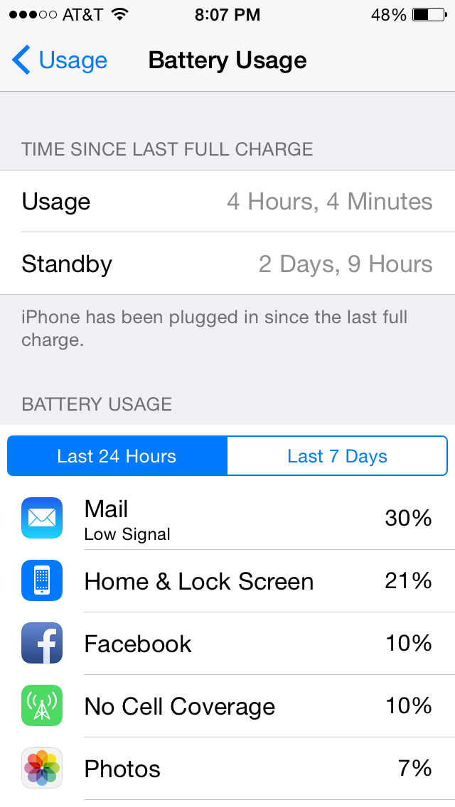

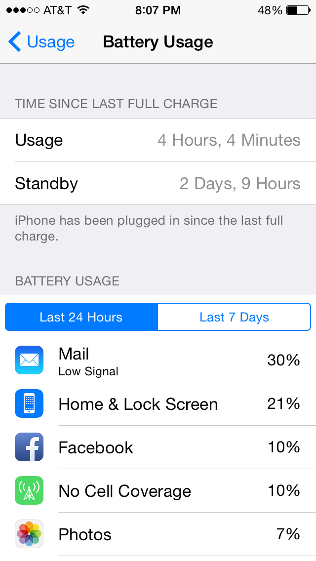

So here is my update after a day at work. The battery is definitely draining quicker on LTE than on wifi (as I would expect) but no where near what it was doing previously and well within specs.
See the attached screen shot. I have not plugged in the phone again (still just the 1 minute my 3 year old gave it). Note the 'No Cell Coverage' drain which actually dropped the battery by about 12% in 3 hours due to it being locked in a security box well away from cell reception. Considering this the results after almost 3 full days of use are staggering. I just wish I could tell you the 1 thing I did to produce these.
Still interested to hear if anyone else has seen a dramatic decrease in battery drain recently who previously had the iCloud issue.

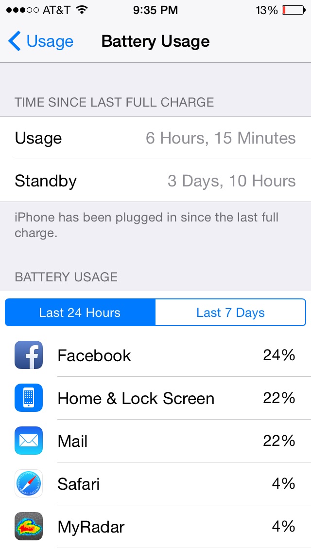

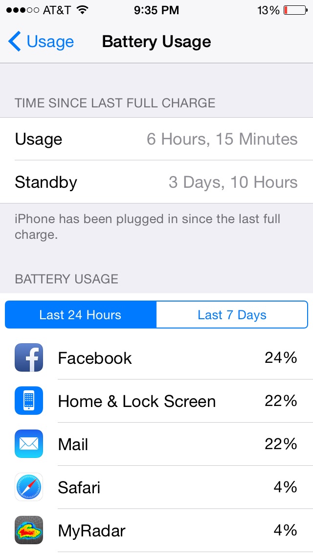

This is the final state of my battery before I had to plug it in. The best stats I've ever had out of it - but still without explanation....
