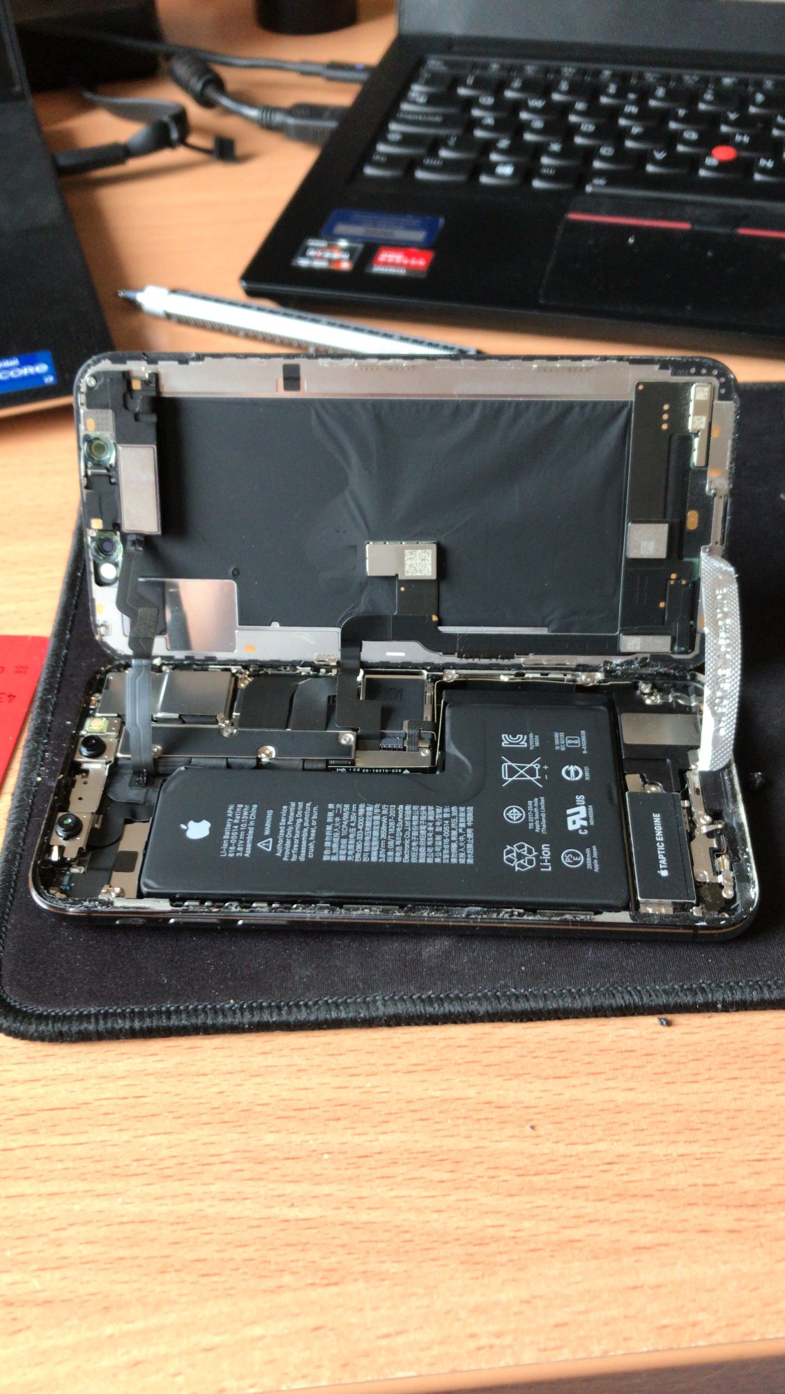

New to this, last night I’ve plugged my iPhone XS into a portable charger, all was well and it was charging away. 20 mins on the charger I’ve returned to find the phone has been bricked. Totally unresponsive. I’ve tried the volume up, down, lock button reset but nothing. After being on chat with apple there was no conclusive reason given for this.
I’ve decided I’m going to try and replace the battery to see if that is the culprit however on opening my phone I’ve noticed the back of the screen film looking bubbled (see photo).
2 questions:
1 does this issue sound like a possible battery problem? Could there be something else like a motherboard that could have caused this unresponsiveness?
2 does this bubbled screen film look concerning?
Many thanks

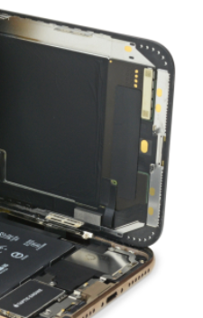

I think the screen bubbles could be normal (I found an image from an iFixit teardown, and there are bubbles in the top-right corner) . It is quite possible the charger could have caused damage to the logic board.

Ah, thank you for the image - I am guessing the logic board replacement is a little bit more concerning than just a battery?
Does replacing the logic board require the reprogramming of the phone and all that guff?
Thank you for your help!
