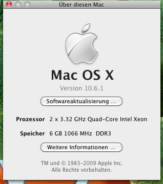

2 x 3.33GHz Nehalem Xeons with an SSD RAID 0.
The fastest Mac in history?

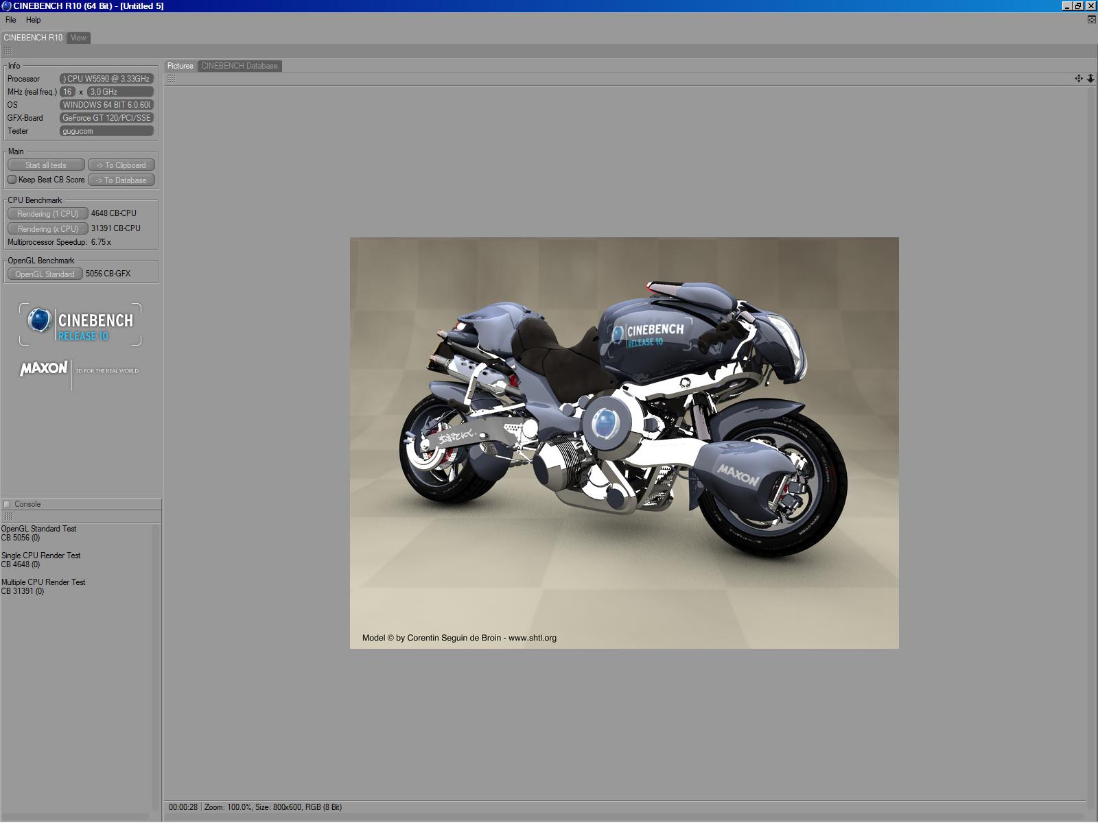

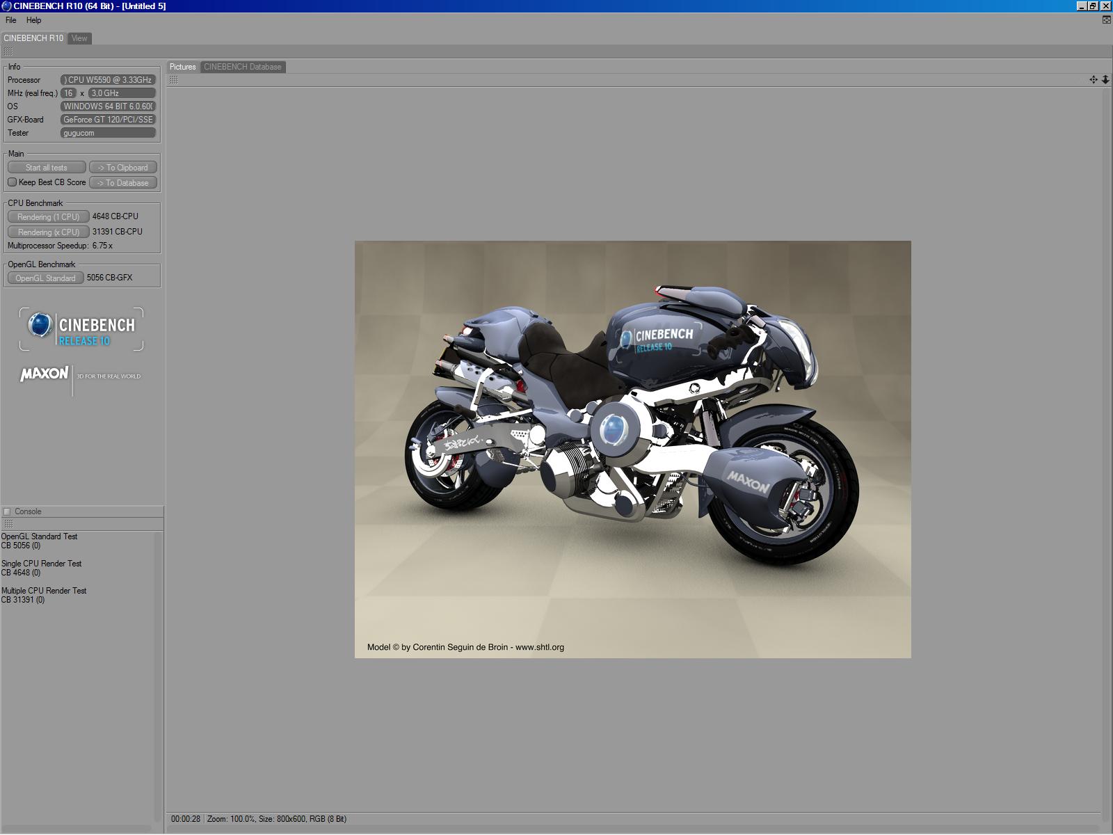

As usual the Vista64 Cinebench ist the best. This is currently with the GT120, 6GB RAM and 1 SSD, no RAID0.
But it is over 30.000, 😀

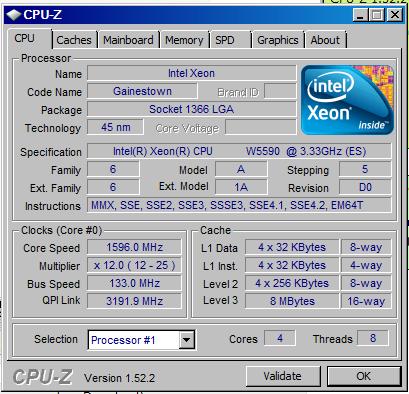

CPU-Z confirms the seller's word that this is a standard D0 stepping. So I guess there will not be a great potential for bad surprises.

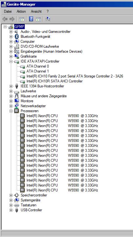

I just gained 50% multi CPU power compared to my 2006 Mac Pro. That machine has 20.780 with Vista64 Business. That was an X5365 Octad with 12 GB RAM and ATI3870.
It appears that there isn't a great deal of oompf between 3,33 and 3,2 GHz. But my system isn't completely done as I said. The Geekbench will have to come a bit later. I'm having a date tomorrow and need to prepare something.
