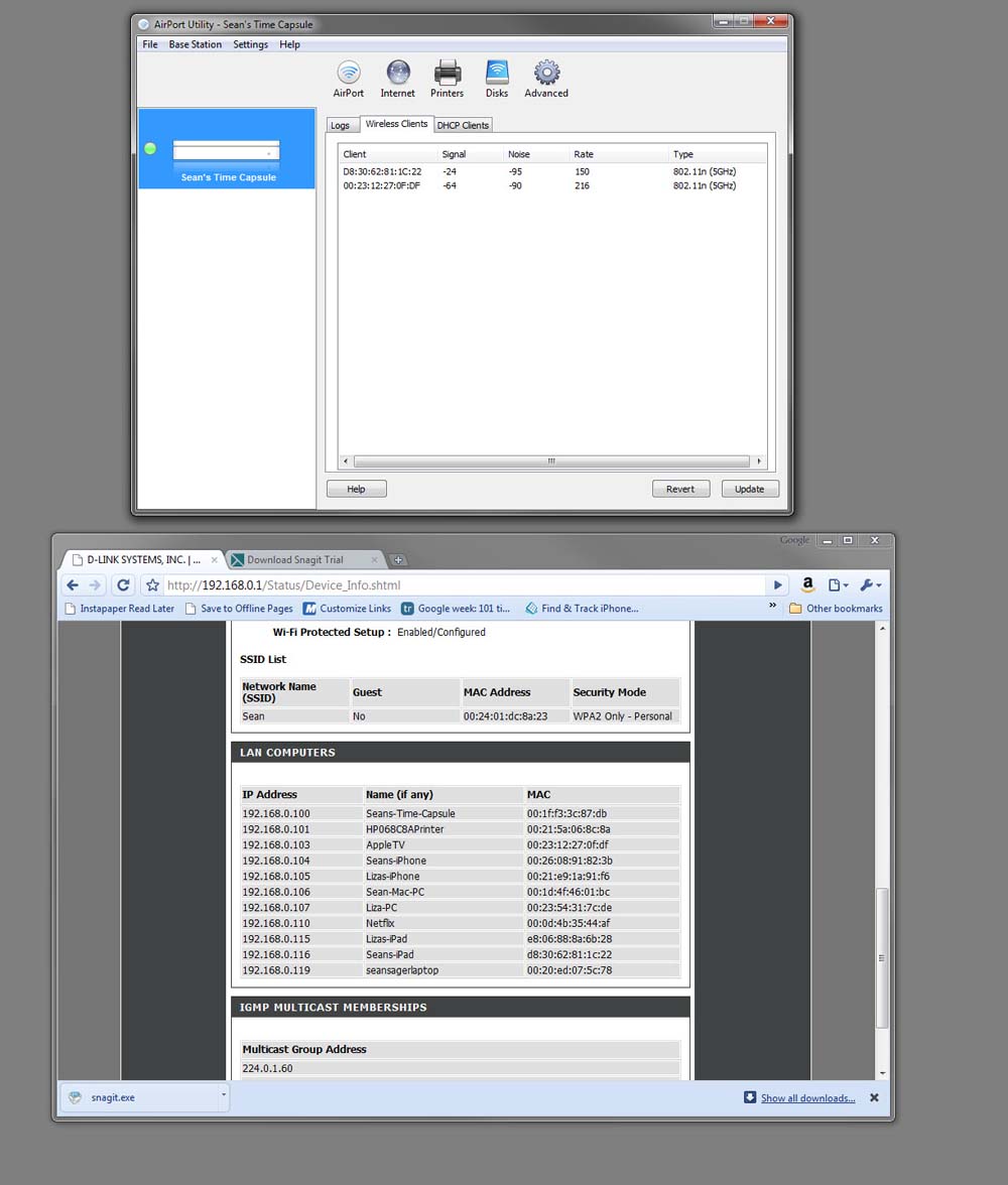

Here are my experiences with a early Time Capsule set to N 5ghz only, an apple TV, and an iPad 3G.
I also have a dlink router set up using G only for my iPhone 3GS. And I can alternate between networks to compare on the iPad.
Apple tv data rate:270 a few rooms away from router
iPad in same room as router: 150
iPad in different room with two walls between router/iPad: 120
iPad in bathroom where my iPhone 3GS has random disconnects from wifi using G: 120
Overall my iPad stays connected WAY farther from my routers than my iPhone and, in fact, have never experienced a disconnection with it on any network. It also has much higher data transfers from wireless N than from G from every location. From my testing there is no doubt in my mind that in my location (very saturated with other 2.5ghz networks, by the way) wireless N blows wireless G away in every way on my iPad.
You're getting 150mbit reported link speed from your Time Capsule to your iPad? What model TC is it, and what security settings are you running?
Yes I am getting 150 data rate with my iPad as reported by my Time Capsule. The model is a first gen. TC from 2008.
Security is set to WPA2 Personal. Time capsule firmware is 7.4.2.
As you can see from the screenshot, at this moment ipad is connected at 150, AppleTV is connected at 216.
I am not sure why the AppleTV has dropped so far from the 270 it was reporting before.
I use my Dlink 655 for DHCP serving and it serves all my other G devices, so that is what the other screen is for, to show that these are indeed my iPad and Apple TV.
